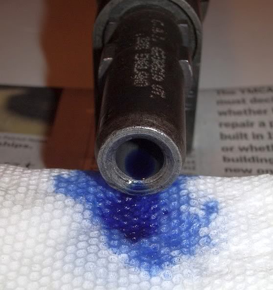

    Get some foam bore cleaner and let the foam do all your work for you, the U.S. Military now uses this from small arms to field pieces. You will not find a better way to clean any rifle bore of all copper.
