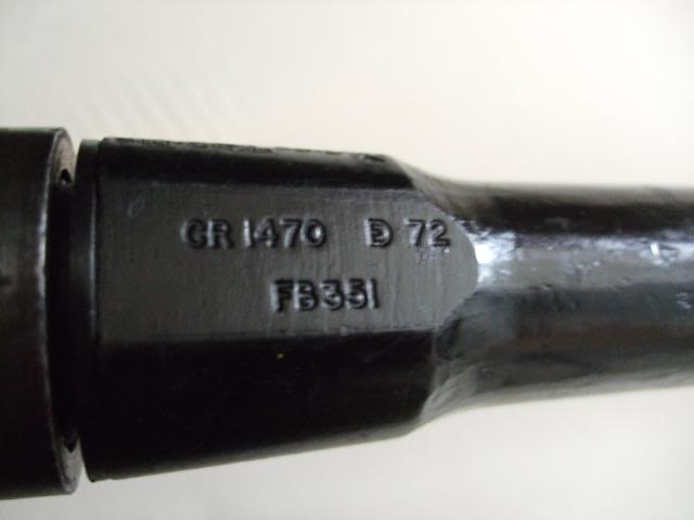

    Having a clear out and thought I,d post these pics of more numbers, first is a P14 barreled action, the other was on a No4 action

    According to the drawing DD(E)24720/SK/392 Issue 'O' the markings required were:-
    1. Manufacturer's Code Mark (The ED logo for RSAF Enfield)
    2. Year of Manufacture (Last 2 digits)
    3. Batch Mark (The steel producer, eg BB306)
    4. DD(E)24720/SK/392/O
    5. Flaw detection mark (A small triangle to denote that the barrel had passed crack detection, added after drawing issue 'O')
    Comments in brackets above are my own.
    DD(E) stands for Design Department (Enfield), SK for 'Sketch', and 392 is the 'parent number' which would have been applied to all of the drawings appertaining to the L39, L42, and Envoy 7.62mm conversions. The designer's drawings were subject to numerous minor revisions, denoted by issue in alphabetical order: that at 4 above being 'O'. The '392/K' subscript on the original barrel in the thread is no doubt because they ran out of room above! On later production barrels the part number, CR 1470 was marked instead.
    Not sure what 'BB' stands for; I believe that 'FB' is for 'Firth Brown'. The steel batch number is more usually stamped on the barrel in front of the knox form.
    The raised scimitar is of course the London Proof Mark and the '19 Tons' the Highest Mean Service Pressure measured by the obsolete Britishicon base copper crusher method.
    RSAF advertised and produced conversion barrels for No.4, P14, and Mauser 98 from 1969 into the 1970s, marketing them mainly through Fultons at Bisley. After a lull of several years a final batch of special 1 in 14 twist blanks was commissioned by Arthur Clarke: as in the advert above.

    I can't seem to recognise the BB xxx steel batch number on the commercial Enfield barrels. The FB mixer is the common one plus a few of the others that we had record of but BB is missing from my books. Any ideas Enfield Lock?
    Peter: After looking on the Internet I would hazard a guess that BB stands for 'Brown Bayley'. They were in business in Sheffield in the 1960s-70s, their Hecla works later being taken over by Hadfields who had much defence business. There is also a link with Harry Brearley, the inventor and developer of stainless steel and improved steel for gun barrels: he was manager of Brown Bayley 1914-1925. Prior to that he worked for Thomas Firth Ltd and John Brown Ltd.... who became Firth Brown!
