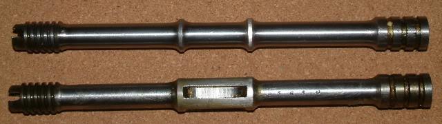

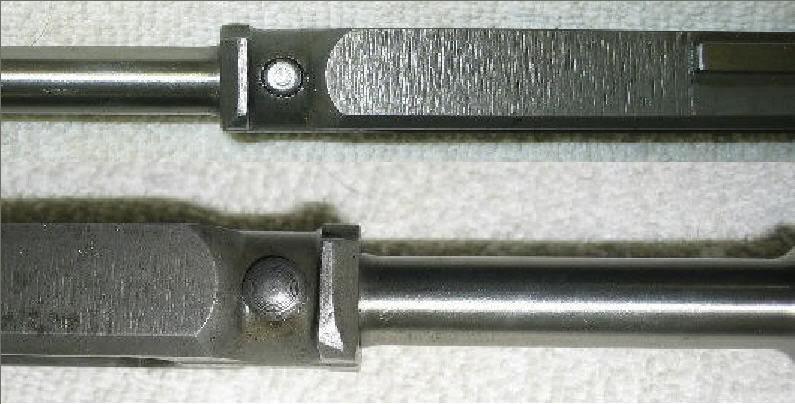

    pistons/piston extensions again
    As a matter of interest regarding the 7.92 'sterile' Brens marked - 7.92 BREN MKI and the difference in the piston and piston extension between these and all other types of .303 and 7.92 (CH & 0T prefix) Brens some further info.
    As mentioned earlier the piston location pin is further forward on the 'sterile' 7.92's on the very few that I have seen.
    As there may have been some doubt on this feature on these few guns I thought it prudent to check with the examples (accession number 19760332-092, serial number 1-0001 and accession number 19760332-054, serial number 2-3429) held by the Canadianicon War Museum.
    These were aquired by the CWM straight from Canadian Arsenals Limited so there provenance should be good.
    Both Brens have been inspected and they do indeed have the same piston and piston extension as per other 'sterile' 7.92 Brens with the piston location pin further forward.
    As the pistons and extensions are not threaded in these guns the location pin has to be further forward to mechinicaly join them.The location pin on all other types being at the bottom of the piston thread to arrest the possibility of the assembly becoming unscrewed.
    Apart from this being possibly the only item that could be simplified in the process of Bren production it would also require a smaller in length and larger diameter location pin.
    As no other Inglis Brens have this feature would it indicate these were the last Brens produced there ?
    Inglis were not allowed even the slightest variation from the drawing spec without specific Enfield/Ministry of Supply approval, even for the boxes, fittings and ancilliaries ets etc
    Is there any known record of this modification/alteration Peter and if so is it dated ?
    If the serial numbers on these guns are not random but run consecutivly in batch numbers of 9,999 is there room for 18,000 odd guns in between the known 0T and CH serial 7.92 guns in total WW2 production figures of 7.92's ?
    As they don't have any inspection or acceptance marks on them would they count anyway ?
    Appologies for so many questions but any thoughts , observations or further info much appreciated.
    ATB Kevin

    I read exactly what you say about the possibility that the 'mystery' 7.92mm Brens have a differently configured piston and piston interface connection. But a bit of history first......... For all you '....just-having-a-browse-while-I'm-here-Forumers, the piston extension is the whatsit thinggy that the breech block sits onto and the main piston screws into! The Mk1 piston extension and piston was apparently wasteful in manufacture because the lands between the piston rings of the Mk1 piston, (shown in the pic above) acted as what was described as a 'shutters' to the gas vents in the rounded part of the Mk1 gun gas cylinder. If you look carefully, you'll see that these lands block the openings of the gas escape or vent holes when the piston/breech block /piston extension is forward, effectively sealing that part of the gun from dust etc. Anyway, because of this, the male thread on the piston and female thread of the piston extension and the milled slot for the keeper/anti rotation pin (the subject of this discussion) were all index linked - or just indexed in engineering terms. This caused an intolerable amount of wastage according to the reports. Quite why is a bit of a mystery because once the machines have been properly set up for unskilled workers, it should be a doddle - but there you go. So a solution was found and out came the Mk2 piston without the lands or shutters. So with the Mk2 piston, it didn't matter where it screwed-in to, it bottomed out and was rotated back to align the holes and that was it. And if dust and debris/water got in, that was tough!
    The IMPORTANT thing that was paramount during this development was that there was to be no what we now call, 'mixed fleet' Mk1 and 2 pistons had to fully interchange and operate with the original off the shelf piston extensions. That was pretty much what happened when any parts were developed and as we all know and understand, that's what made the Bren such a reliable and versatile gun. Even parts from the newest Mk3 or modified Mk4 or earliest Mk1 would interchange if push came to shove. And because the Inglis Brens were all made for the UK Government vide the Ministry of Supply (Oh yes they were.........., the contract to manufacture at Enfield between ZB at Brunn specified this and was extended to Lithgowicon but not to SA where they wanted to manufacture them too.....) any variations were very tightly controlled.
    I'll give you an example. During a shortage of tubular brass rivets, one manufacture suggested that they could seal the end of the webbing Bren wallet straps by impregnating the ends with a plastic resin that would gel, set and prevent the ends fraying. Yet even this had to be submitted, tested, approved and sanctioned by the Ordnance Board - in the UK! And to utilise 400 or so bipod brackets that had been drilled slightly oversize, could they use oversize bolt shanks (not the thread.....) to save wastage and/or eliminate the need to bush them. Once again, it was approved BUT only on the condition that these bipods the legs were fixed permanently so that there was never a question of non interchangeability or a mixed fleet situation. You can see where I’m going can’t you………….?
    There is no doubt (? Or could there be….) that these mystery pistons and piston extensions were indeed made at Inglis but the details of such a modification don’t appear in the papers here. ON that basis, they remain a mystery. But of this you can be sure. If the idea had been submitted, it’d have been rejected sharpish as it would have immediately meant that there was a mixed fleet. I also wonder why Inglis per se would go it alone and even consider a push-fit piston/piston extension a viable modification so late on in the war when they’d already successfully manufactured hundreds of thousands of the up to now fully interchangeable ones! Anyway, in a roundabout way, those are my views and ideas. I don’t think that the position of the markings on a component matters as these were done, hand held, with a foot operated punch (no health and safety then chaps…..). As for quantities, well I haven’t got my records handy at the moment but we have about 4 different records of Inglis production including the contracted MoS figures and all seem to tie up reasonably well. Britainicon did take a quantity of the 7.92 guns because the MoS shipping records and some of the OT and CH serial numbers appear on the ex 7.92 breech blocks now fitted to early 7.62mm L4’s.

    [QUOTE=Peter Laidlericon;140494]I read exactly what you say about the possibility that the 'mystery' 7.92mm Brens have a differently configured piston and piston interface connection.
    <SNIP>
    <SNIP>
    .....any variations were very tightly controlled.
    <SNIP>
    There is no doubt (? Or could there be….) that these mystery pistons and piston extensions were indeed made at Inglis but the details of such a modification don’t appear in the papers here. ON that basis, they remain a mystery. But of this you can be sure. If the idea had been submitted, it’d have been rejected sharpish as it would have immediately meant that there was a mixed fleet. I also wonder why Inglis per se would go it alone and even consider a push-fit piston/piston extension a viable modification so late on in the war when they’d already successfully manufactured hundreds of thousands of the up to now fully interchangeable ones! Anyway, in a roundabout way, those are my views and ideas. I don’t think that the position of the markings on a component matters....
    <SNIP>
    As for quantities, well I haven’t got my records handy at the moment but we have about 4 different records of Inglis production including the contracted MoS figures and all seem to tie up reasonably well. <SNIP>QUOTE]
    Peter from what you have mentioned regarding autherisation for modifications is it more likely these were made post war ?
    Or 'B' post was for a country/end user that wasn't party to this agreement ?
    If the 'mystery'/'sterile' guns did run with consecutive serial numbers and Iglis production and MoS figures tie up reasonably well, is there gaps in known highest and lowest 0T and CH 7.92 serial numbers to allow for 18,000 plus 'mystery'/'sterile' guns ?
    If not would this also indicate they were not WW2 production ?
    Sorry for any confusion ,when you replied "I don’t think that the position of the markings on a component matters.... " I was refering to the point that the guns themselves do not have any inspection or acceptance marks on them.
    Clearly these Brens exist so it would be interesting to find out more infomation on them if anyone has anything to add.
    ATB Kevin
