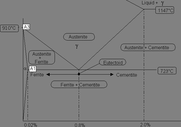

    @redleg:
    41XX series steels are far more than just 4130 and 4150. Additionally, "heat treat" is a very diverse term. You need to take a look at a phase diagram for steel alloys to see that most carbon steels, even CM, can be made to be almost as soft as low carbon steel, as hard as a file or as tough (hard surface, ductile core) as required - hence why a lot of firearm receivers are made of alloys like 4140.
    Here's a basic examples of a phase diagram for carbone steel:
    And here is a good read on what this diagram means in more or less layman's terms:
    http://www.gowelding.com/met/carbon.htm
    A "spark test" won't tell you anything useful. In engineering, a spark test is a specific conductivity test usuallyused to test the efficiency of insulative materials. To determine composition we usually use mass spectrometry if you are destructively testing, or for NDT, we would go to a material composition gun. Both these test aparatus are big dollars though - so you would normally use a lab and pay their fees accordingly.
    In any event, your observations about the nature of the parts themselves is not sufficient to change the hypothesis that CM=chromoly.
