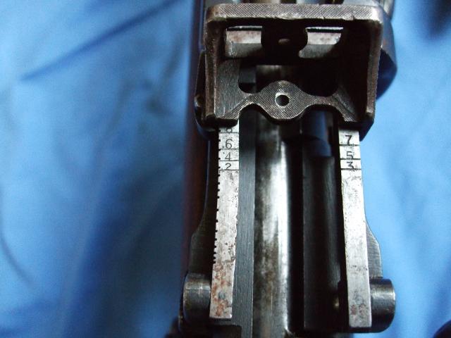

    Sorry buccaneer, but a Few more things not right, the rear sight is a repro and the screws should be flush, the safety is a repro or converted No1 mk 111, the " V " not correct, and the front band is a repro and the hole has been elongated. Its a still a Lot better than the one I returned last year.
    You can see the difference between the sight compared to this one I imported early on this year.
