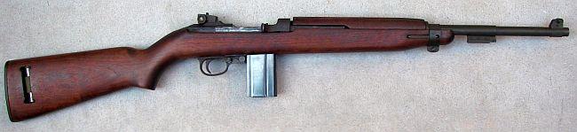

    Following are my personal observations relating to in-service carbine stock finishes for those who would like to have their carbines look exactly like they did when they were still in service.
    To the best of my recollection, the firing range use carbines at Lackland AFB, Yokota AB, George AFB and MacDill AFB in the 1950s/1960s had the typical original WWII as-issued style of finish: somewhat dull dark brown that resulted from their being finish sanded using relatively coarse (about 80 grit?) sandpaper and dipped in vats of raw linseed oilicon during manufacture, and thereafter maintained in the field by periodic application of raw linseed oilicon in accordance with the governing Manuals and Tech Orders. There were occasional very dark brown -- almost black -- stocks that I suspect resulted from overly zealous application of oil. I don't remember seeing any issue carbines with light brown or highly finished (shiny surface) stocks.
    Here is what I remember a typical 1950s/1960s USAF issue carbine looking like:
    Of course, Marksmanship Training/Qualification firing carbines underwent an enormous amount of use -- almost as much as in combat -- which meant they all had stocks with some dings, dents and scratches although -- as I believe is the case with all US Military issue firearms -- they were not abused and in general were well cared for.
