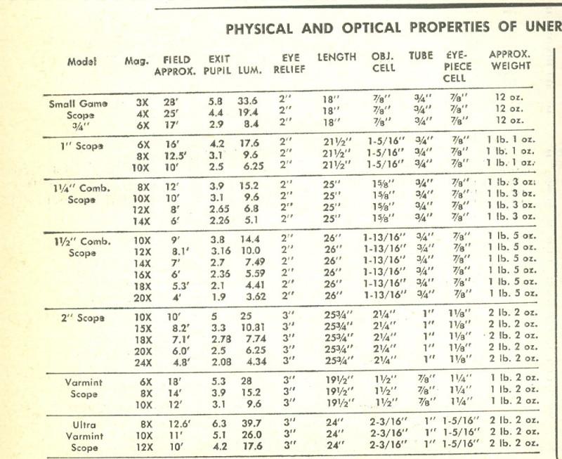

    For Informational purposes here is Unertl information taken directly from the 1964 "Shooter's Bible" the Stoger Arms catalog

    After further research, I find that I was incorrect. The Unertl scopes were available with reticules as follows:
    “The reticules offered are plain cross wires , fine , medium, medium coarse , and extra coarse; ditto with center dot; flat-top post with horizontal crosshair (best for offhand) a blunted post with horizontal crosshair and pointed post (picket) with cross wires. New scopes can be had with any of these cross wires.”
    `Interchangeable eyepieces to raise or lower power 35% are available for all but the Small-Game scope.
    “Medium-fine crosshairs are the only ones for target scopes. Unertl will even provide a crosshair and dot at no extra charge in his target scopes. As a target reticule, a enter dot is the best big game aiming point available. You can’t see the blasted dot against the bull, and you can’t see the bull behind the it!”
    These are direct quotes from one of the better known rifle shots and gunsmiths of the time.
    I do not ever recall seeing a dot reticule used on a target rifle. This does not mean that they did not exist.
