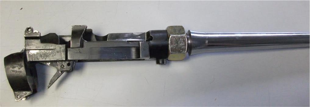

    If you take the bait and allow the ruckus to commence, I might have to finish the .300 Win Mag project that was started some time back during the last big outbreak of this silliness:
    A poor old No.4 action with a nickel plated M1917 barrel cobbled on. (the nut is for easy headspace adjustment- no front sight was required...)
