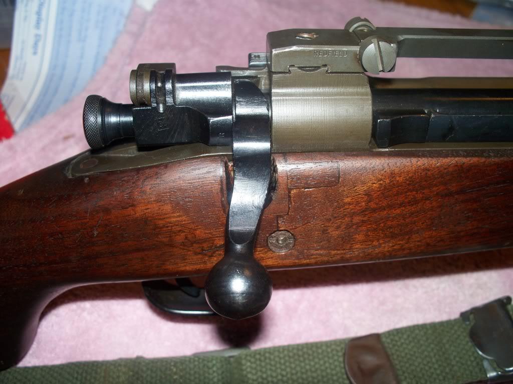

    I have an original bolt in my clone. In the first two photos you can see how much the bolt closes when it is locked all the way down. I notched the stock, myself, and it does not contact the bolt. The bolt is in excellent, original condition and headspaces great in this receiver/barrel. I have shot the rifle maybe 40 rounds.
    When I later learned that original A4 receivers were relieved where the bolt closes, I inspected. My bolt shows a very small mark where it contacts the receiver. Check out photo 3. I do plan to file this area to avoid further contact.
    I have a second original A4 bolt, that I will test also, and get back with you on that.
    It would be my guess, with manufacturing tolerances varying, some bolt/receiver combos would be OK without the milling, and some not. Instead of changing the bolt manufacturing process, the receiver milling was the easier solution. Mill 'em all and avoid any "possible" problems.
