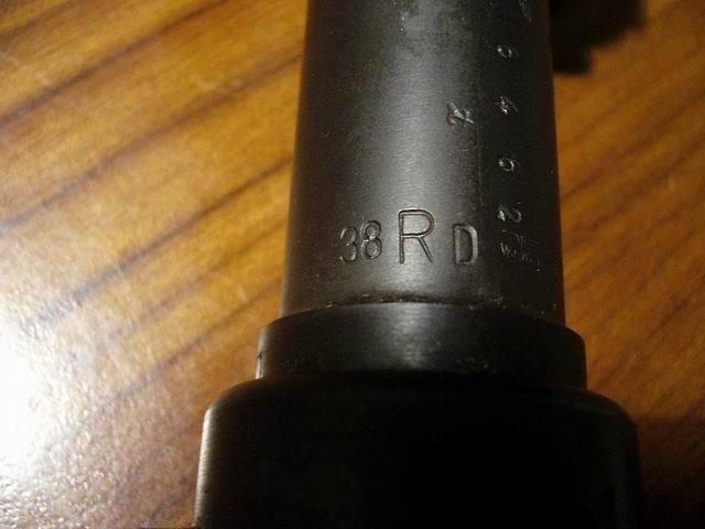

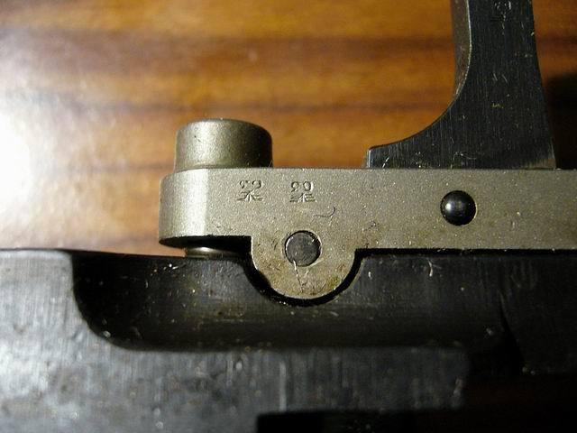

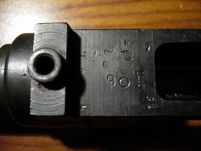

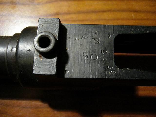

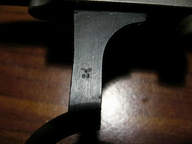

    Quote Originally Posted by WarPig1976 View Post
    WoW, so he admitted it.?
    No, the friend who sold me the rifle is in good faith and trust as well.
    I have posted same photos on Italianicon guns forum and someone realized that serial numbers are reprinted over old serials.
    Please check here the second "6", it has a "," which is what remains of previous serial.
    And here is the same story.

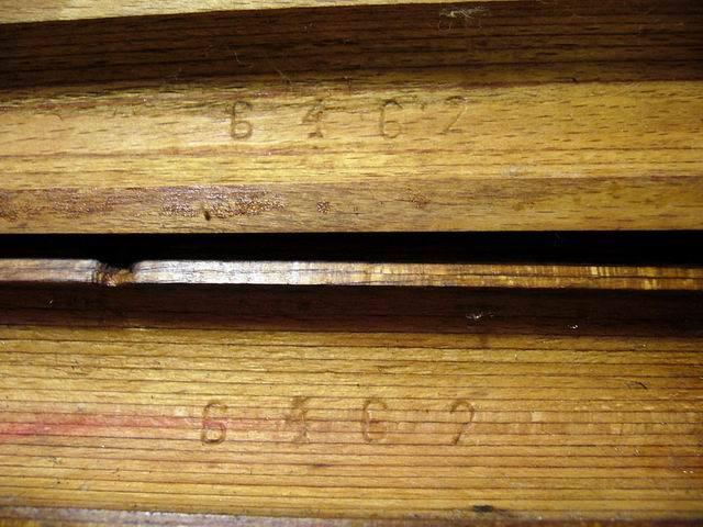

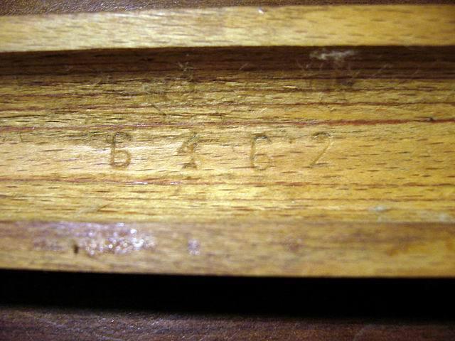

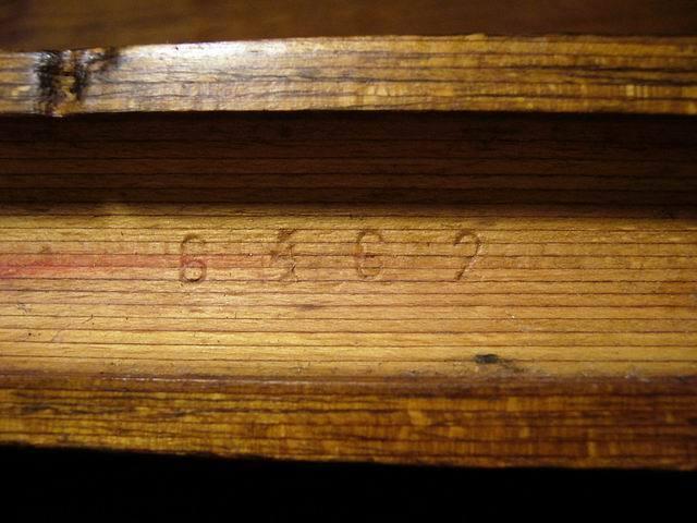

    The stock has be renumbered as well.
    I compared all photos with the Mauser K98icon owned by Badger and while his Mauser brings a wallnut stock and has Waffenamt all equale to WaW 63,
    mine has WaA 63, WaW 655 over the bolt group and WaA 412 over the bolt secure. It's a mix. Not worth the money I payd for it.
    Salu2 a to2
    Bizio

    Yup, after seeing your excellent close-up pics of the bolt face and shroud, I agree with Sarge13 that unfortunately, these have been scrubbed and renumbered ...
    Reduces value considerably ...

    IMHO it has really a very law value.
    I would prefer a rifle with a different numbered bolt but *original* rather than scrubbled and renumbered to make it matching.
    I will return the rifle and will be refunded without problems.

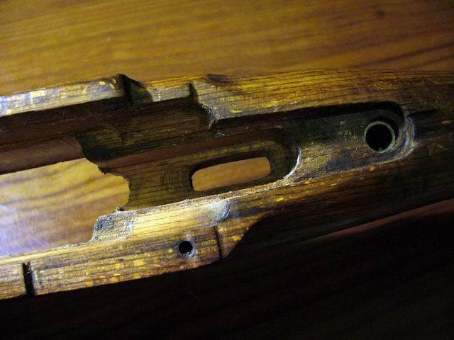

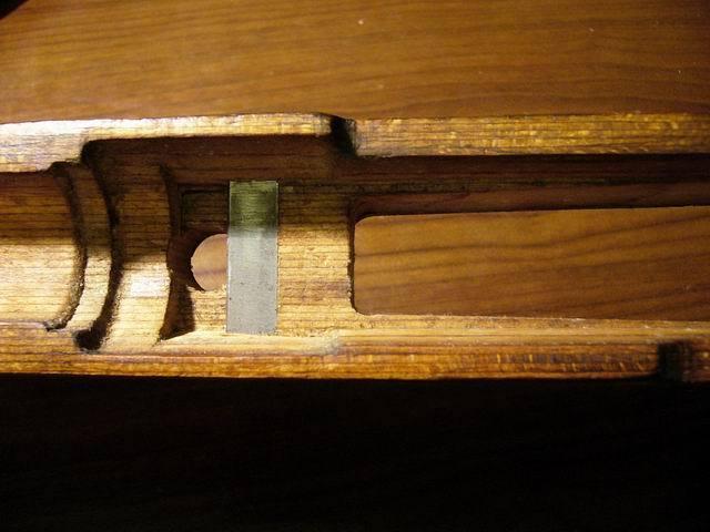

    Before returning the rifle I took some photos of the stock and of the parts hidden by the woods.
    Salu2 a to2
    Bizio

    I think the rifle is all original except for the bolt of course...
    I believe what's happened, as happened a lot with K98kicon's, is that the original bolt got separated from the rifle and whatever replacement bolt was used to make it operable, created a miss-match.
    So, some enterprising gun hustler decided to be creative and faked a matching real K98k bolt to "up" its value.
    Other than that, it's a really nice looking 1938 Oberndorf manufactured rifle ...

    I agree with you, Badger.
    In Italyicon the value of a mismatched Mauser K98icon is about 400-500 euro.
    The value of a fully matching Mauser K98 is about 1000-1200 euro.
    So whoever did the dirty job earned the difference between the two prices.

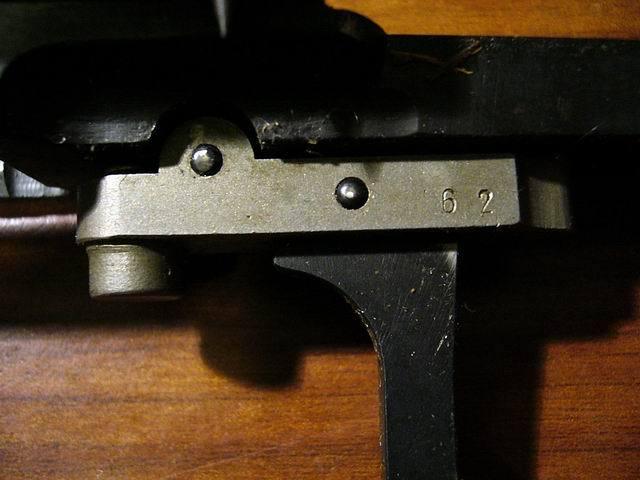

    ---------- Post added at 06:45 PM ---------- Previous post was at 06:40 PM ----------

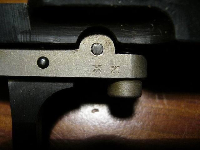

    Also the bolt catch lever is not original.
    It brings a different Waffenamt from the original WaA63 : WaA 214, same year but different manufacturer.
    Salu2 a to2
