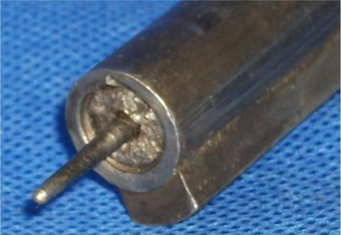

    If you correct (increase) striker protrusion by shortening the tail of the tenon, you alter, very slightly, the "arrangement" with the locking bolt, cocking piece and so forth. OK, it's just a few thou', but it happens.
    As for the front face of the bolt head: A couple of thou off there to increase to correct headspace is OK, as long as you remenber to check that the striker protrusion is still within limits. The striker hole hole IS TAPERED, in two "stages"; the very front part being a VERY slight taper, so a "bit off the front" of the bolt head is probably not going to make a huge difference to the diameter of the striker hole.
    Note that SMLE boltheads marked "M" are made from mild steel that has been surface-hardened by one of several arcane processes.
    UNMARKED bolt heads are made from "malleable cast iron", a different material and one that is apparently a LOT more prone to "over-hardening" than the "mild steel". It is also much more more prone to age related crystal growth.
    Particularly with the older metals, a combination of poor heat-treatment (over-cooking) and the passage of time itself, will lead to the granular-looking fractures as seen in the picture from jmoore.
    Poor heat-treament alone will cause even WW2 vintage No4 cocking pieces to simply snap, usually close to the half-cock notch, showing quite large crystals in the fracture zone.
    The cute thing with these actions is that, because of the helical locking, and the bolt head being threaded on, there is some tricky stuff going on as the bolt is travelling that last little bit. The helix on the locking shoulders is 1 turn in 0.10". The pitch of that weird 79 degree (and some odd minutes) bolt head thread is 20 TPI or 0.050". Thus, as the bolt handle is turning down, the entire assembly is moving forward. At the same time, the bolt head is being wound INTO the bolt body that "last little bit" and is thus moving BACKWARDS relative to the forward-moving bolt body.
