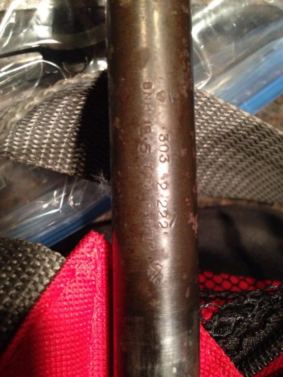

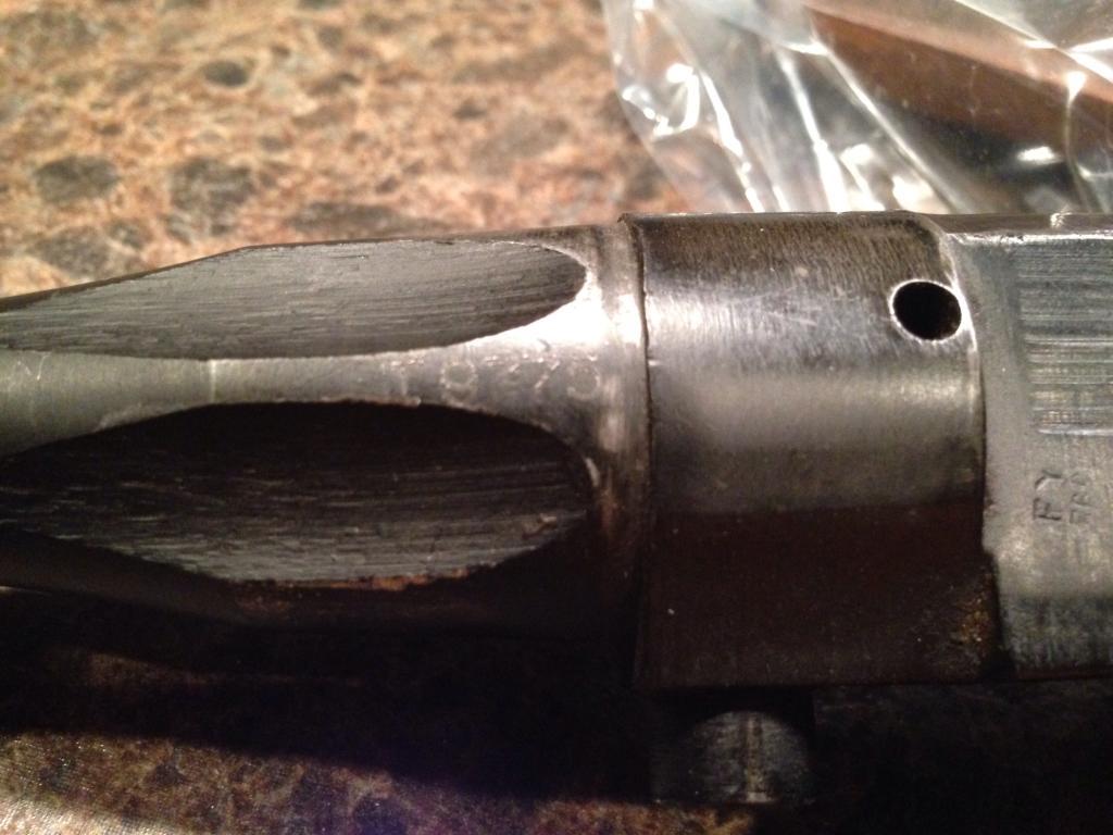

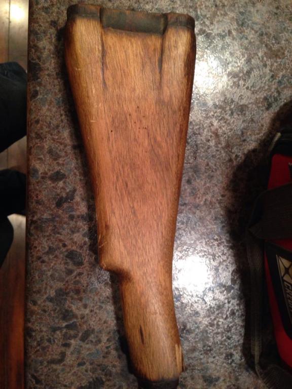

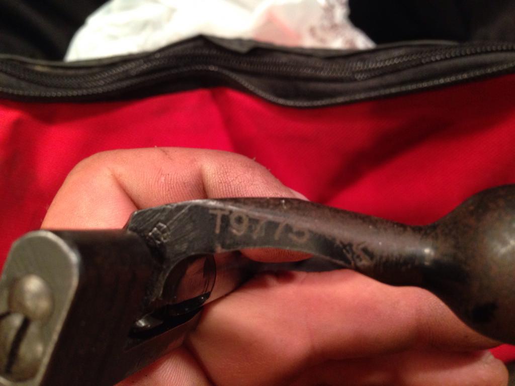

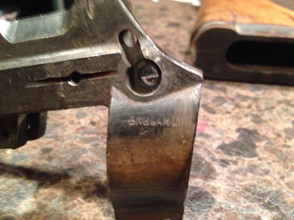

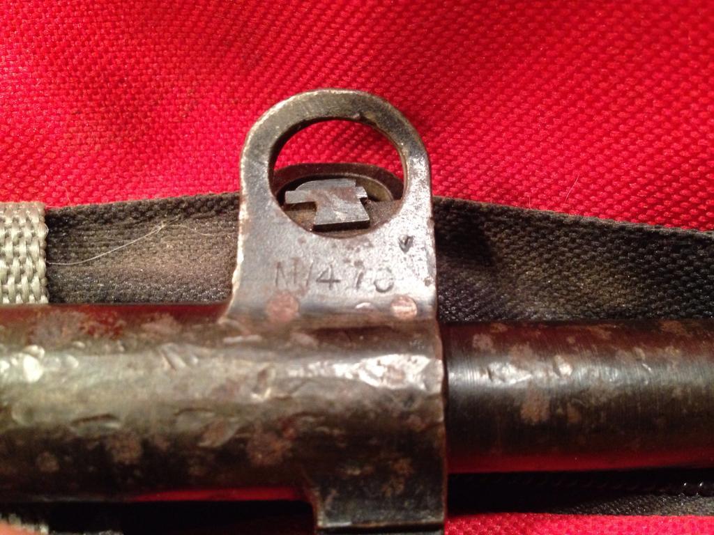

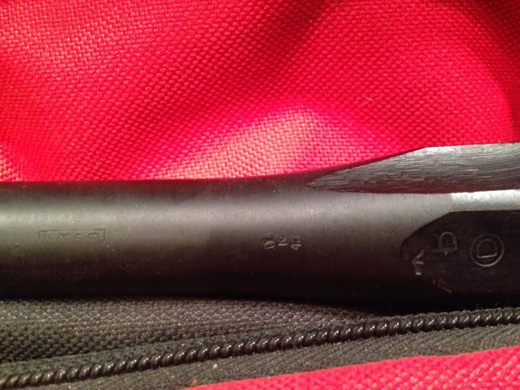

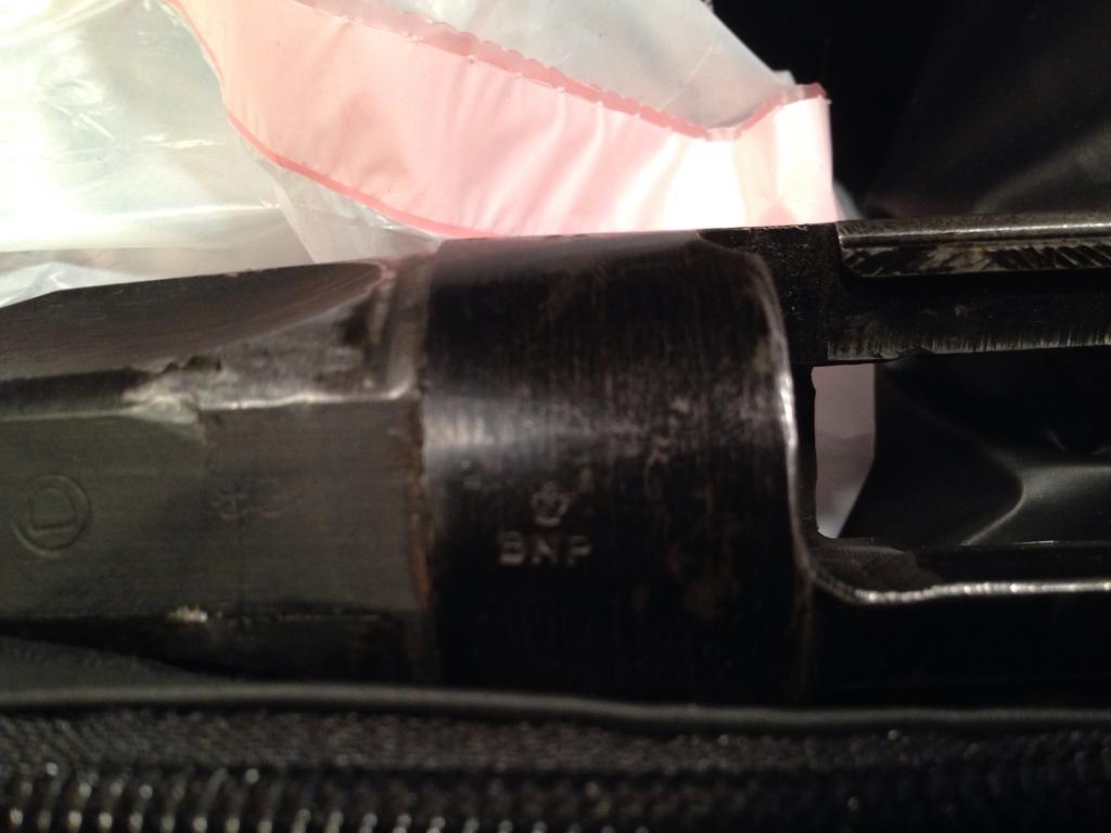

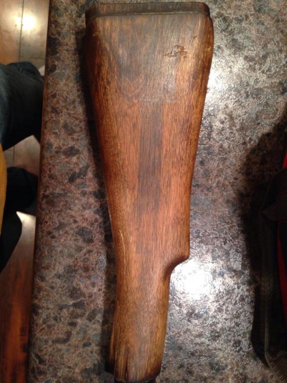

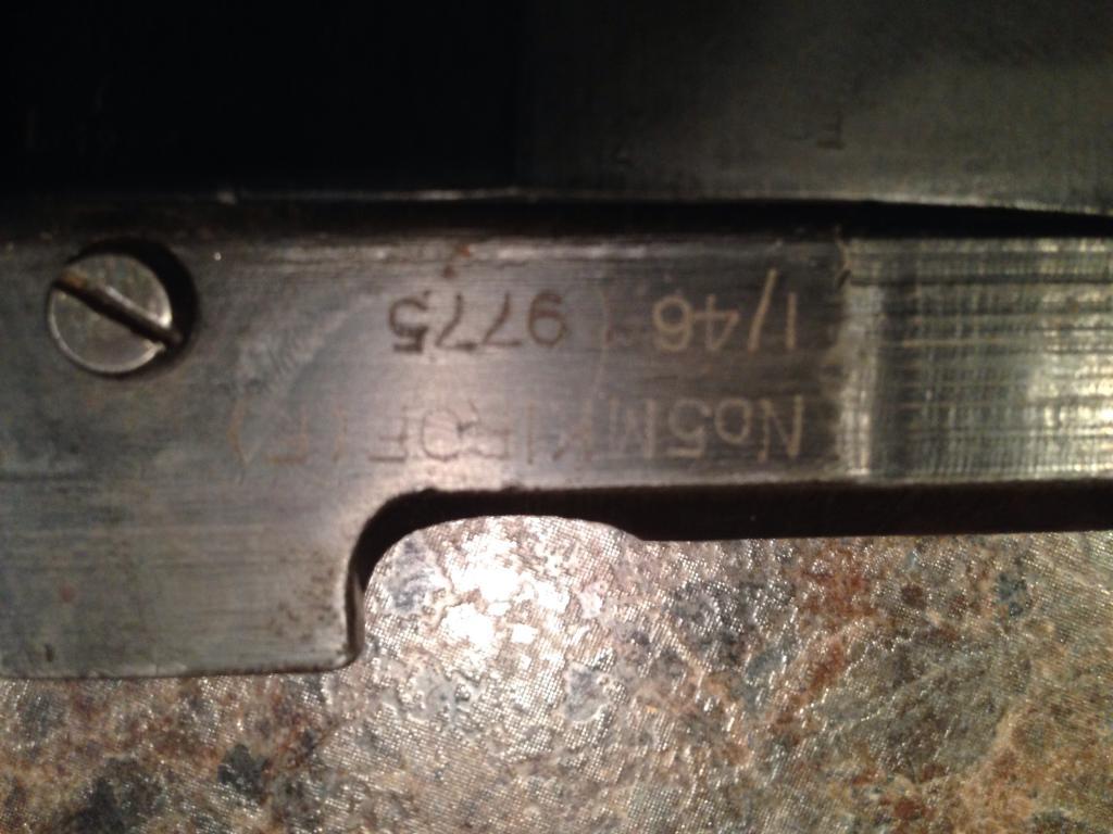

    No numbers on the stock but here is all the markings I can find
    ---------- Post added at 11:37 PM ---------- Previous post was at 11:29 PM ----------
    I have no intentions on selling it but don't wont to spend more then it is worth restoring it. I've got some one I'm confident in that says he can true it up so I'm going to let him have at it. He's done a lot of work for me he's my goto guy for all my metal and mill work. Figure I'm not out anything if It doesn't work it will hang on the wall. I think my goal for this rifle is to try to make it into a shooter. I like the aged looked and think I'm going to keep it the way it is.
