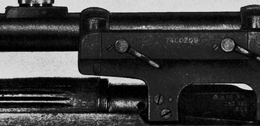

    Note the positioning of the original rifle serial number on the scope bracket.
    From the Canadianicon Army EME Manual Weapons C 500 p. 4 Issue 3 - 21 Apr 53
    Image and close-up of same photo enhanced to show the number a little better.
    Close-up examination shows that it is 74L0209 The full scope serial number is illegible in the photo. All I can read are the S and the /|\ that follows the SN.

    Quote Originally Posted by Seaforth72 View Post
    "Lee-Enfield" - I think you meant to write High of 74L0350.
    No, the lowest serial I have actually observed is 74L0000 and the highest is 74L0340 (held in my hot little hands...)
    http://photos.imageevent.com/badgerd...os/TP%2020.JPG
    looks like 209 might have lost it's rifle...or a very near relative
