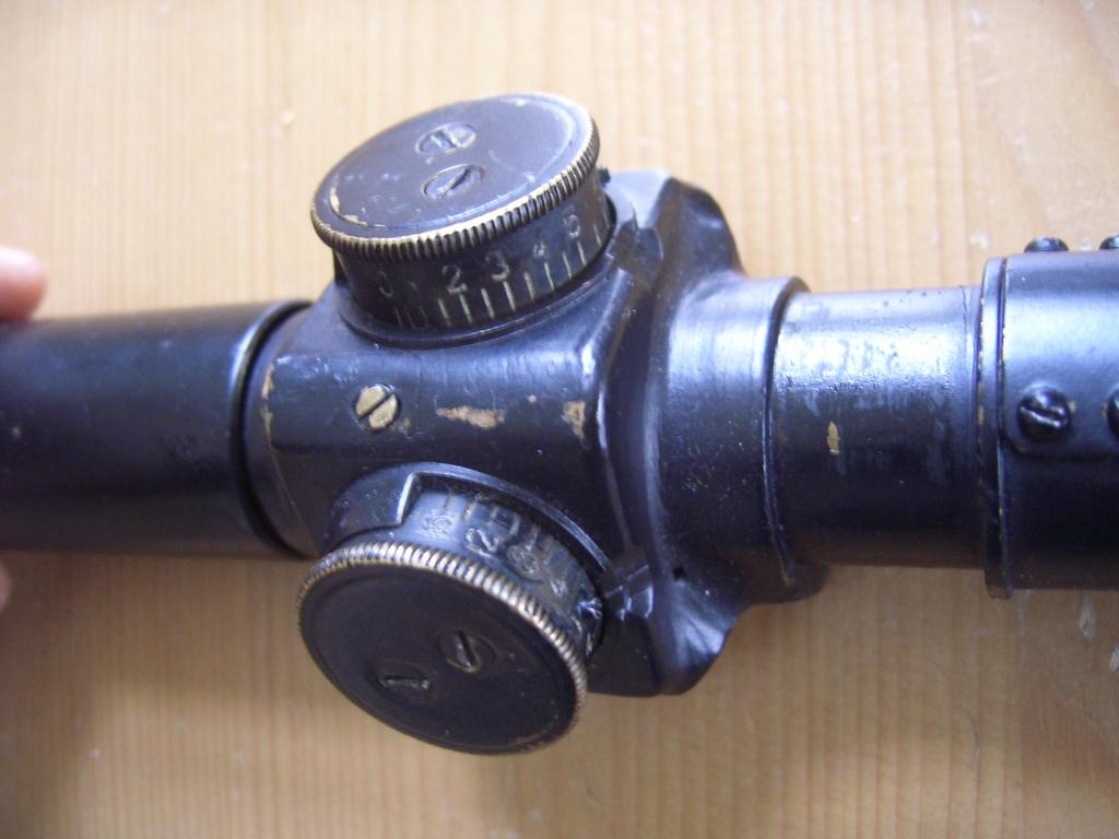

    I have to say that I think their method of zeroing the drums is a much better idea than both of ours. Taken straight from the typical pre-war telescopes. The drawback with such a method is that you have to give the soldier a screwdriver to do it. And when you give a squaddie a screwdriver.................................

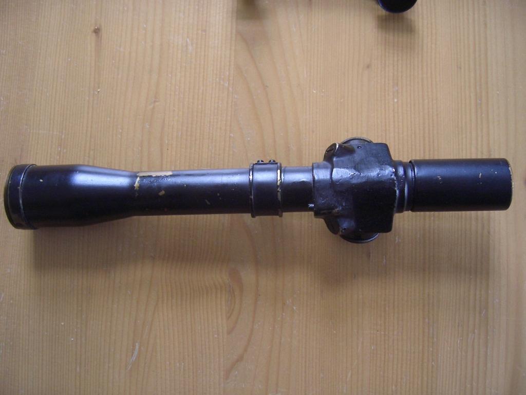

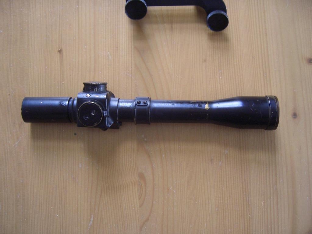

    Thanks for the pictures, really appreciate it. Starting to put a bit of data together, but with such a limited production run it is difficult to get much info.
    The screw lock slipping plate adjustment is a good idea as Peter mentioned, but again: Troopies with screwdrivers is a scary thought. That is what bayonets were invented for. The lenses are proving very interesting as is the reticule and the scope assembly. You need 7 thumbs to assemble the Israeli scope. I have one apart right now and interesting is an understatement.

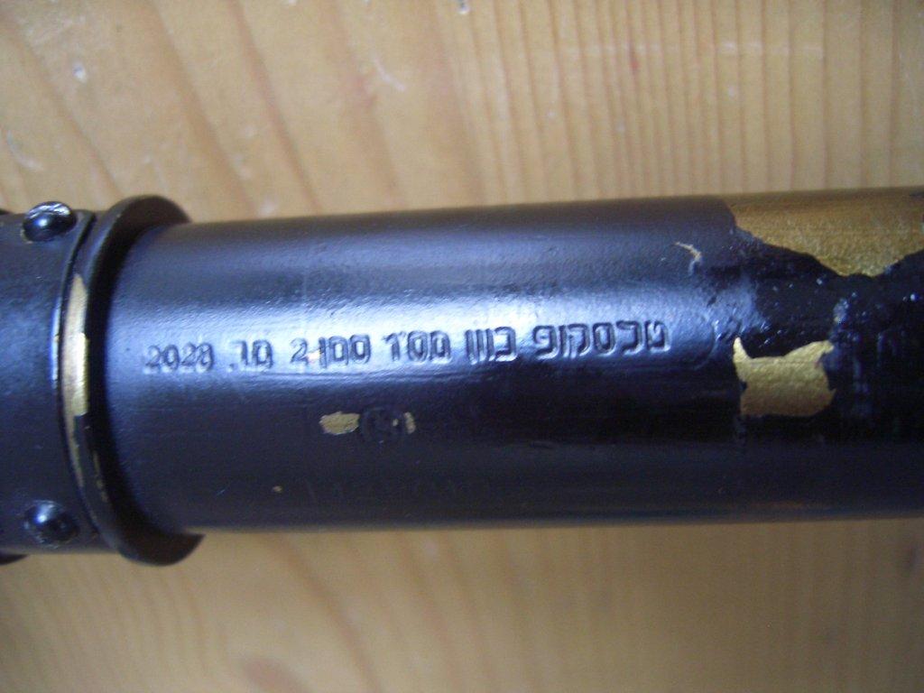

    from right to left:
    Directional telescope No. 1, Marker 2, [unknown abbreviation] 2028

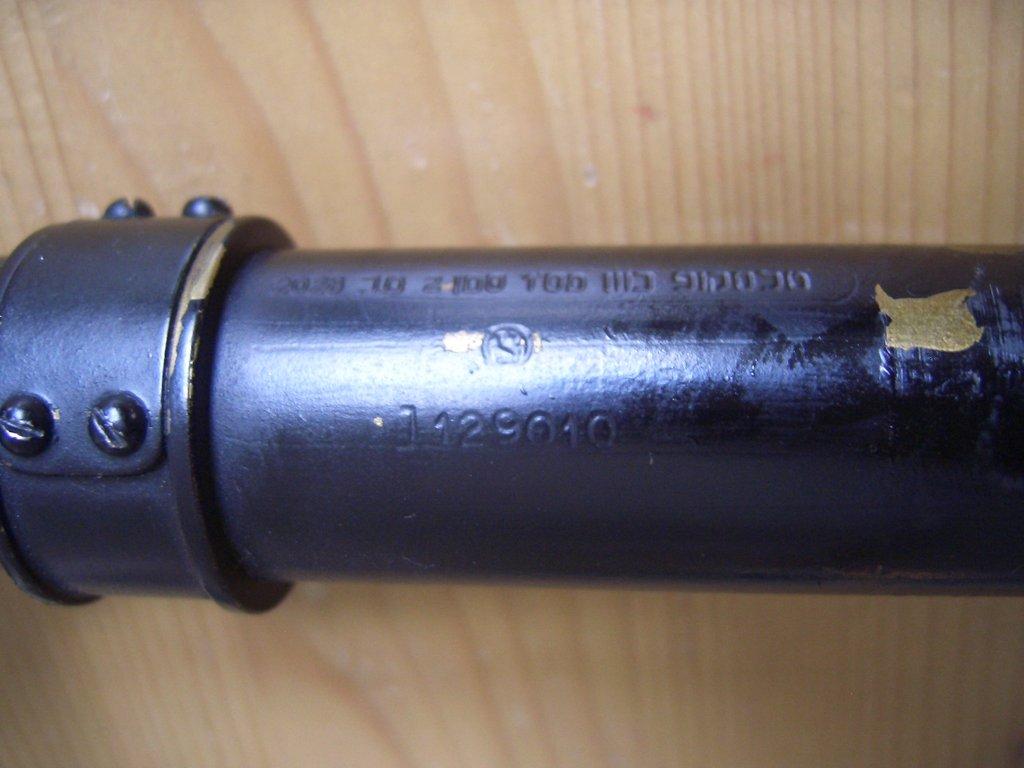

    Warren, I have a near complete one that is a bit differnt than the one I sent you. I will pull together the markings on it this weekend and then post them.

    A bit more accurately:
    TELESCOPE AIMING No.1 MARK2 CATALOG NUMBER 2028
    *The second letter of the last acronym for "Cat. No." is a bit blurry.
