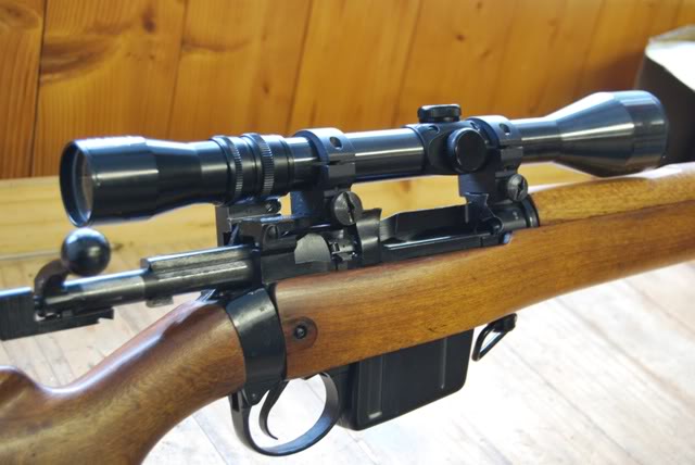

    Enfield Enforcer's had the 4-10 Pecar Model V2 - S Telescope. Here is its Technical Data
    Length 355 mm
    Weight 455 gm
    Magnification Variable - 4X to 10X
    Field of View at 100 metres 4x - 31 ft
    6x - 24 ft
    8x - 18 ft
    10x - 16 ft
    Object Glass diameter 50 mm
    Eye relief 80 mm
    Reticule Interchangeable - 16 patterns available.
    It was only fitted to Police Enforcer's not military rifles. I dont belive it was ever used for military as its probably not robust enough for dragging it into battle.L39 and L42's didnt have them. As to value there is one for sale on the internet today for...........wait for it .................£600 in good condition and one much older and been used well for £400. I can tell you its one of the best scopes made. Mine is superb. Quite a rare scope far harder to get then a No.32
    For more info speak to
    Alan De Enfield, he really knows his stuff about Enforcer's, also see his posts about Enfield Enforcer's
    A good web site, the only web site about Pecar's is
    Eagle Hurst Sporting | Pecar Berlin
    Also see
    index.htm
    Web site on Enforcers/scopes but a bit out of date now.
    Hope this helps !! Neal

    Alan De Enfield
    05-11-2025
    04:50 AM
    Quote Originally Posted by read6737 View Post
    I have found out that they were for the Enforcers designed for the
    police in the uk.
    does any one have pics, info?
    West side
    5,023
    05-10-2025
    08:50 PM
    Pecar was a mid-range Germanicon scope. According to the documents posted on a site about Enforcers that I cannot now recall the name of, it was the only scope considered - in other words there was no evaluation or selection process - it was chosen because Parker Hale had the agency for Pecar in the UKicon. Simple as that.
    Interesting that the AJ Parker Matchmaker foresight has been removed in the photo above. The user didn't like the 'shadow' in his FOV apparently!
