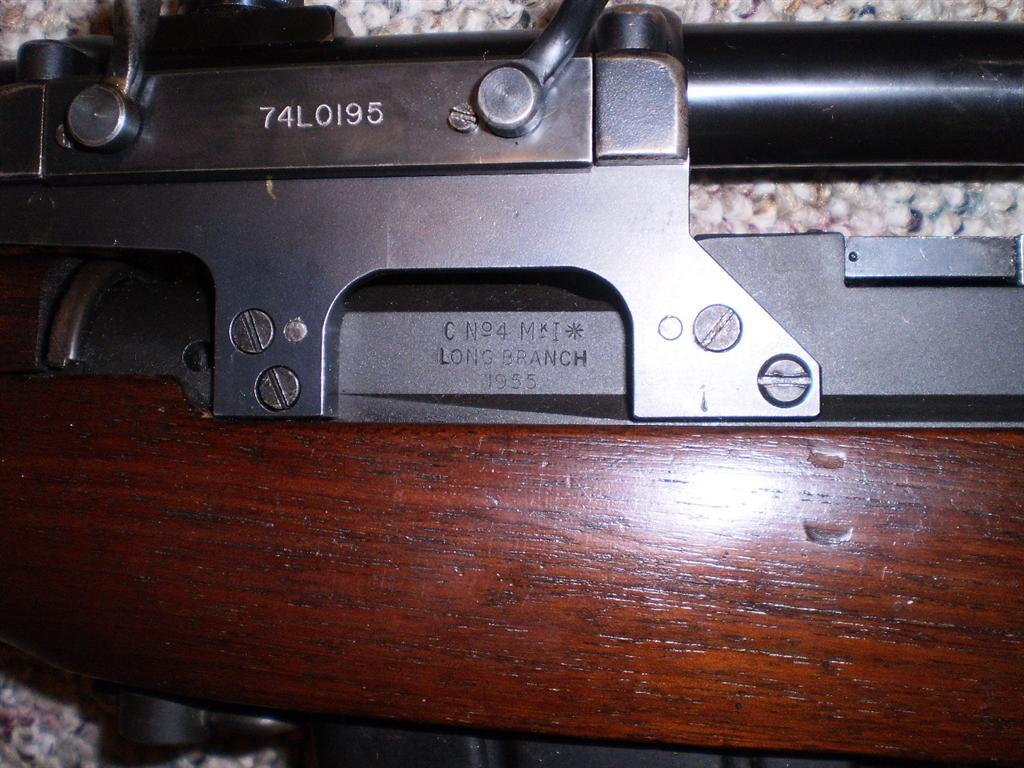

    Quote Originally Posted by Lee Enfield View Post
    No, the lowest serial I have actually observed is 74L0000 and the highest is 74L0340 (held in my hot little hands...)
    http://photos.imageevent.com/badgerd...os/TP%2020.JPG
    looks like 209 might have lost it's rifle...or a very near relative
    Yes it looks like scope and bracket 74L0209 which was pictured in the EME manual has become detached from its rifle.

    Re thread 22. Scope on bracket 0209 detached or lost from the rifle! How do you arrive at this? Has it turned up somewhere? Have I missed something in the telling?

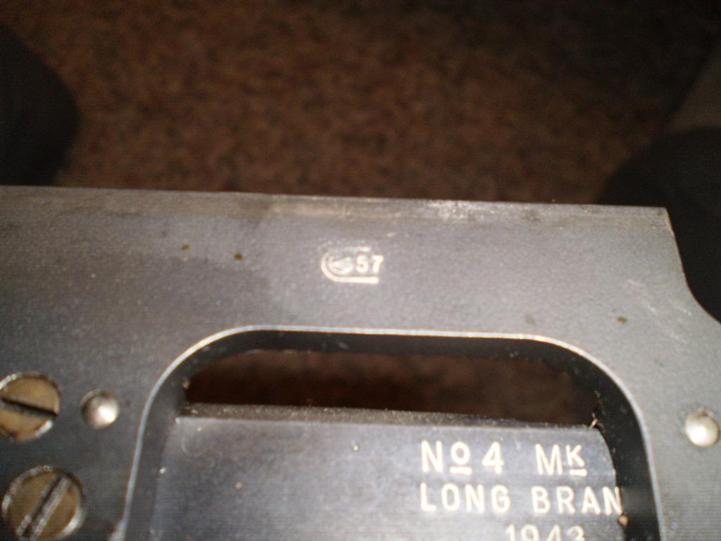

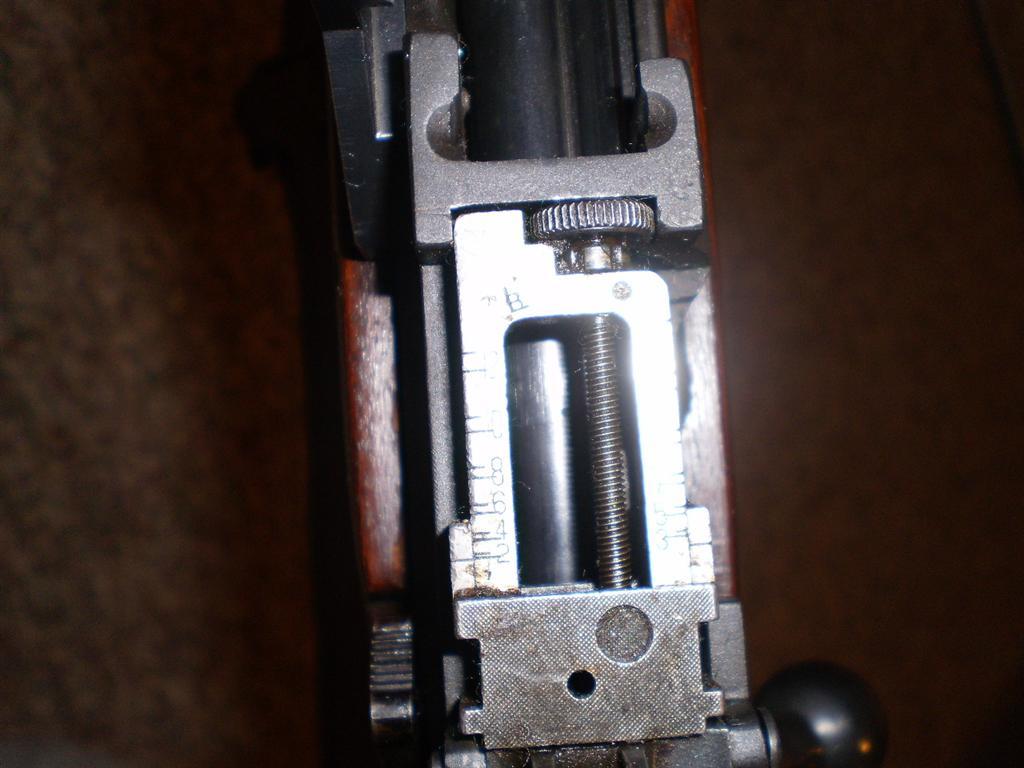

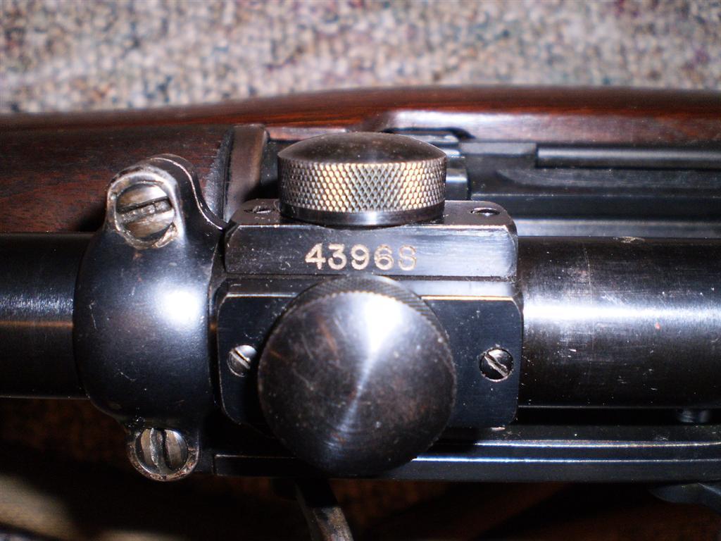

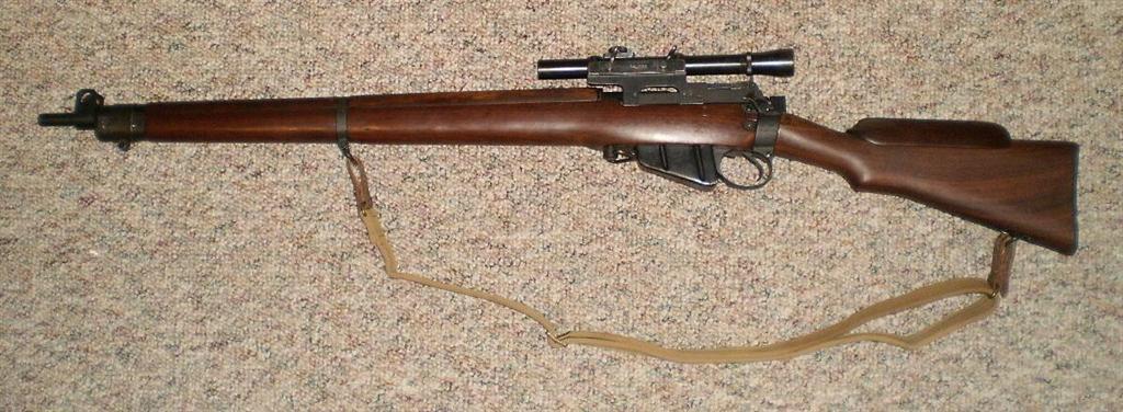

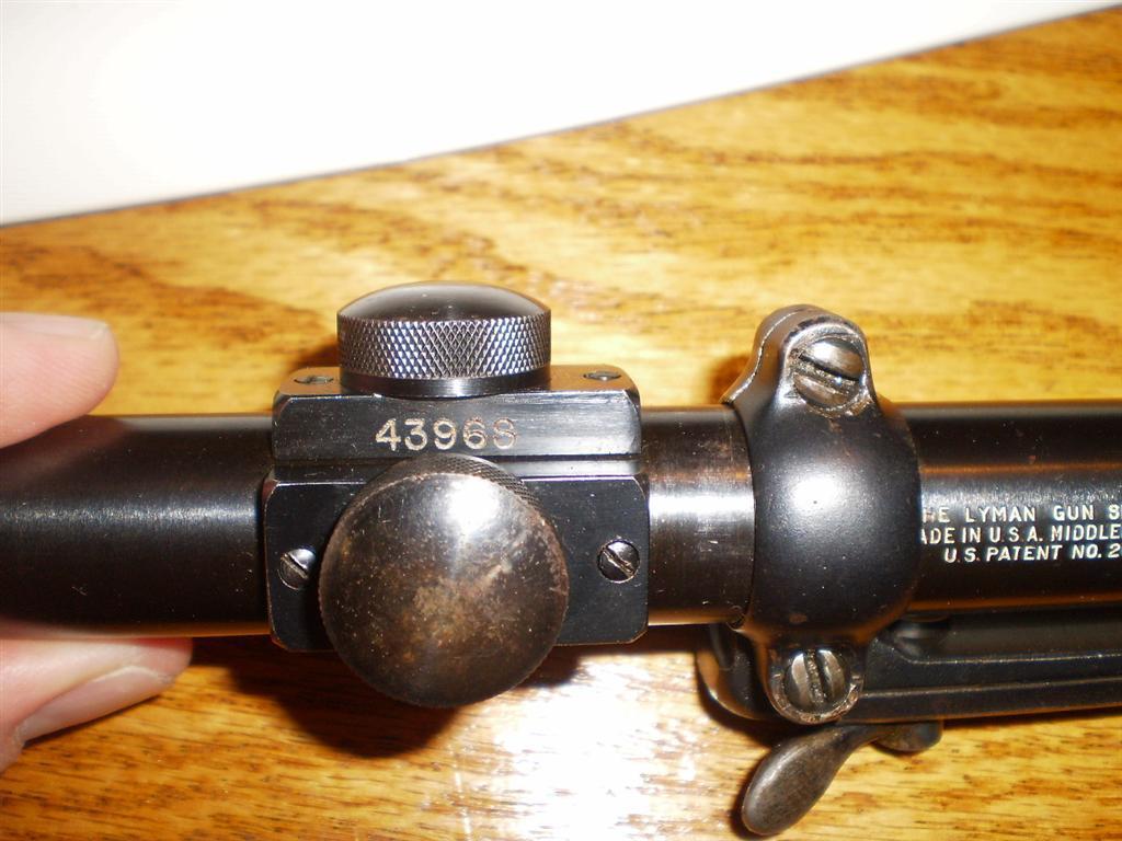

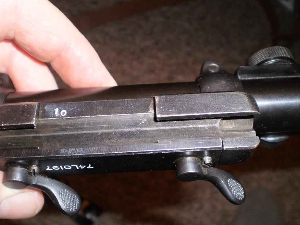

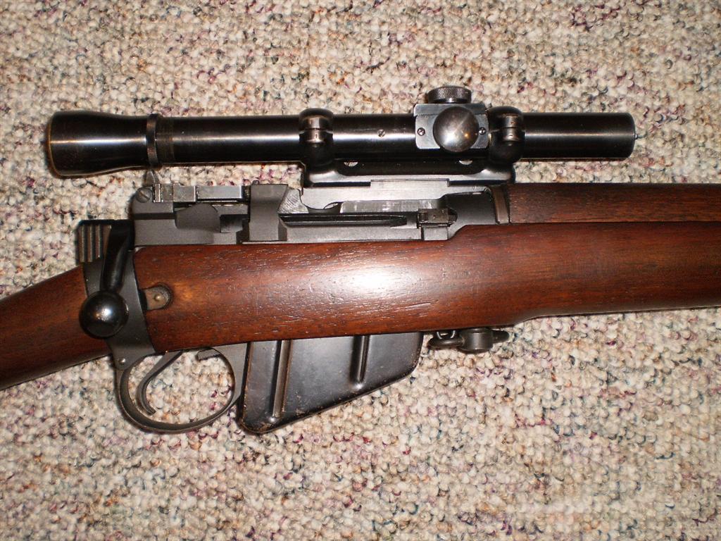

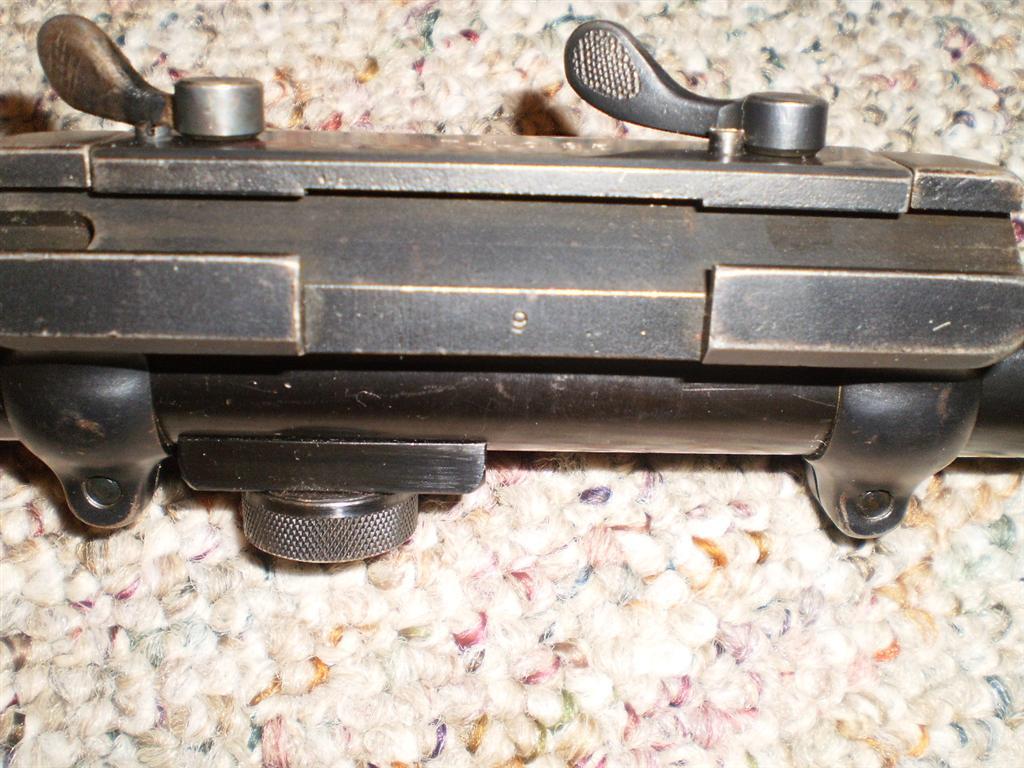

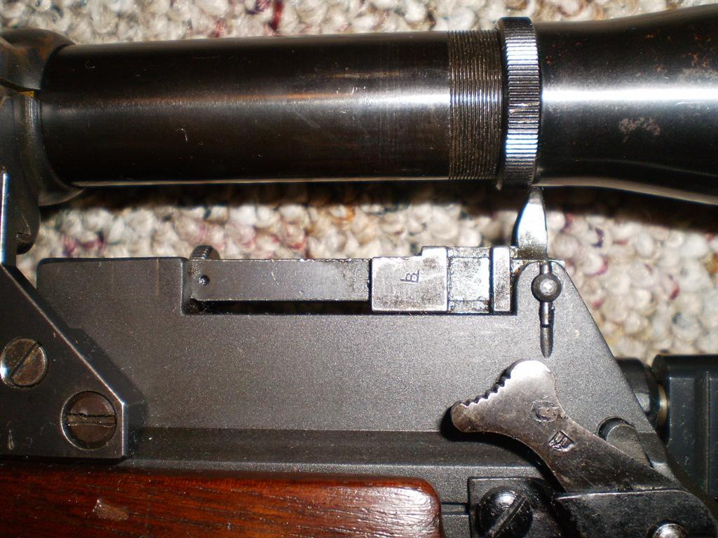

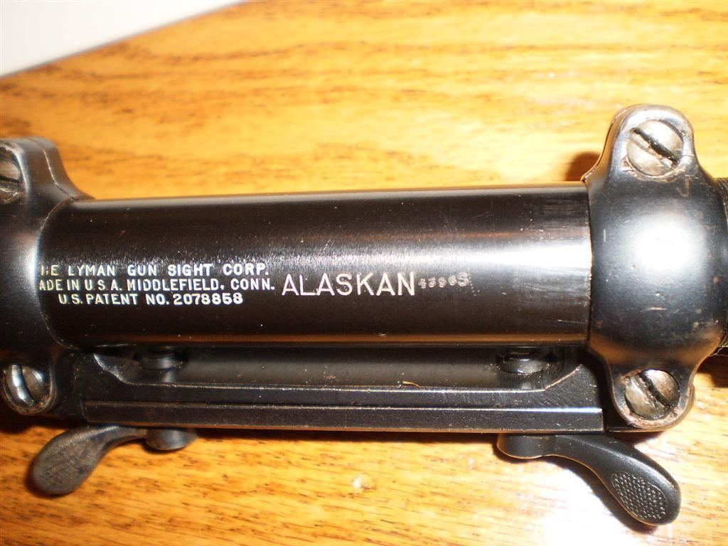

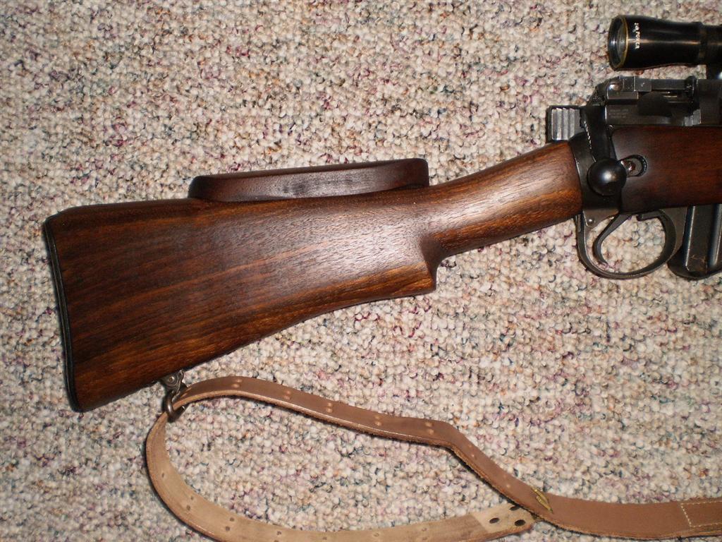

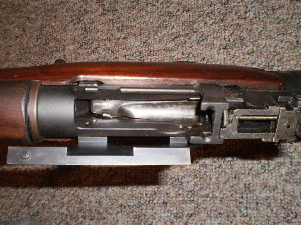

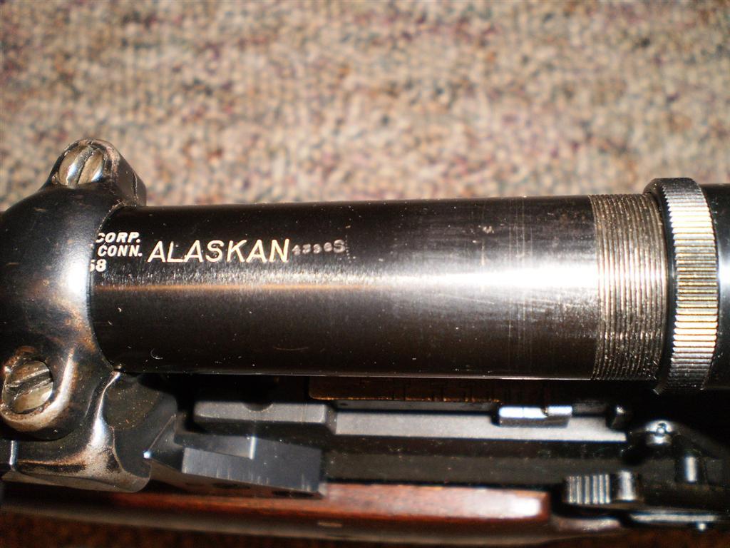

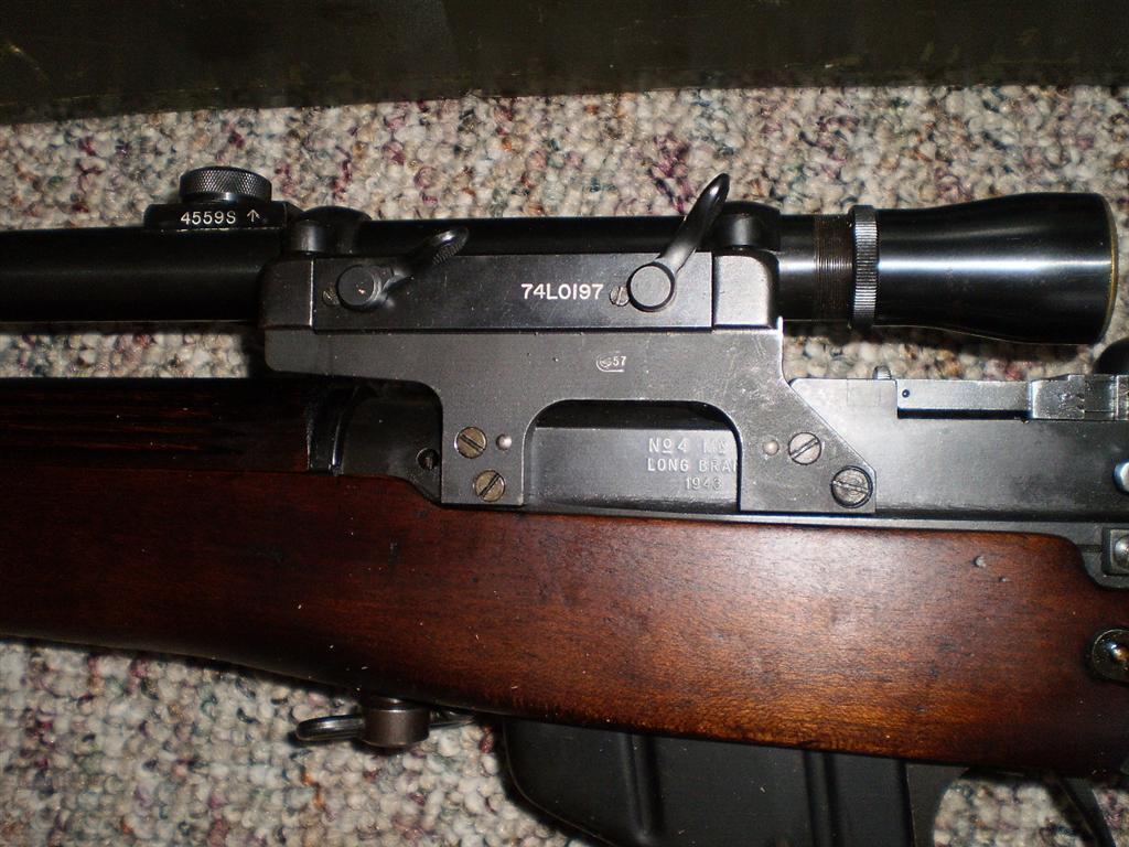

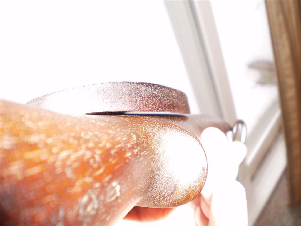

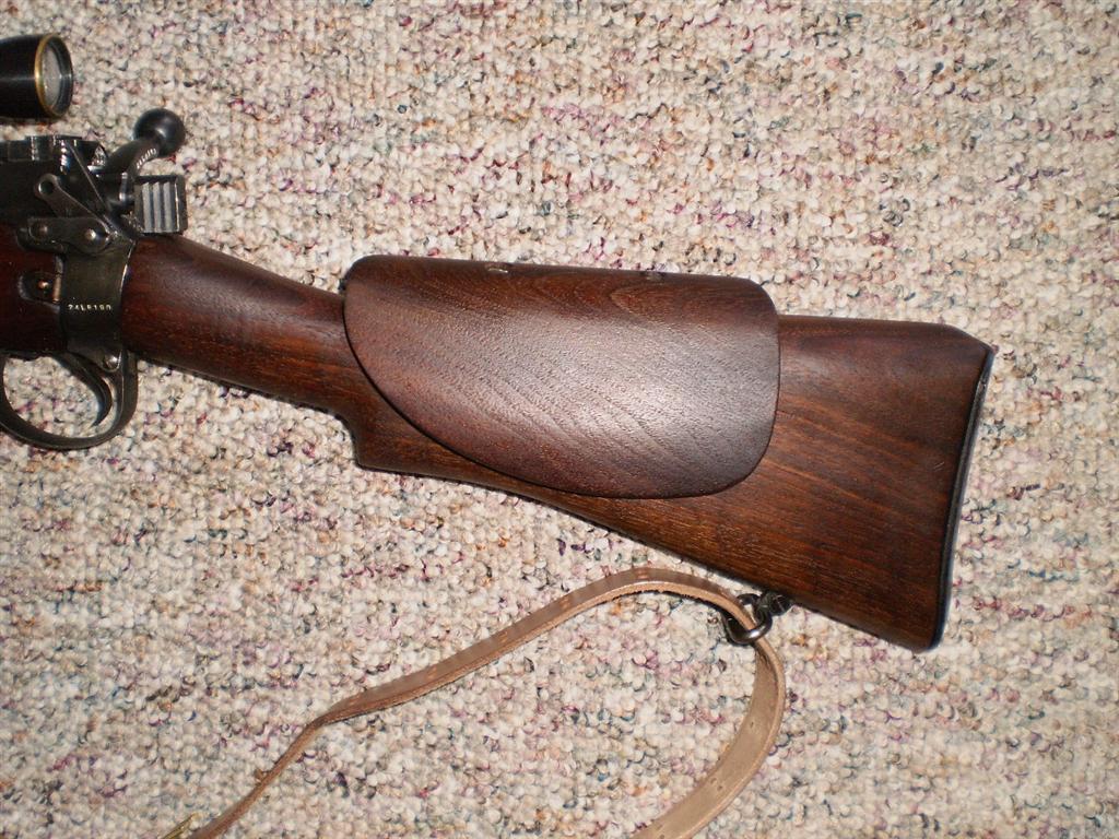

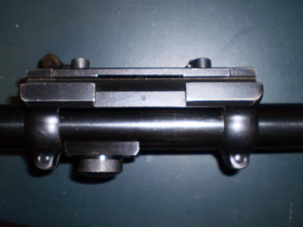

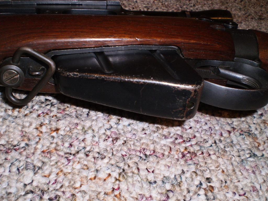

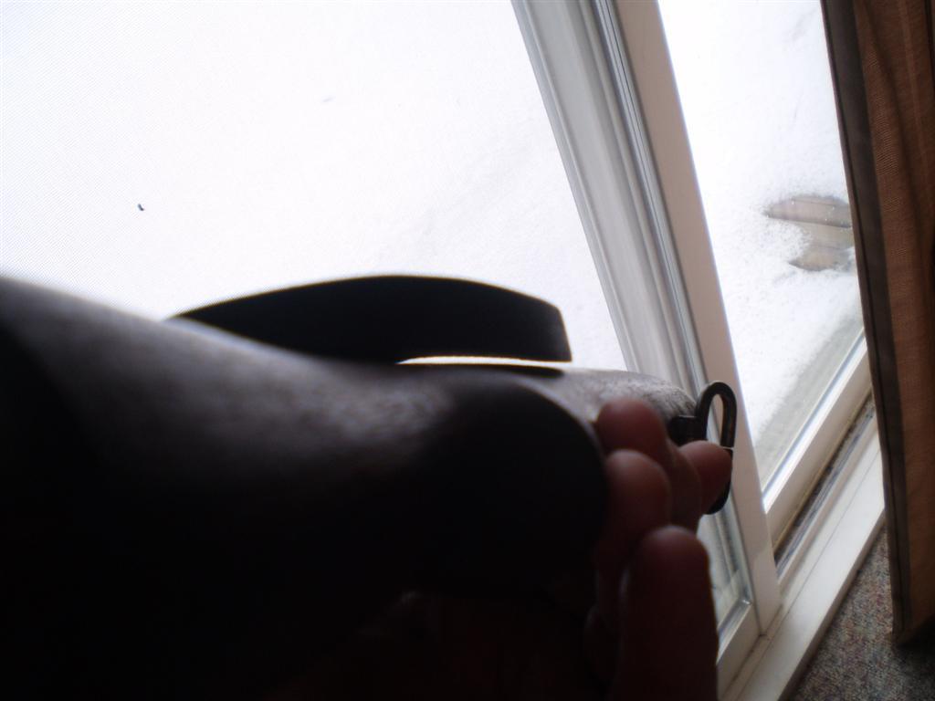

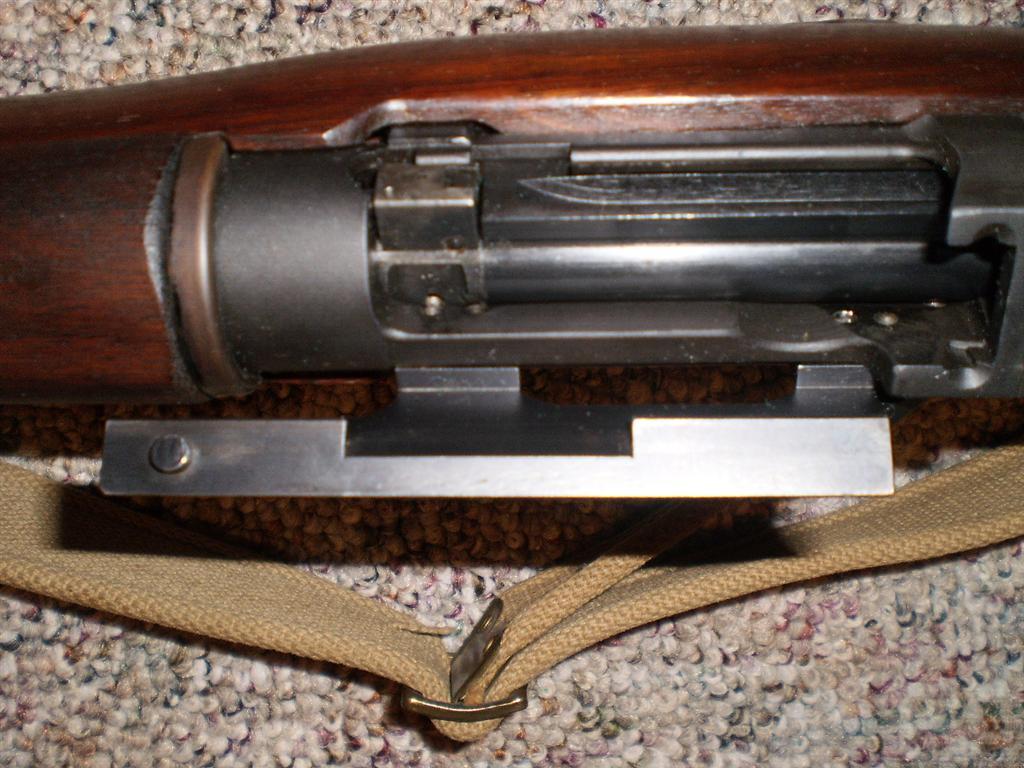

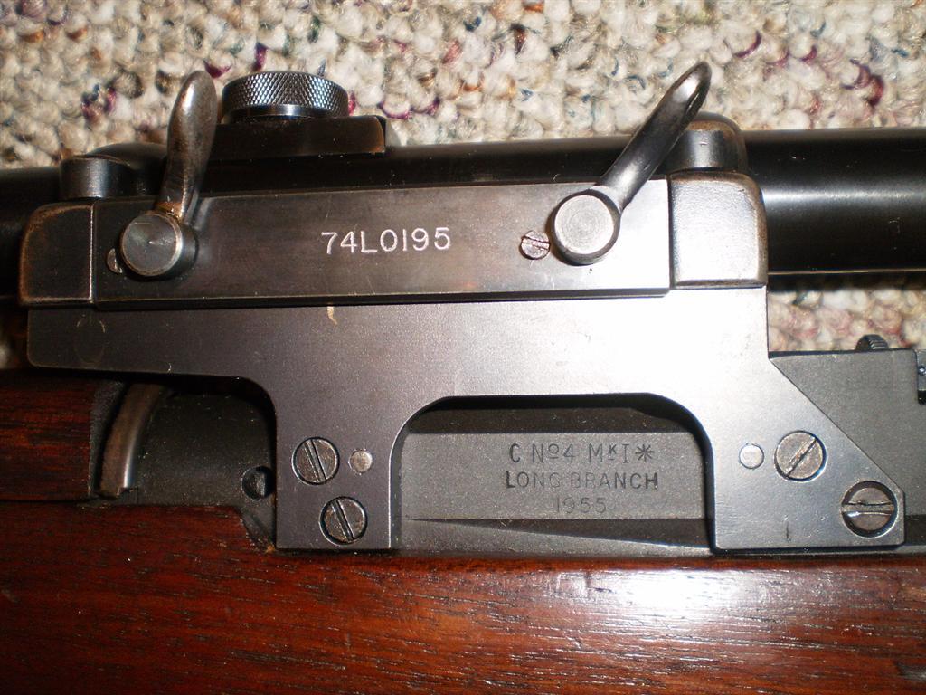

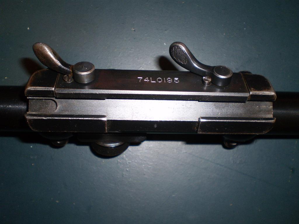

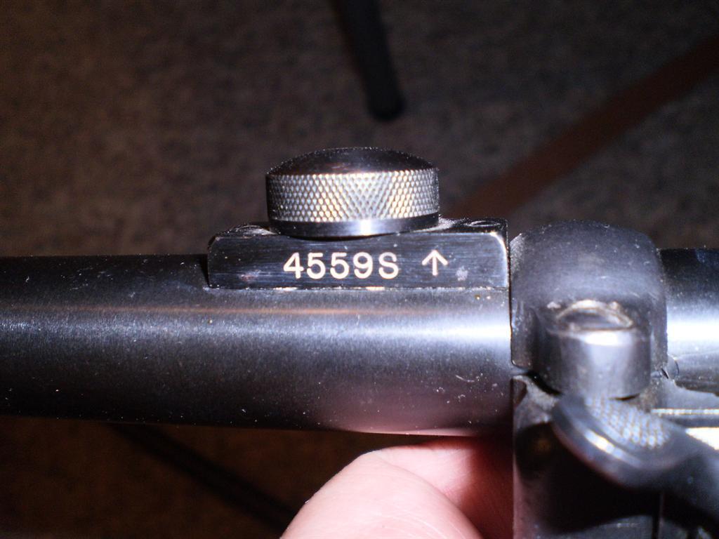

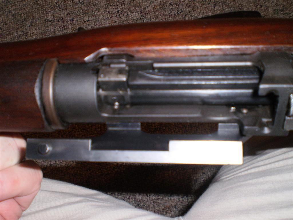

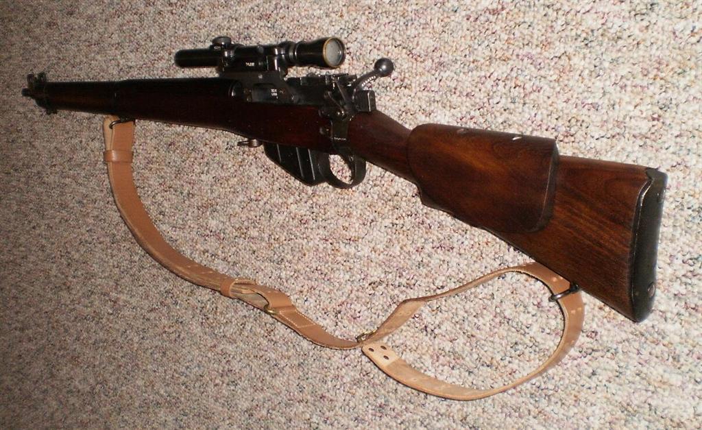

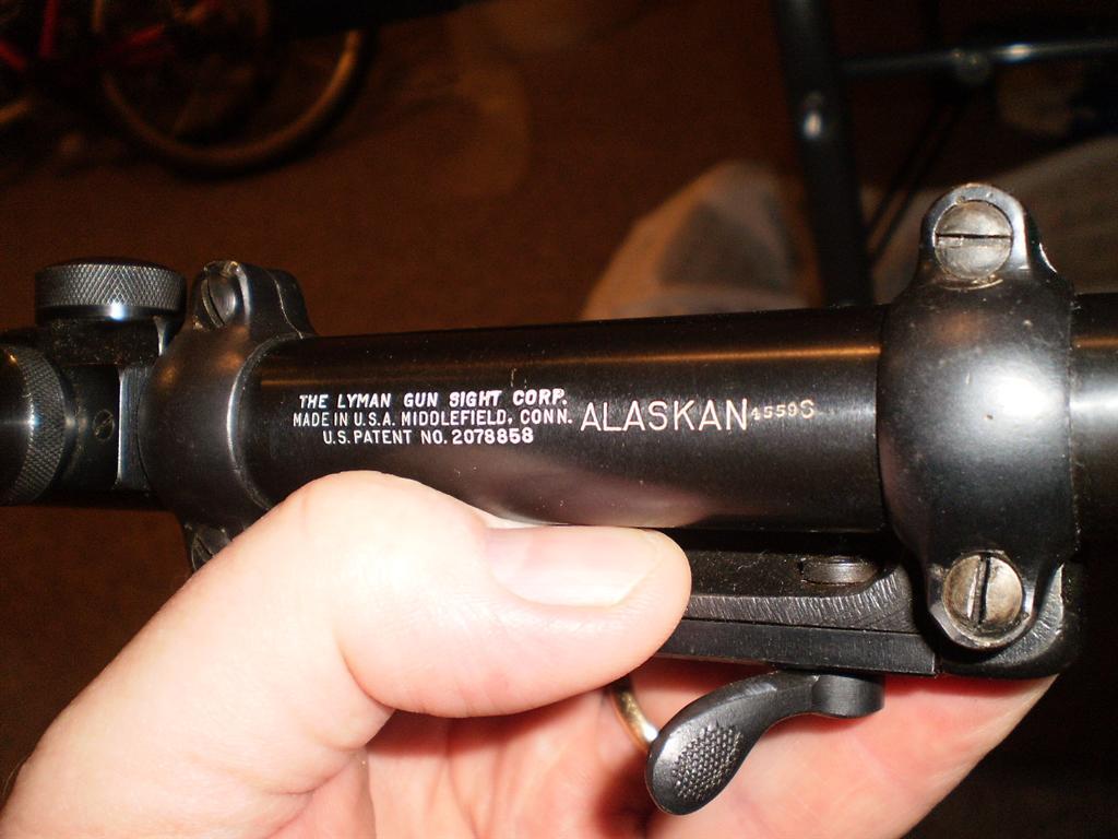

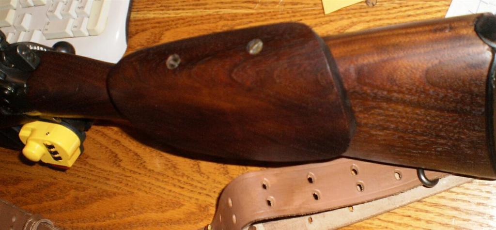

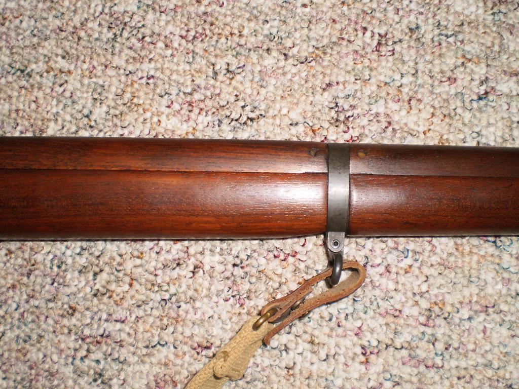

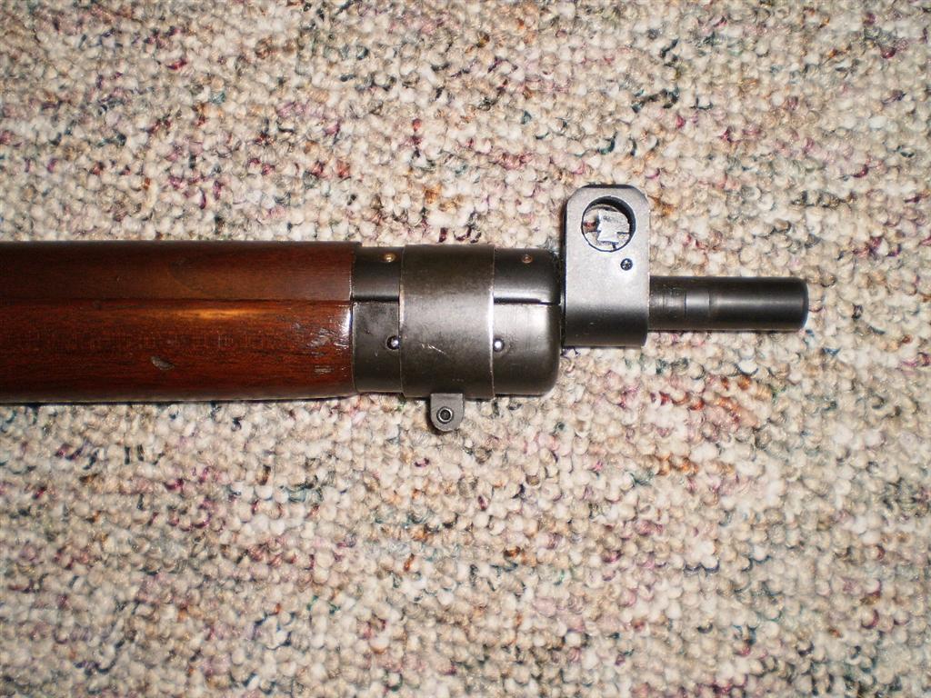

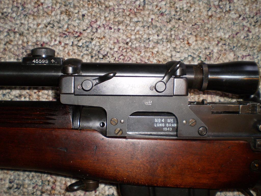

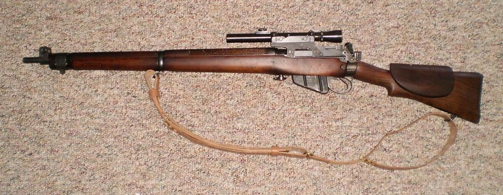

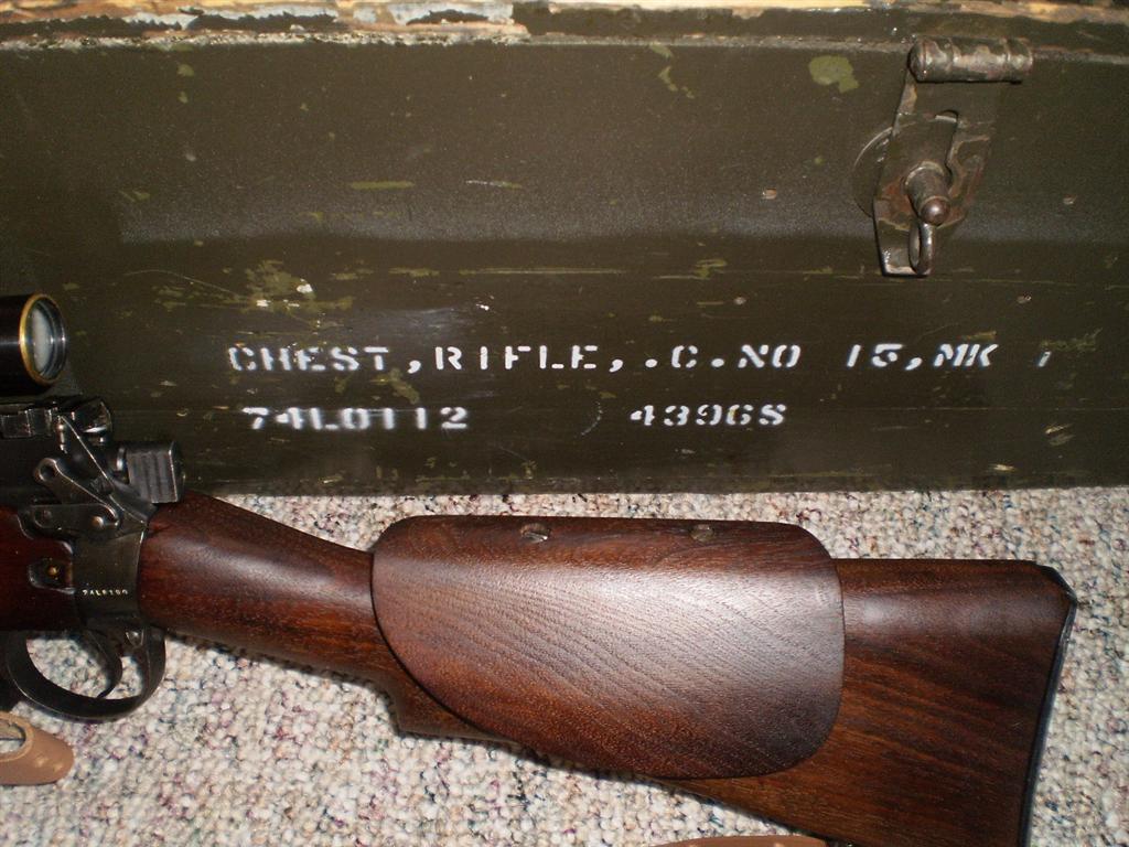

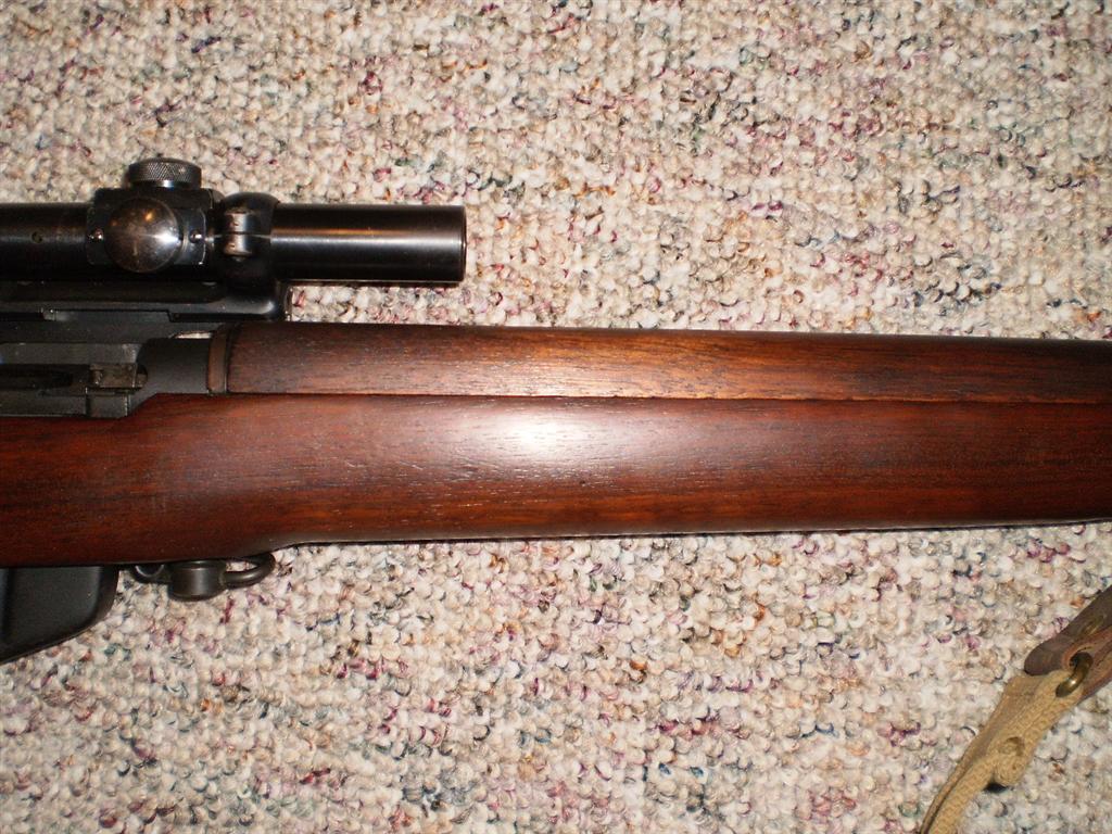

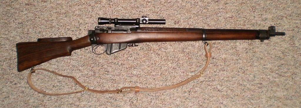

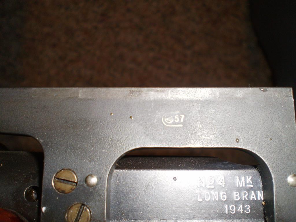

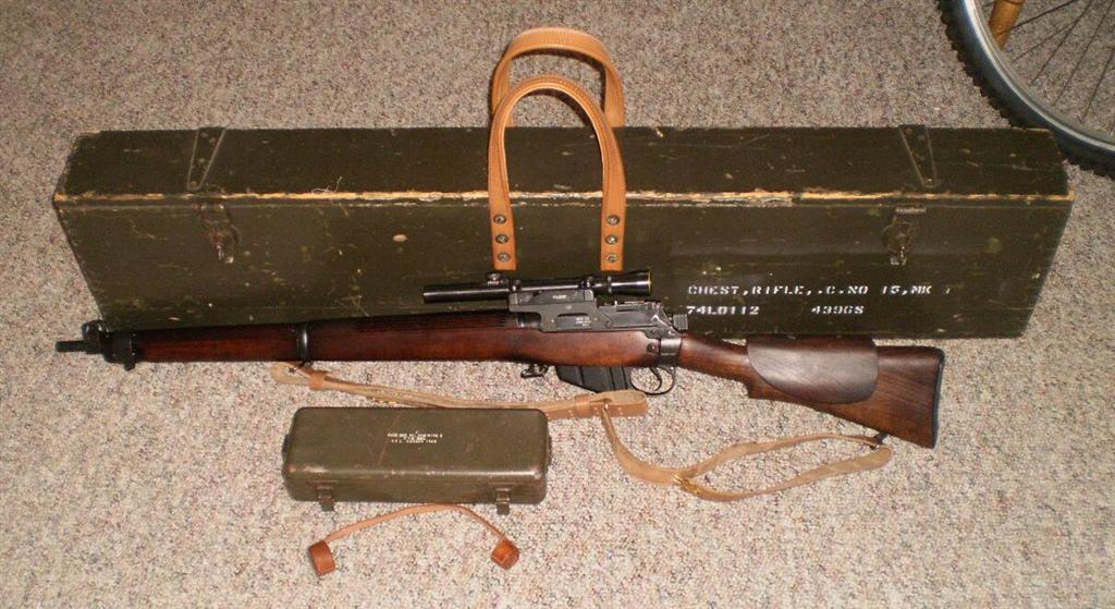

    The one I just bought had 2 interesting features that attracted me. Aside from the really nice scope and upper mount, the lower bracket has the Canadianicon proof mark which is so rarely seen. (as has been explained in this thread) Actually, Stencollector pointed this rifle out to me.

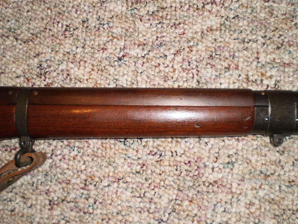

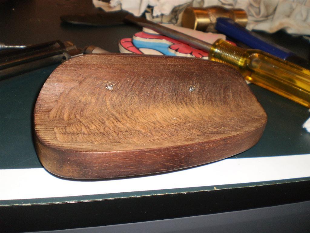

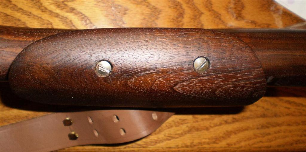

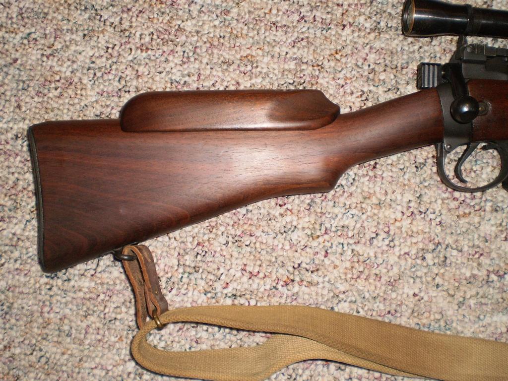

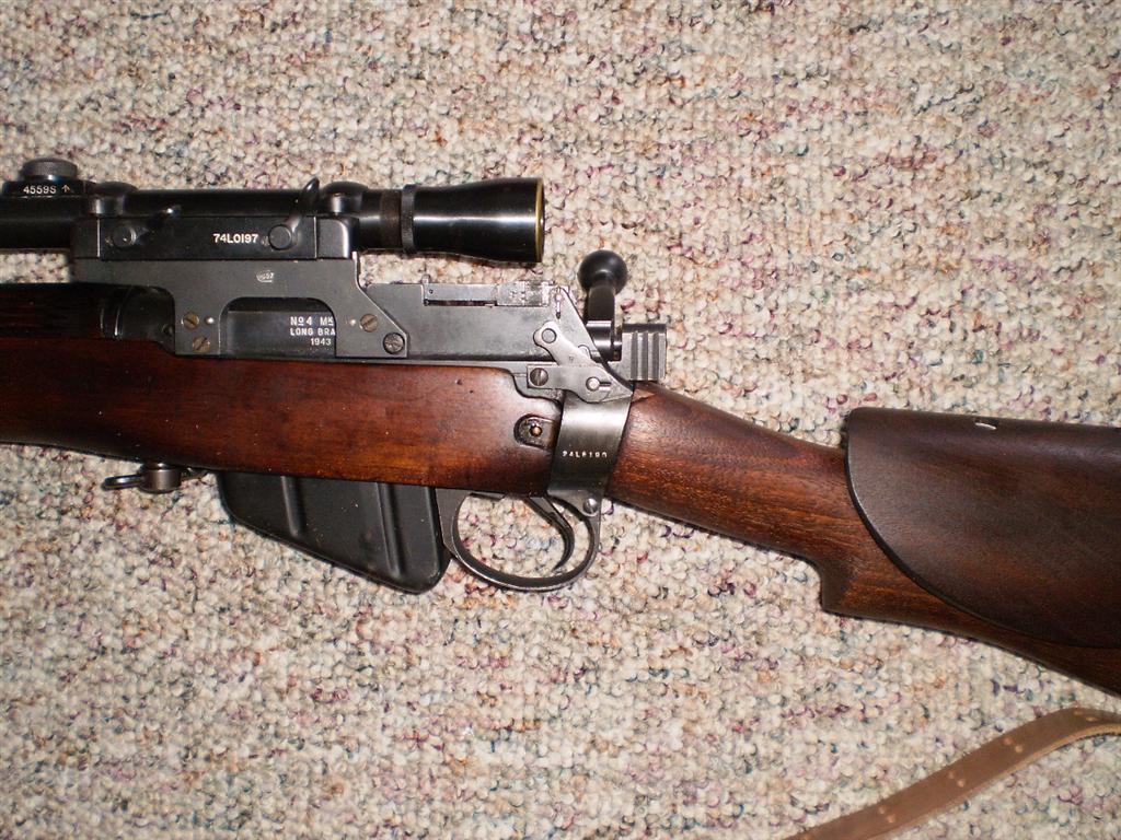

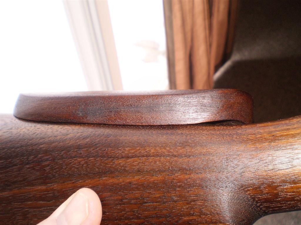

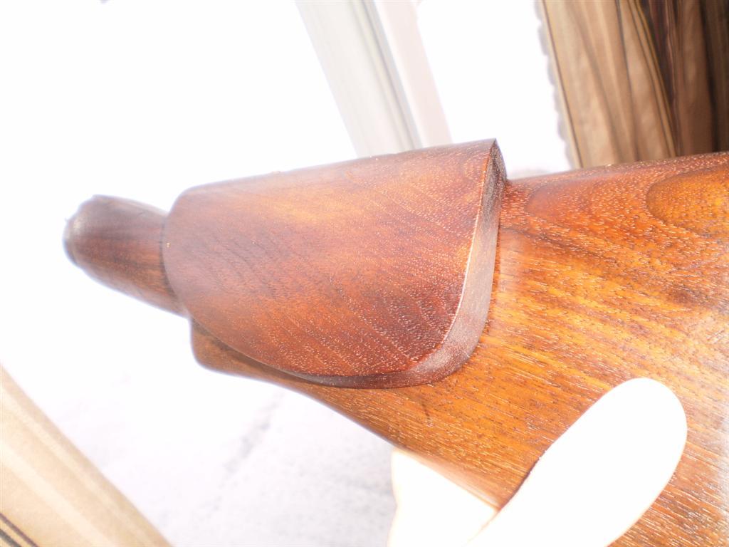

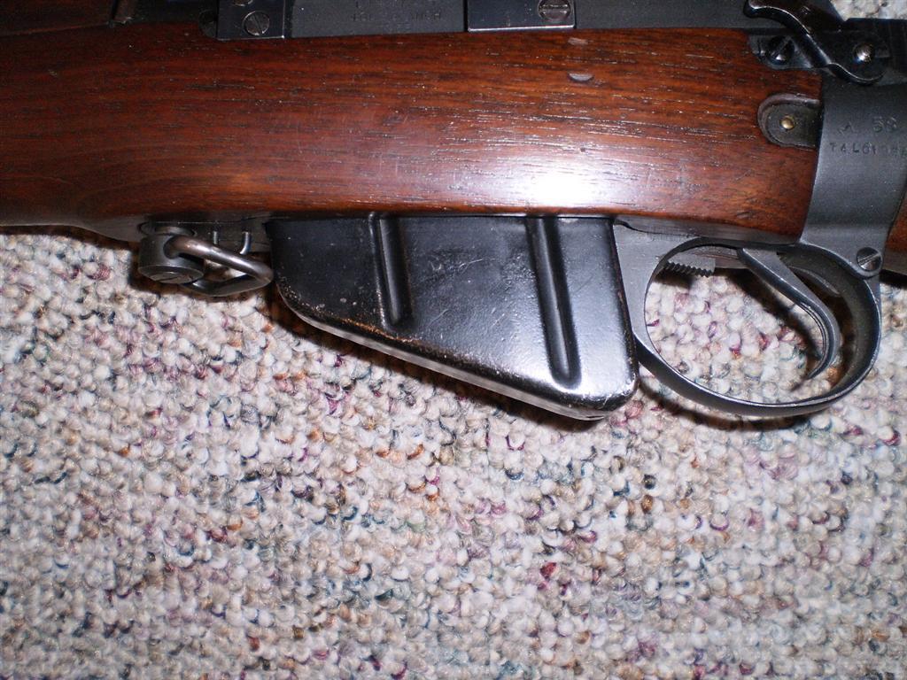

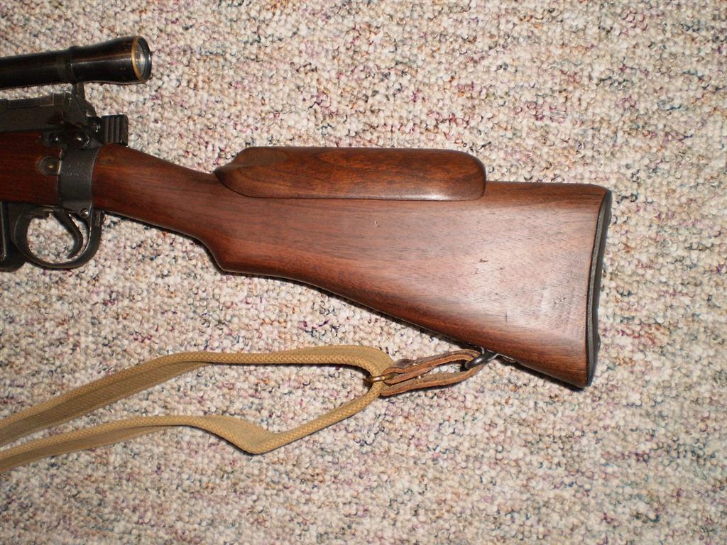

    This rifle also has an uber rare Canadian cheekrest. I've asked Warren W his opinion and he indicated to me that it was kosher. He's seen them before.
    I've had several of the rifles with the unmarked lower bracket and the fit of the upper to the lower is different. This marked one is to a closer tolerance. I had to push to get it to go on, vs easily sliding the others.
    Sadly, the rifle it's all mounted on is a 43 LB with a 24L s/n, which I doubt is right.

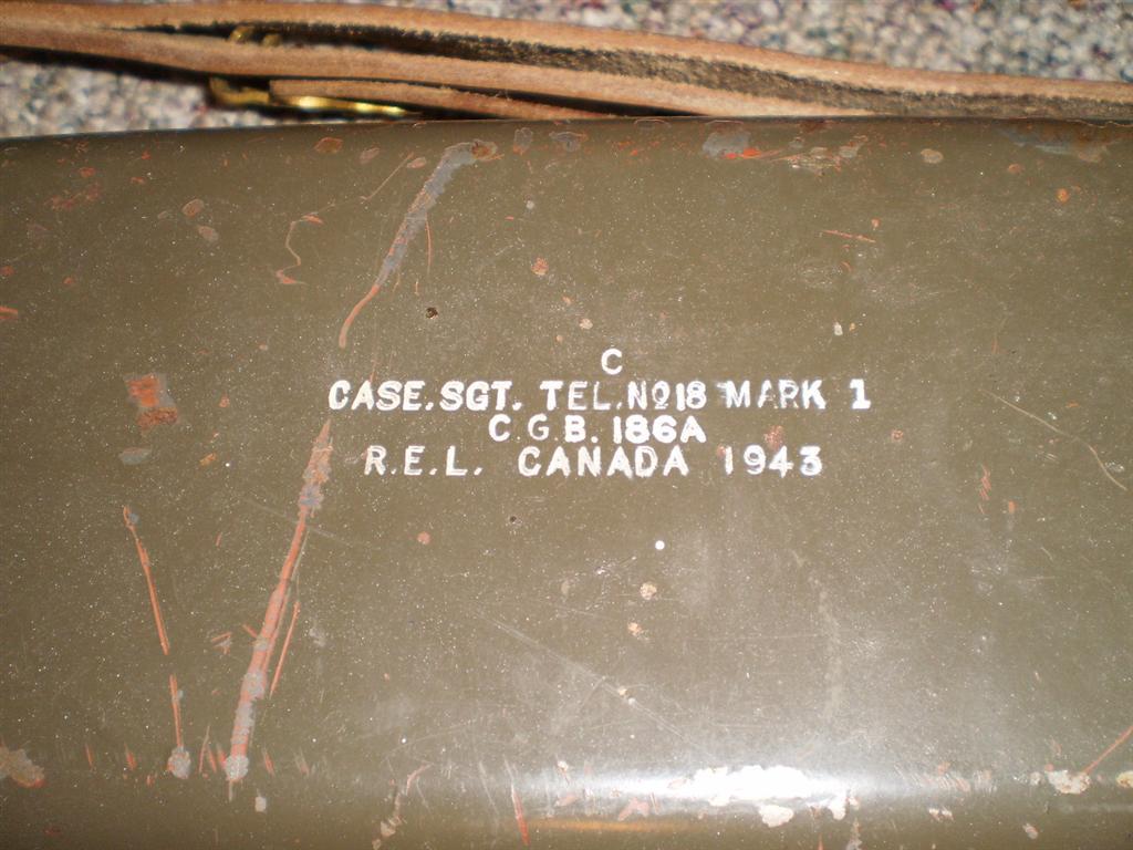

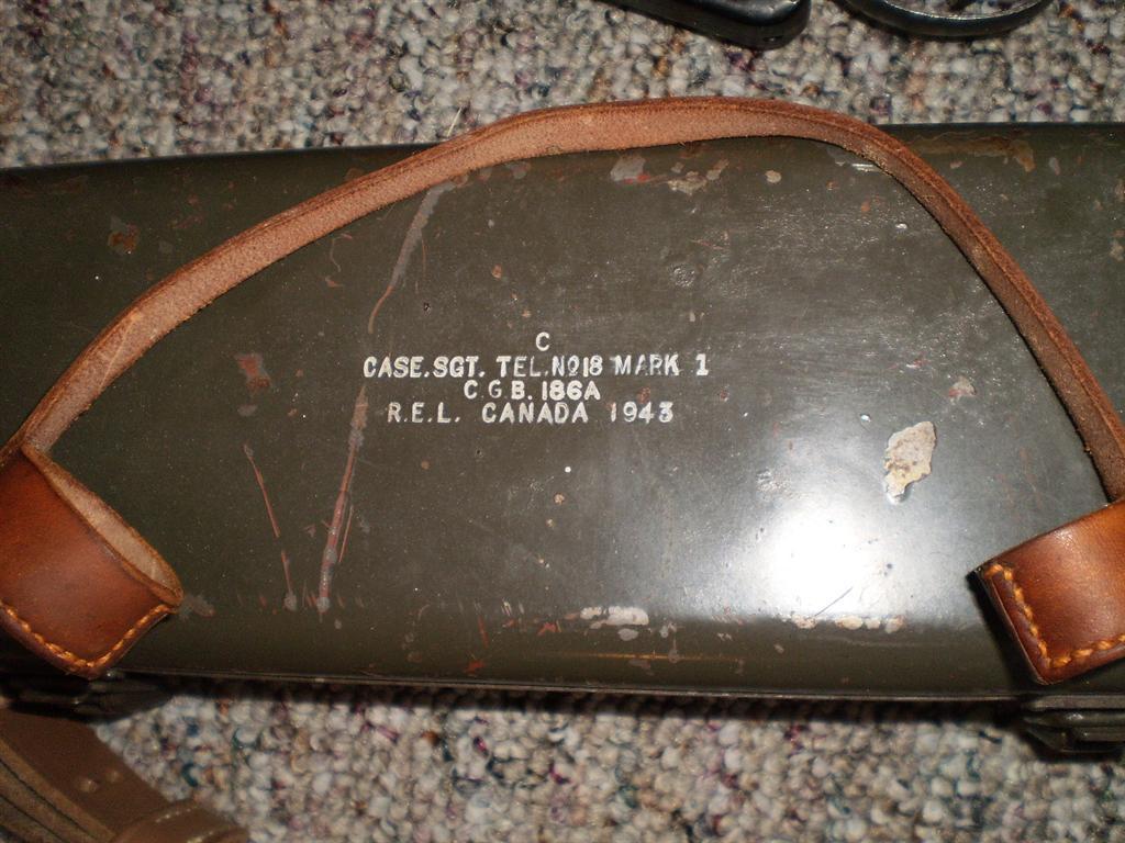

    Incidentally, my REL scope tin (the right one for the TP) is marked 1943.
    I had the repro leather caps made by Moore in the UKicon.
    You could say I am fond of the TP, warts and all.
    As imperfect as this set is, it's the best stuff I've been able to lay my mitts on.

    Nice rifle, I specially appreciate the exposure on the Canadianicon cheek rest. Nice educational piece.

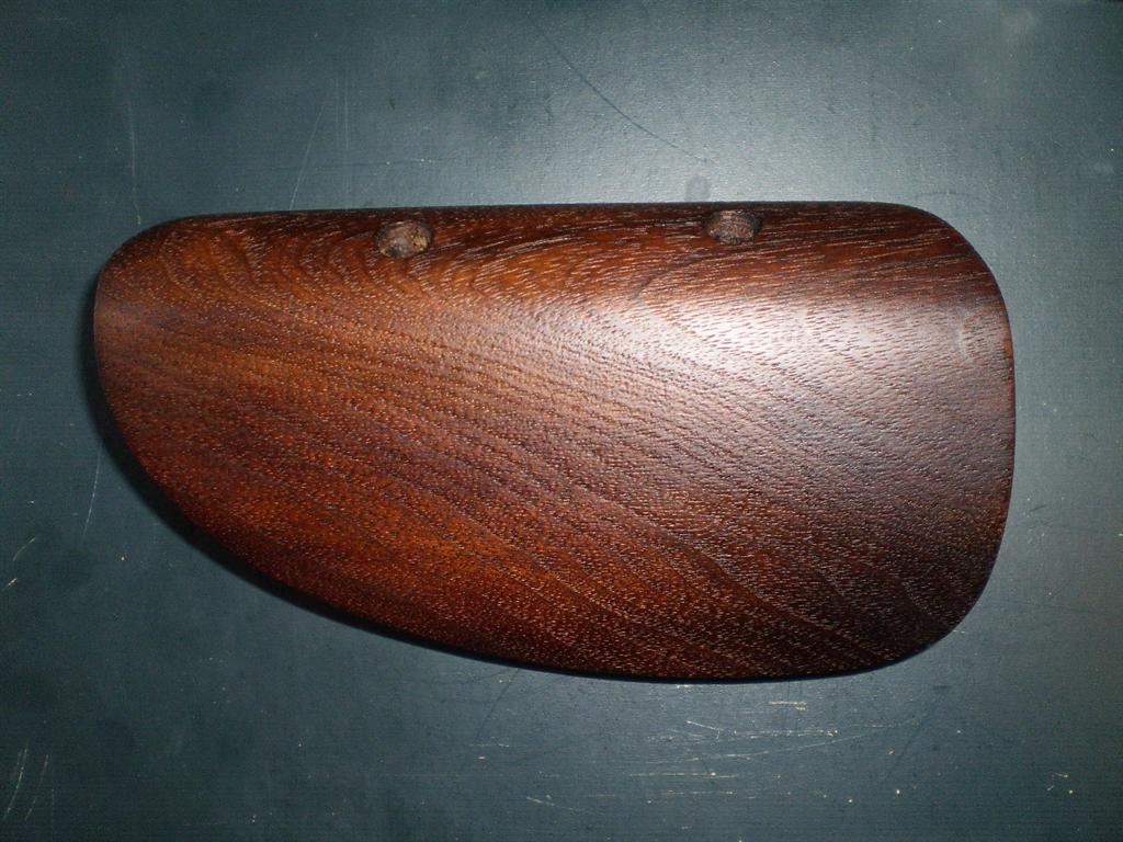

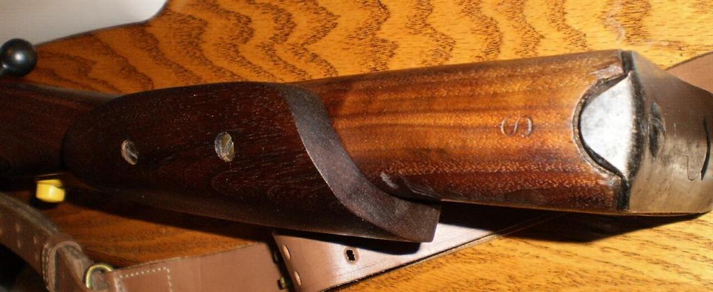

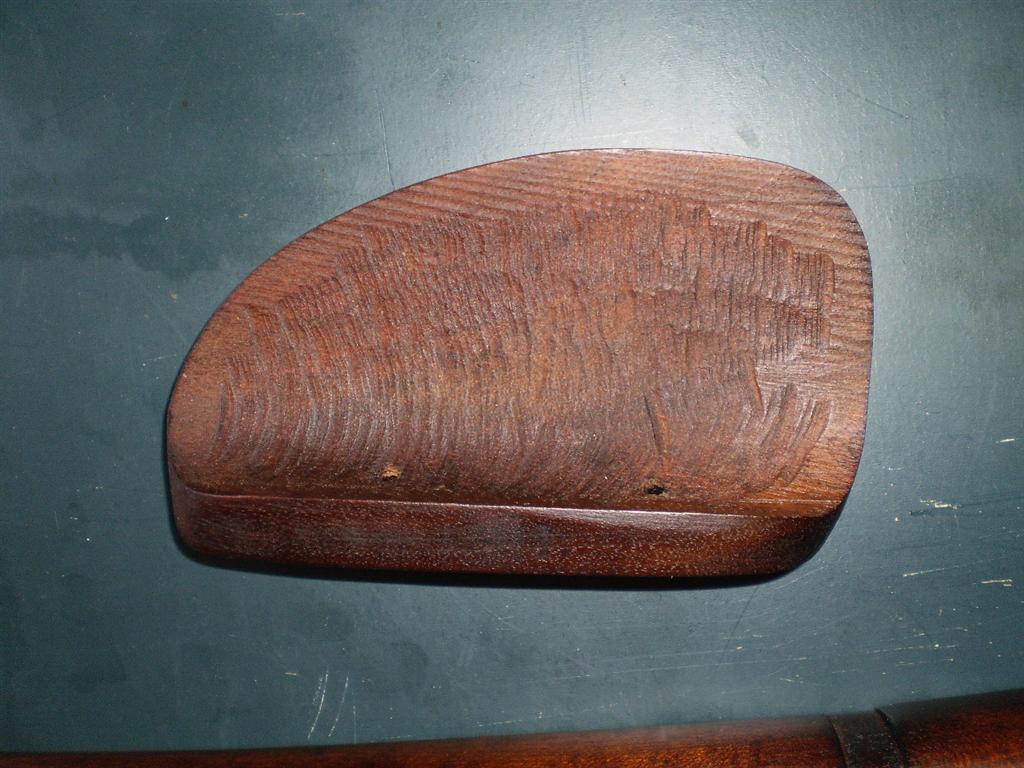

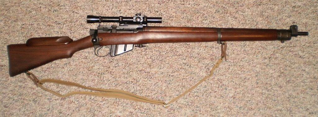

    Was this pattern of cheek piece a post WW2 variation, & is it an 'official' design? Have owned LB 4T's with three different slight variants of cheek piece, but all not too dissimilar to the UKicon pattern. This one is vastly different.
  12. #28
    Legacy Member Cantom's Avatar
    05-24-2021 @ 08:44 AM
    Ontario Canada
    411
    Tom
    05-13-2025
    06:30 AM

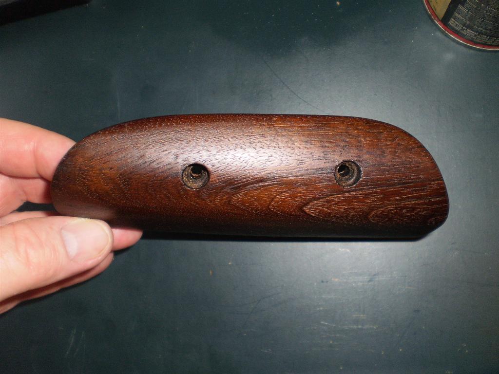

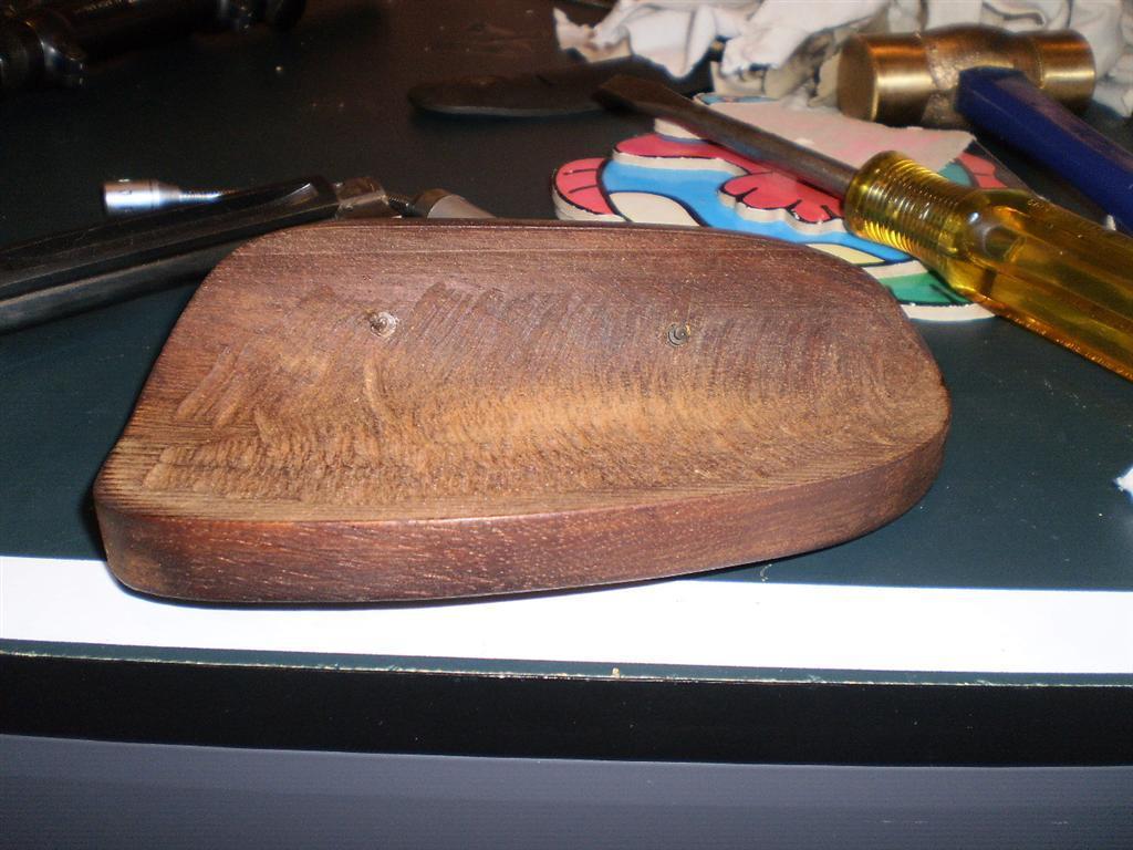

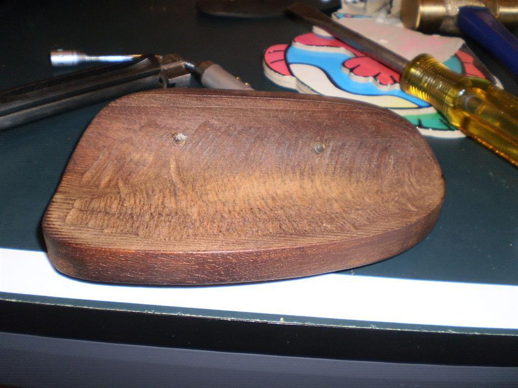

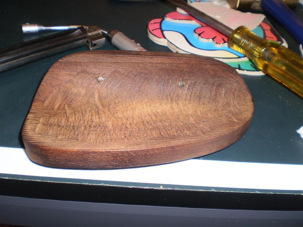

    The cheekpiece looks similar to several pictured in Without Warning. I looked in vain for a Canadianicon proof on the bottom of it.
    Very nicely fitted up with a nice gap under it....not the work of a hacker. Some very obvious Canadian black walnut wood.
    Not a lick of the wood set had ever seen linseed oilicon for a long time if ever.
