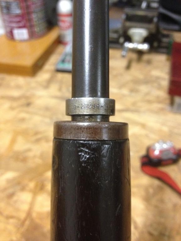

    late gas trap parts
    photo shows the revision 1 operating rod with both the comp and keystone springs which use the follower rod that is designed for these springs.
    also the front handguard ferrule has a lip used only with gas trap cylinders
    the Springfield butt plate is solid without a trap doorAttachment 61970Attachment 61971Attachment 61972

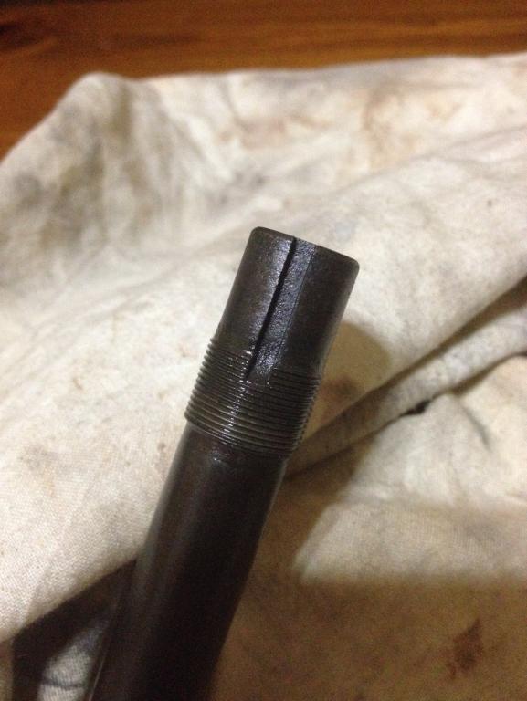

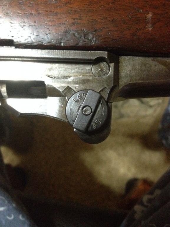

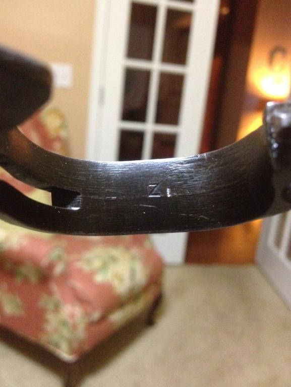

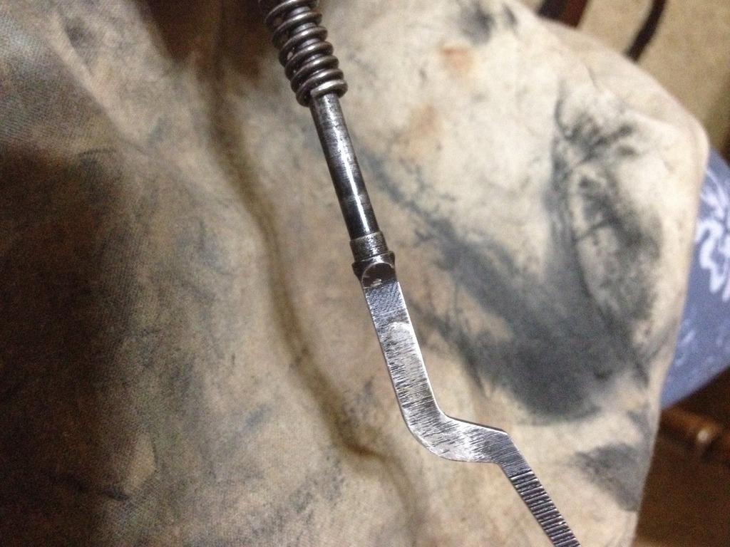

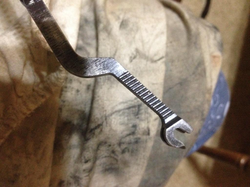

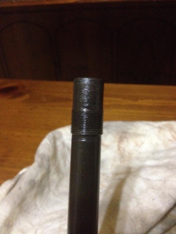

    Eight more photos:
    Bill Hollinger

    The OP is jerking our chains.
    He knows what he has.
    Pictures of the barrel with gas cylinder removed are great thanks, not something one gets to see every day.
    I see a broken op-rod spring.
    Chris

    Quote Originally Posted by Crispy View Post
    Yes, he mentioned that. Looks like two different ones screwed together.
    Chris
    I don't know that I would jump to that conclusion. I've been in constant contact and Jack seems to be a genuine guy who came to be in possession of this rifle quite innocently. I don't doubt he knows what he has now but I don't doubt for one minute he came into this with honest integrity regarding his questions about it.
    Jim, Jack is aware of the broken spring and all that has been done is the two halves were "screwed" together so it would stay in one piece.

    Hello all. Sorry if I have offended anyone as that was not the intention. Honestly I did not even know what a "gas trap" was until a few weeks ago. I was just cleaning an old Garandicon, that my grandfather used to deer hunt with, getting it ready for our annual shooting and fishing trip. I noticed a few things that looked different and researched the serial number. Once I figured out what I had I started looking for some folks that maybe could help me out and wound up here.
    Here is what I have learned so far:
    Stock and Hand guards replaced
    Operating rod is a rev 3 but is uncut.
    Operating spring is obviously incorrect.
    Front ferule was replaced.
    Trigger housing assembly has been replaced.
    All information and comments are appreciated. Thanks again.
