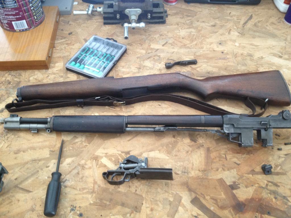

    I think I have an original gas trap rifle. Spring and front sight appear to have been replaced but everything else looks original. Rifle was my grandfathers and would never sell it but I am curious as to its authenticity. Any good information out there that I can use to verify it is indeed a gas trap? Thanks.

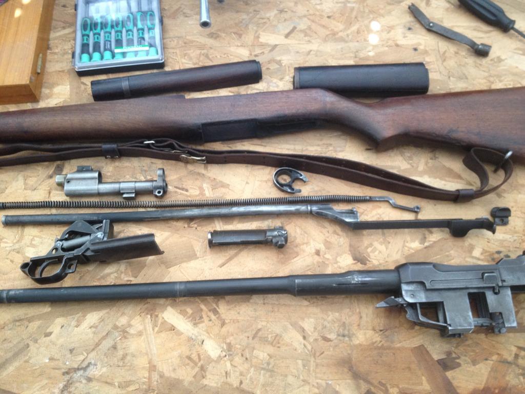

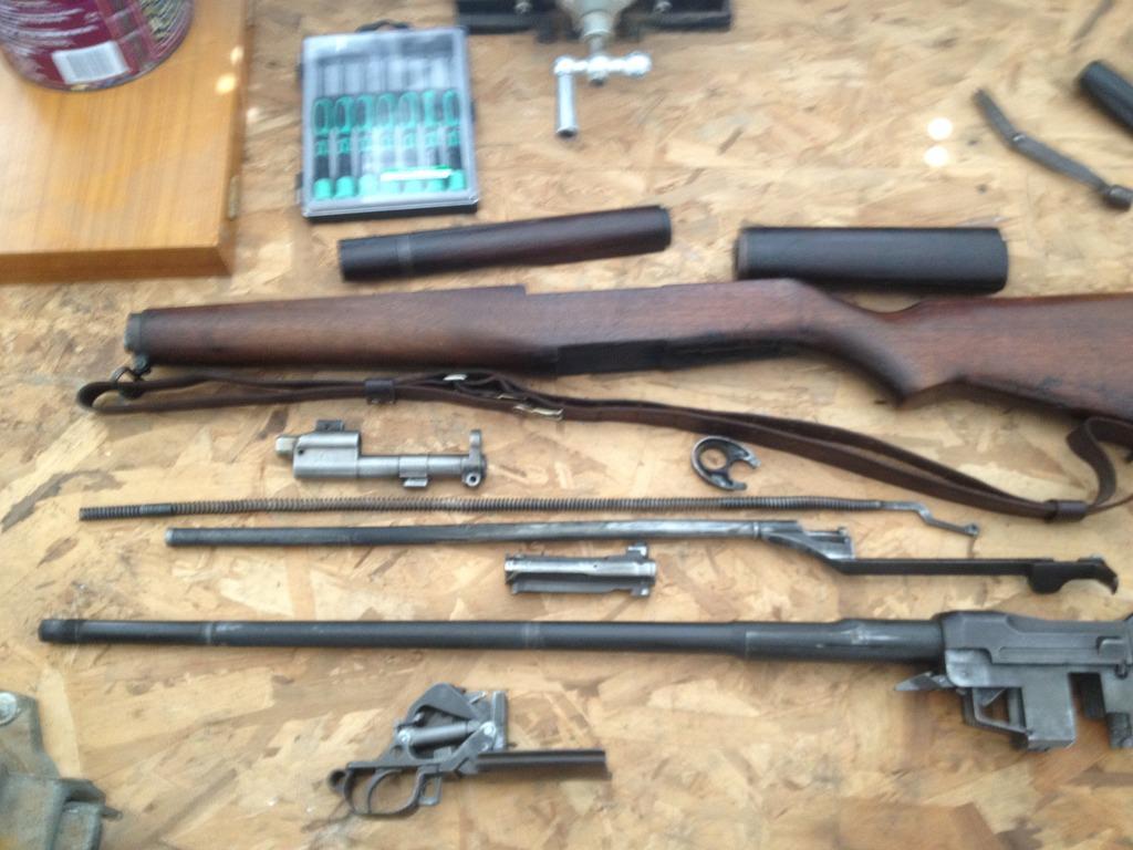

    Here are three photos from Jack. He will get me more detailed pictures.

    There are a few things wrong and leading me to think it was a put together. I think both hand guards are later as is the metal on them. The op rod is later [ possible later Gas Trap]. The barrel has many many scuffs as if the guard was put on and taken off allot. The front of the barrel seems to have less wear than the receiver. Numbers off parts are needed as many are later parts and can fall into the later Gas Trap era but may very well be very later gas Port parts. Neat find either way What serial range is the receiver??? Rick

    Think it is 48304. I will verify when I get back home. Thanks!

    No doubt that is a gas trap type gas cylinder.
    I'm sure we would all like to see pictures of part markings starting with barrel and receiver.
    The list of known gas traps is fairly short so please excuse us if we appear skeptical.
    We want to believe another gas trap has "appeared", it gives us all hope of finding one!
    What's going on at the front end of that op-rod spring? Something stuck inside the coils?
