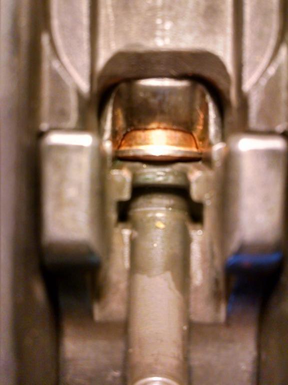

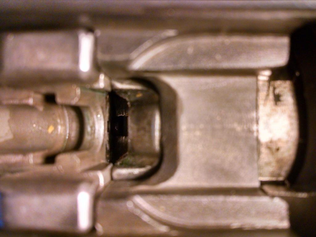

    Many thanks Mr. E. You are quite correct. It appears that my rifle is not headspacing with the cartridge at all (see pics) The bolt stops with the bolt stops which are also aligned with the end of the barrel. The back end is held in by the shoulder stops. So shimming the barrel will not change anything for me (right?) It would appear that if we want to have a bit a play in the bolt back and forth between the stops (and barrel) and the Locking Shoulders we need to get a shorter licking shoulder (right?)
    Here we see the bolt resting directly against the barrel an the stops
    Here we see that even with the cartridge, the spaces between the barrel and the bolt face etc. don't change. The casing fits in the pocket created by the stops and bolt face.

    in both pictures it looks like the bolt is stopping on the barrel. can you fit a slice of business card between the case and the bolt face?
    to me the issue looks to be zero head space...

    Quite right Mr. E. The bolt contacts directly on the bolt stops and barrel = 0 headspace since the locking shoulders allow for NO rearward movement of the bolt when locked in the shoulders.
