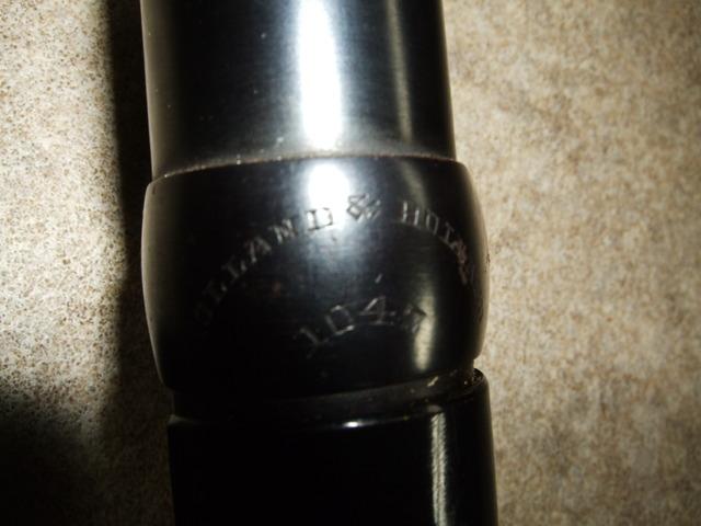

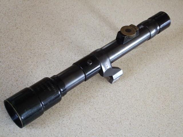

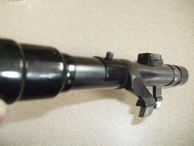

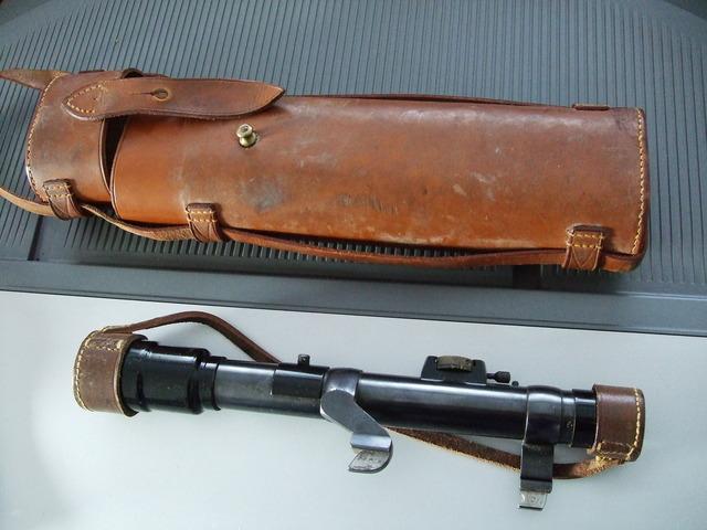

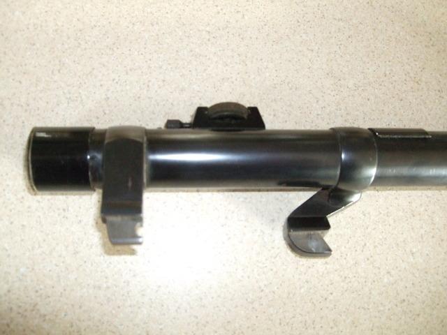

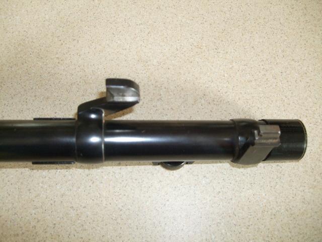

    SMLE/Aldis/H&H two piece mounts.....
    Sorry to be slow to chip in but I just drove back from the Somme 99th anniversary commemorations this evening. The thumb nails show the original rifle I rebuilt from a stripped receiver (EFD 1916 Mk3*) a couple of years ago. I submitted some photo's at the time, & they are a few pages in on the Restorer's Forum. She's complete now save for the modified rear hand guard.
    ATB
    P.S. Sorry the photo's are indifferent in quality, but they are all I had readily available.

    The Small Arms Committee decreed in the early 1920's that all SMLE snipers should be returned to Weedon in Northamptonshire where they were to be stripped down & all salvageable parts reused. Most scopes were sold off into the trade & some (mainly Aldis types) were retained against possible future need. The only genuine WW1 SMLE snipers that have survived are rifles which for whatever reason did not get sent back for stripping down. In the early 1990's Ryton Arms imported from Egypt 1200 SMLE's that had been in a warehouse for decades, & amongst them were two authentic Periscopic Prism Company rifles (no scopes, but mount bases present). One went to the Charnwod collection, & the other was retained by the then manager of Ryton Arms. Fortunately, after a couple of years I managed to persuade him that he didn't want it any longer.
    The other rifle that I have, shown in the pictures earlier in the thread, is a complete rebuild of a SMLE/ with Holland & Holland mounts, but it is built on a genuine receiver that had had the mounts removed, & all original parts have been used in the rebuild. On a rifle so rare, I can live with that. I have other SMLE snipers, but they are WW2 Lithgows, & I have other WW1 snipers, but they are not SMLE's. Just two examples in forty years of actively seeking them out shows just how scarce they really are......
