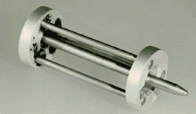

    Now if someone has one of these, could they send it to me.
    This is what the Canadianicon's originally designed as the BFA for the C1/L1 rifles, circa March 1958 (photo copyright is Springfield Armory collection)

    Any idea how that locked into place? Or was it just rotated around a third of a turn until the bayonet standard met the next longitudinal bar? It has obviously been used by the black carbon deposits. Would be a doddle to make a repro as a representation for your collection.
    Without a locking mech I can see the problems immediately. If it COULD fly off and injure someone, then it WOULD!
    It slides on and rotated counter clock to "Lock"...

    Yes, but how does it actually LOCK? The bayonet standard must enter into the middle part of the BFA, between the two rings......... Then what? I can see how it would be retained but retained ain't locked. And if it ain't locked then it's an accident waiting to happen.
    There was an injury report doing the rounds here while the L1A1's were in service where there weren't enough BFA's to go around and during an ambush training scenario, those without BFA's were instructed to take a load of empty compo ration tins into their ambush positions and 'fire' the tins off the end of the BFA-less rifles towards the enemy.
    You can guess what happened. One bloke was hit in the side of the head by a low flying empty potato powder tin which gashed/split his ear. The DS told him to man-up a bit and stop being a wuss of course. But the xxxx hit the fan a few days later after the cammo cream caused the nasty gash to go manky.
    Yep........ just like SA80 bayonets. If they ain't secure, they will go flying off down the range..............
    Doesn't appear to. Maybe that's why it didn't make it past trials or submission...?
