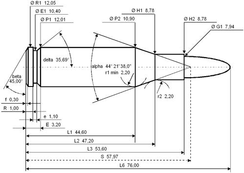

    Quote Originally Posted by Sentryduty View Post
    What about 7.65x53mm?
    Wiki specs:
    Specifications
    Case type rimless, bottlenecked
    Bullet diameter 7.94 mm (0.313 in)
    Neck diameter 8.78 mm (0.346 in)
    Shoulder diameter 10.90 mm (0.429 in)
    Base diameter 12.01 mm (0.473 in)
    Rim diameter 12.05 mm (0.474 in)
    Rim thickness 1.00 mm (0.039 in)
    Case length 53.60 mm (2.110 in)
    Overall length 76.00 mm (2.992 in)
    Americans would define the shoulder angle at alpha/2 ≈ 22.2 degrees. The common rifling twist rate for this cartridge is 280 mm (1 in 11.02 in), 4 grooves, Ø lands = 7.65 mm, Ø grooves = 7.92 mm, land width = 4.20 mm and the primer type is large rifle.

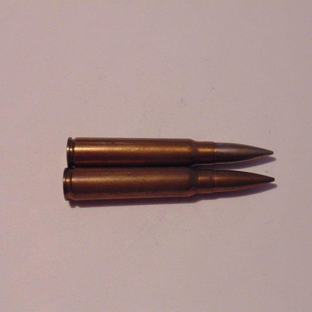

    Interesting, and Belgiumicon was using that round at that period of time, however wouldn't .318 be too large for it, as those used .311 bores

    Quote Originally Posted by Eaglelord17 View Post
    I tend to agree, but with a quoted bullet diameter of .313" it's somewhat close. Based on the half cast visual angles and proportions, and the failure to close on a pulled cartridge leads me to suggest this as a possibility.
    We have a similar angle of case neck and length, we have a shorter overall cartridge compared to an 8X57mm, we have a caliber that was in use as the time, and the bore slug could be a from a generous (loose) refit barrel or heavy use.
    We have encountered Russianicon 91/30's with generous bores from time to time for various reasons. I am not 100% convinced of my own reasoning, but I think this caliber could be a good possibility, and worth taking some more specific measurements.

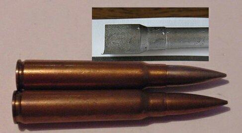

    The only way to make an intelligent guess would be to have a full chamber cast. So I went back and got a full cast out. The chamber is definitely shorter than 8 x 57. my fumblings show a case about 52mm long. The nearest thing I can find in Frank Barnes "Cartridges of the World", is the 8 x 53 Mauser. That bullet is .318".
    I'm no Mauser expert. What are opinions? This is not the original barrel?
    If it's not, someone went to a lot of trouble to keep the same barrel contour, front and rear sights, etc.
    Does anyone know what the mark under the barrel is?
    Again, thanks to all for your insights.
    Ruff
