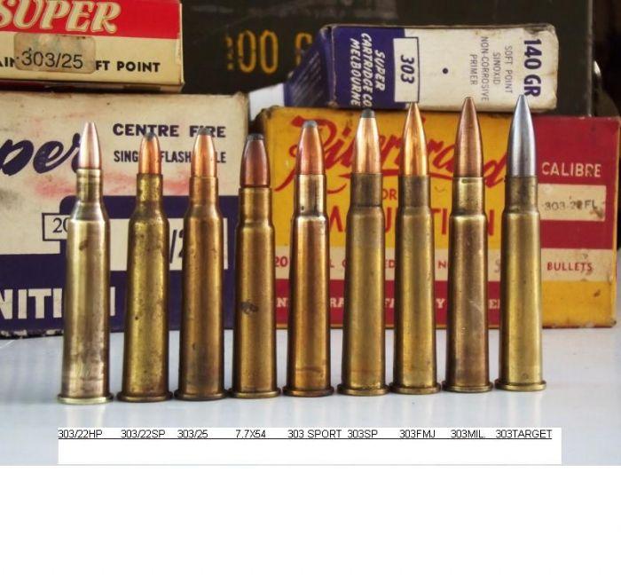

    just putting the thought out there, could it be a variant made on the same premise as 7.7 by 54r? aka turn an illegal military calibre into a legal non military one by shortening the barrel at the breach end, rethreading barrel then shortening the cases to match?
    a little on 7.7 by 54r: https://www.milsurps.com/showthread.php?t=25320
