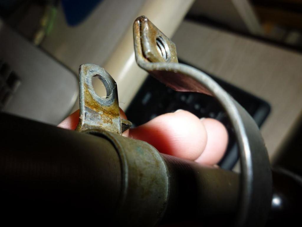

    Back to the band question: So far no one has definitively named the replacement band as a repro. The edge is the biggest issue for me. Here is the pic with that highlighted. Did any supplier produce a band with that flat edged stock for WWII carbines?
    You guys with known unmolested original carbines can solve this one for me. Do any of your prime examples have a sharp edge band around the stock or are they all rounded?
    Flying10uk: re. Looking carefully at the edge of metal there is a difference between a Laser cut part and a punched part or normal stock edge.
    What can you tell me about the edge on the right?
    ps. I love this hobby but hate humpers passing off repro/rebuilt as original. A few months ago I thought a humper was an energetic puppy.
    edit: John provided a pic of one of his originals, it has the rounded edge.

    Quote Originally Posted by HDSledge View Post
    I would say that the outer profile of the band is punched rather than laser cut. With laser cut parts you normally get tiny tell-tail lines running at tangents along the edge where the metal has been cut by the laser beam. Punched metal will normally have a "witness" line running somewhere around the middle of the metal, visible along it's length on the edge. The picture on the right looks as if the part has been shot blasted and/or Parked and so it's difficult to see this punching "witness" mark, however, I think that it is just about visible. It doesn't look laser cut.
    The inner ring looks as if it's been made from stock material with a slightly rounded edge.
  14. The Following 3 Members Say Thank You to Flying10uk For This Useful Post:
