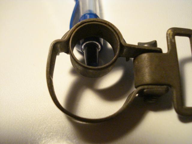

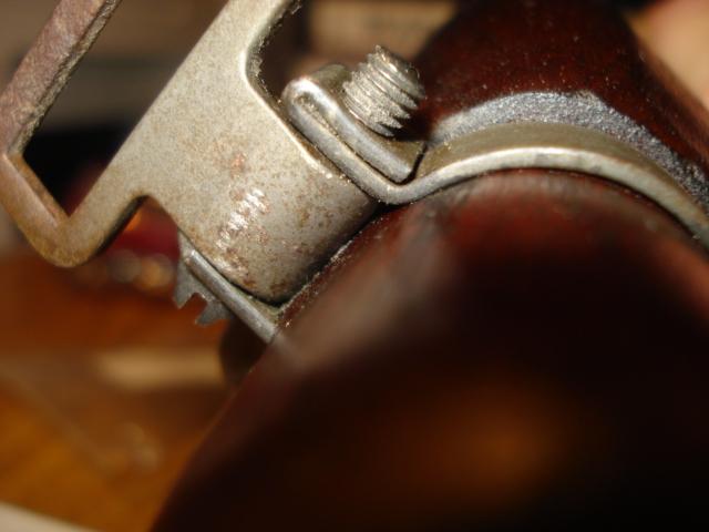

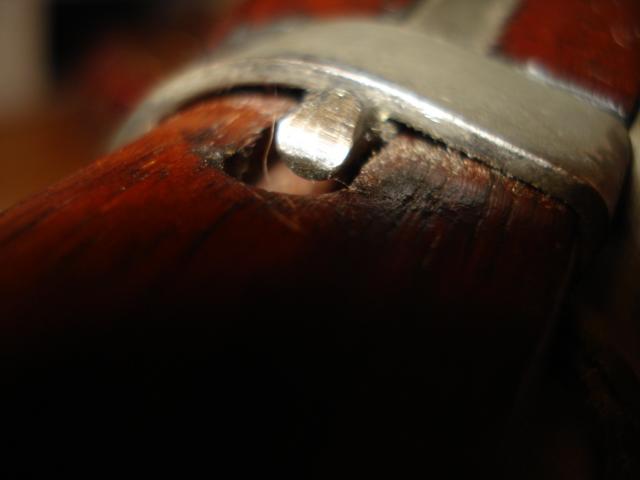

    Not going to remove my "Thanks" from Cali's post on Page 1, but I broke my repro Type 1 band (kind that comes in a white box) while squeezing it to see if it had any spring to it. Don't think I'll try this on a real one - maybe just take his word for it! This is a band I bought from Sarco for around $15 to get a swivel for a friend who needed one, and said a repro would do. A couple weeks later, I saw a guy at a local gun show selling these for $10. The screw that came in this one is so close to an original, I'm going to use is to replace a "buggered" one on an old Inland I have.
    Here's how I broke it: Squeezed a bit to see what would happen and it felt like it had some temper to it. Next, I squeezed some more (probably to around 1/4" gap) and it made a "crunch" and stayed where it was at - oops! I pulled it back apart and it went back to original, but with a fracture at one of the bends, which appears to be a lot tighter bend than on a real one. I'll attach a few quick pictures to show what this one looks like. It still has some spring to it, and not completely broken in two yet! - Bob

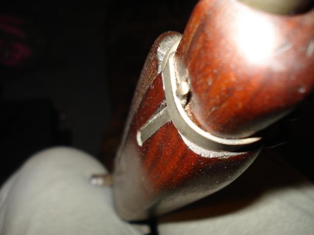

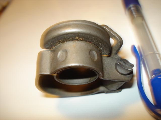

    Back to the band question: So far no one has definitively named the replacement band as a repro. The edge is the biggest issue for me. Here is the pic with that highlighted. Did any supplier produce a band with that flat edged stock for WWII carbines?
    You guys with known unmolested original carbines can solve this one for me. Do any of your prime examples have a sharp edge band around the stock or are they all rounded?
    Flying10uk: re. Looking carefully at the edge of metal there is a difference between a Laser cut part and a punched part or normal stock edge.
    What can you tell me about the edge on the right?
    ps. I love this hobby but hate humpers passing off repro/rebuilt as original. A few months ago I thought a humper was an energetic puppy.
    edit: John provided a pic of one of his originals, it has the rounded edge.

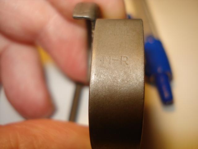

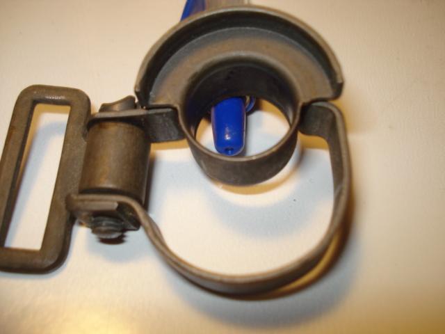

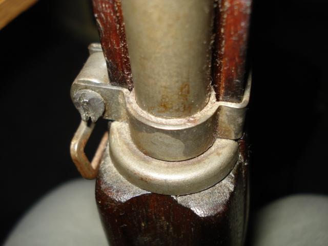

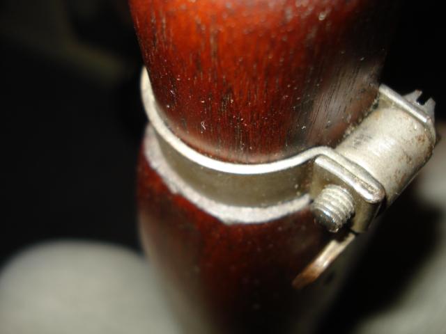

    Band on stock is WRA.
    Loose one is MR:
    Best I can seem to do today on pictures.
    I have 7 T1 bands here, all have a bit of a rounded or tapered over edge, not enough as to where they'd be a problem with hook up on the barrel band spring.
    None have as hard an edge as the one you have pictured.
    Charlie-painter777

    Quote Originally Posted by HDSledge View Post
    I would say that the outer profile of the band is punched rather than laser cut. With laser cut parts you normally get tiny tell-tail lines running at tangents along the edge where the metal has been cut by the laser beam. Punched metal will normally have a "witness" line running somewhere around the middle of the metal, visible along it's length on the edge. The picture on the right looks as if the part has been shot blasted and/or Parked and so it's difficult to see this punching "witness" mark, however, I think that it is just about visible. It doesn't look laser cut.
    The inner ring looks as if it's been made from stock material with a slightly rounded edge.
