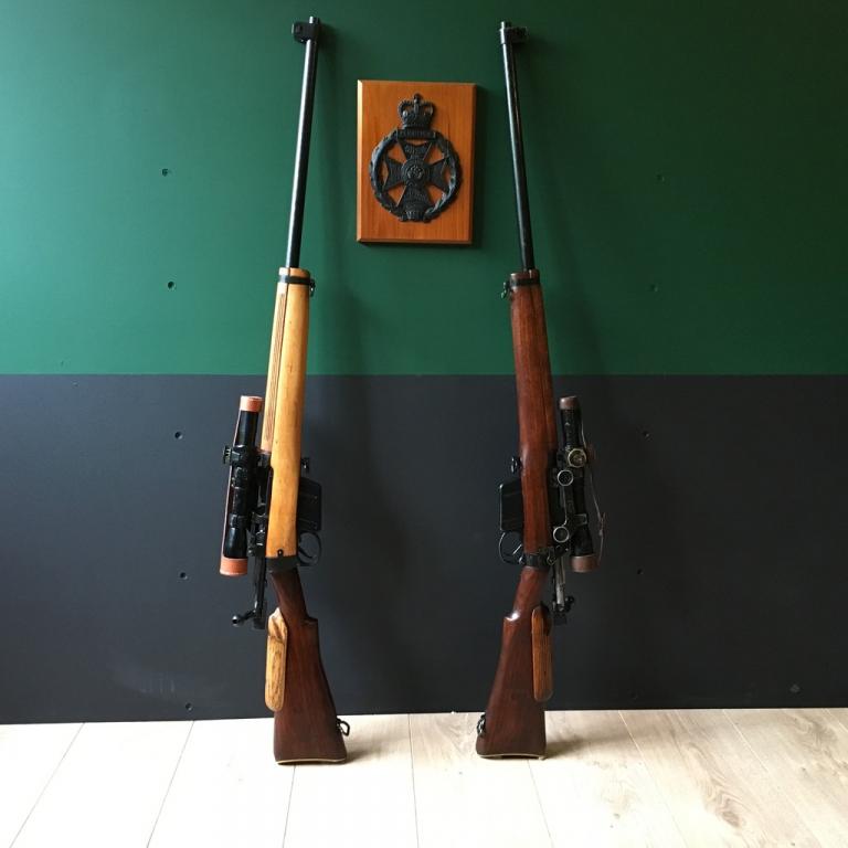

    I think the old saying "never judge a book by its cover" is relevant here. I have two 1971 examples, one incidentally has a #0 bolt head the other is marked but I cant make it out. One looks considerably rougher than the other but the performance of both is comparable. For the record the performance is gooood
    Thanks for the intel! I'm Facebook buddies with your son and have drooled over your Gurkha L42. You, Sir, have an amazing collection!
