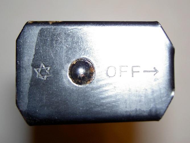

    Six pointed Star marking on Sten mag.
    While cleaning the storage grease off this Sten mag today, I noticed that it has a six pointed star marking on the casing but no other markings apart from on the end cap. I have looked up info on old threads and it does seem to have been mentioned before but no conclusions seem to have been drawn. Any other markings that may have been present could have been lost in a refurb. The construction looks the same as some U.K. made mags but I wondered if it's Israeli made or refurbished? I obtained it at a recent militaria fair here in the U.K.. Thanks for any information.
    Today @ 06:47 AM
    16,672
    06-12-2025
    02:02 PM
    66 is now known to be Lee and BEILIN which sounds like it could be a good Jewish name, although I don't know. Could this be the answer?

    The floorplate is marked with the same star on the ones I have.

    I haven't got a clue as to the origins of this mag and am open to any suggestions. I waded through a large box of Sten mags, all covered in grease, and picked out 4 that seemed like the most interesting and in the best condition. I only noticed the star today when cleaning off the grease. Another one I picked out was an Indian reduced capacity mag, although it had no internals, I will replace them.
