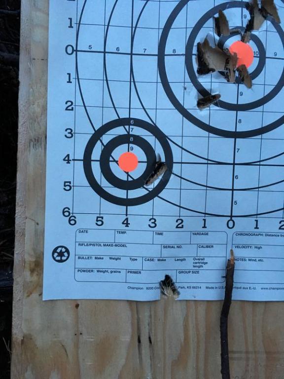

    06-12-2025
    12:43 PM
    Hello all, so I just got back from a quick day trip up to the woods and while I was there I setup a target and put 60+ rounds through the old girl, the feeding wasn't 100%, but it was pretty darn good, only rimlocked twice, and the first time was my fault. Unfortunately, the accuracy is pretty dismal. Shooting 150 grain PPU from a makeshift bench I got 5" groups at 30 yards. I had some vintage Winchester Super Speed 215 grain rounds, and they did even worse, falling anywhere from 2-5" from point of aim.
    But I still had a ton of fun, I forgot how fun this thing is to shoot! The action is wonderful, smooth and crisp.
    Sam

    I setup a makeshift bench on the hood of my truck, something I forgot to mention, it keyholed every shot. I've got some pictures I'll post when I get home
    It's definitely a p14 mag box, m17 didn't have feed rails
    Sam

    150 grain PPU
    215 Grain vintage Winchester Super Speed

    Rusty-- They group nicely!!! LOL. I think you barrel is toast at this point. The only other suggestion would be to slug the barrel and see what the bullet diameter is the slug. .311 diameter bullets probably do not work in a barrel that may be has a .314 diameter bore. The other observation I have noted on the Pattern 1914 rifles is a lot of the UKicon and Commonwealth soldiers used the pull through string thongs (not girl's panties) to clean out the bores and they seem to favor one side or the other of the barrel when holding the barrel to pull through the string thong and wear one spot on the muzzle of the barrel. I have had to slightly counterbore the muzzle to take out these wear spots.
    Cheers
    --fjruple

    Yeah I suspect so! It really didn't like those 215 grain rounds.
    I've been looking for a barrel to bend and convert to a shift lever (think old granny 4 speed shifter that's about 2ft long) Looks like I have my barrel!
    Now for the several hundred $$$ question, do I get a criterion barrel and keep it .303, or do I go whole hog and convert it to .300 Winchester Magnum?
    Decisions, decisions
    Just for curiosity sake, I took a bullet and tried to push it down the bore with a cleaning rod. The chamber end was very tight, but once it got about 8" from the muzzle there was zero resistance, then it tightened up for the last 2" of muzzle.
    Sam
