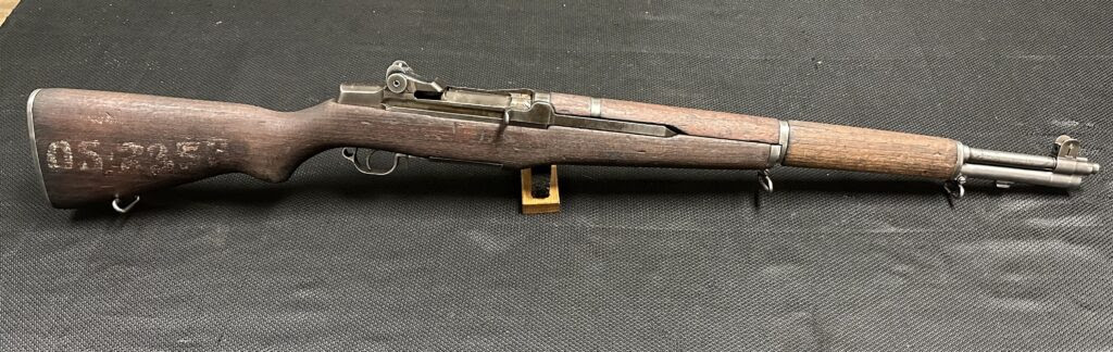

    question on cleaning
    Charlie,
    I know I'm replaying to a very old post but I've got a question. How aggressive is this cleaning process? I ask because I would like to try it on a rifle but don't want to remove the used by the Armory to number the stock.
    Just curious about how careful I would need to be around the edges of the paint.
    Thanks
    Bill

    Bill,
    When I did that stock it was a complete strip and refinish. I used a HOT stripper on it made by UGL / ZAR which probably isn't on the market anymore or what your looking for, for your needs. I've always removed the paint. Sounds like you'll have to experiment to figure out what type base the paint is and proceed from there. Tape Plastic over the stock to protect freshly stripped paint from staining the wood. Including taping neatly over the painted markings you want to keep.
    On the markings you want to remove be sure to tape a tight line along the outside border to keep any dissolved paint from seeping under in to grain beyond border lines of the letters / numbers. After stripping these letters/numbers and pulling tape you can spot treat any seepage with the Gel Strip if needed. Sometimes if the stock has a good coat of RLO or BLOicon under the paint which wasn't roughed up before it was painted it can come off pretty easy. I've had the bottom of pistol grips that were painted, that I taped around the clean wood and applied a simple stripper like a gel paint and varnish remover then covered over with plastic so it wouldn't dry out. A day later 90+ % of the paint wiped off with a small bondo applicator. Re-applied Gel / Paint Strip the same way, let set the same length and washed out with a hose or water pic. Sometimes swirling a toothbrush to help clear paint specs from the wood pores. When happy you might have to color shade the wood a bit. Then spot treat with RLO or BLOicon.
    I hope this makes sense and is helpful to you. I'm sure others have different methods, so hang on. Trick is how hard the current paint base is.
    1/8" or 1/4" Painters masking tape (hard to find) is nice to work with to tape around your letters / numbers because they will bend and flow along the outer edges without wrinkling up unlike the wider tapes. When I can't find it I use that 1 side or 2 sided sticky electronics tape. Acts like pin stripe, and will follow about any line you can imagine.
    If you get a chance post a before pic in a new thread. Good Luck
    Charlie, I think you misunderstood. I want to keep the painted-on numbers (see picture) and was wondering if the Natural Turpentine would dissolve the paint so I could figure out the best way to protect the paint when using your cleaning process. As you can see in the picture the painted numbers are worn so I was hoping to client the stock to include the areas in and around the numbers. I use Citrus Solvent cut with polymerized RLO currently to clean my stocks, which is a lot of time and elbow grease; purposely, though rather slow and safe than a ah-crap.
    Thanks again
    Bill

    Quote Originally Posted by usabaker View Post
    Yea, I blew that one. For some reason I pictured maybe some Korean markings you wanted to get rid of and the GI markings you wanted to save.
    Not knowing what type paint was used and seeing how thin it is has we worried. Any type of Turpentine will thin oil base paints and will dissolve them. Turps can be used to wrinkle up dried water based paints also.
    My current thought would be to seal the numbers 1st thing. I'd coat the numbers using a artist brush with a Tung Oil in a Sheen that would match your final stock finish. Then you'd be able to detail clean inside the numbers (carefully).
    It's about the only option I can think of to protect the painted numbers.
    If I come up with something else I'll post.
