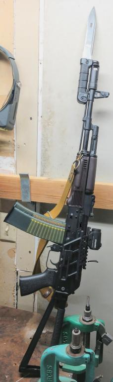

    Legacy Member gun papa's Avatar
    Dec 2018
    06-11-2025 @ 12:41 AM
    Northern Nevada
    36
    Doug petri
    07-04-2025
    09:24 PM
    Yes, they went cheap all the way.when they first came out, everyone was calling it the new gold standard in American ak's,but after about seven or eight months after its introduction, people started noticing runaway headspace and they are now known to be grenades around the 5000 round mark(5000 rounds should be barely breaking an AK in, not the death of it). I have about 4000 rounds through mine now, and started noticing headspace changes around the 2500 mark. Chipping of the locking lug shoulders mainly, and deformation on the bolt lugs. Several American companies seem to be having the same problem. I will continue shooting it as long as it is safe to do so according to my gauges, just to get some use out of it because I could never in good conscience sell it to someone else that may end up getting hurt with it that would not take the care or time to gauge it. So I'm stuck with it. But at least I have a couple comblock examples that run like a clock so I just chalk the American example up as lesson learned
    It's actually my Wife's rifle, at least what I tell her.
  13. Thank You to gun papa For This Useful Post:
  14. #18
    Oct 2018
    Tn
    671
    07-05-2025
    01:24 AM
    Nice rifle gun Papa! I love the plum front furniture (unless it's a trick of the light from The flash). I've always thought it looked good on the AK platforms. And you did exactly as I did, got to have the bayonet too or it just doesn't seem right ha ha ha. It's hard to go wrong with arsenal. These rifles can take a beating and keep right on chugging along
