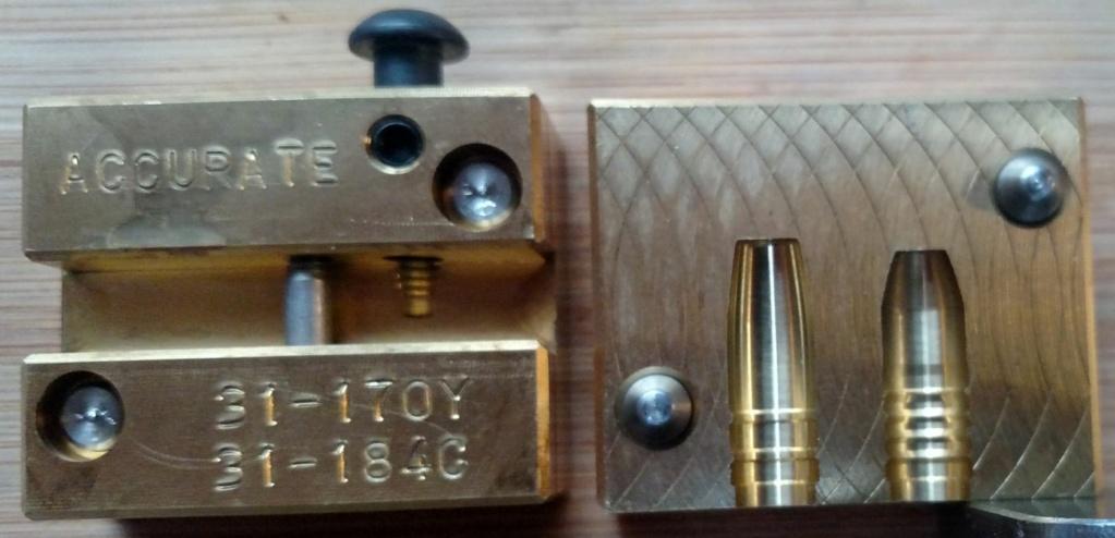

    Quote Originally Posted by Jonzie View Post
    With the prices of powder and availability I have been thinking about casting some of my
    own rifle bullets and using some of the Red Dot that I have plenty of.
    I want to try the Lee C-309-150-F and C-309-170 molds, in Lymans Casting Manual
    The Red Dot (and Ed Harris's previous "the load" that used 2400 instead) loads mentioned have a pretty good probability of being a powder/charge combination that will deliver within your rifle's grouping capability with cast bullets. And Lee is a pretty inexpensive first foray into moulds. Ed Harris over on the CBA forum uses one of Lee's designs for one of his target cast bullet loads in his No. 4 Mk1.
    Some other considerations to consider and act on (or not) as you prefer:
    One of the biggest factors in what you get for grouping ability out of your rifle, particularly milsurps, is how well your loaded cast bullet (regardless of manufacturer) fits in the ball seat/lead. A bullet that somewhat replicates a bullet laying in the bottom of that area when chambered rather than a near contact fit leaves a lot to go wrong before the bullet ever gets into the rifling. Slugging the ball seat/lead, getting the dimensions, and then adjusting things so your cast bullets of choice are a close fit does a lot to enhance the possibility of success. You only have to figure it out once, and then just replicate that afterwards, just like figuring out the right powder and weight combination for a load.
    In my opinion, time spent getting precise measurements for your ball seat/lead and then making adjustments so that your seated cast bullets closely match that is time that will probably pay dividends.
    Particularly where milsurps like Lee-Enfields are concerned.
    Equally particularly, any rifle with a well worn or mediocre barrel: unlike over the counter jacketed bullets, cast bullets can be at sizes that specifically match your chamber and barrel. I have an 1895 Winchester that does indeed have a chamber in 30 U.S. - but the barrel has bore and groove measurements that make you think somebody back when it was manufactured took a barrel intended for a rifle to be made in .303 Britishicon and chambered it for a rifle intended to be 30 U.S. by mistake. Barrel is still bright well over a century after my grandfather bought it - but once I slugged it I knew why my grandfather said it never was very accurate with any ammunition he put through it. Barn door grouping ability with any jacketed bullet I tried - 2 MOA with the Lyman aperture with properly sized cast bullets.
    Second, there's a reason that baking on powder coating has resulted in an increasing number of cast bullet shooters going to powder coating versus conventional lubes. I am not sure I will ever conventionally lube cast bullets again, except for perhaps my Hawken muzzleloader - I simply haven't tried it for that yet. But Lee Enfields and Webley revolvers - all are powder coated now, despite one being COWW and the other pretty much pure lead. One advantage is that looking for the right hardness window is less critical. Not irrelevant, but a much larger range of BHN values that work.
    Finally, unless the value Lee moulds give you everything you hope for, investing in a custom mould with dimensions cut to specifically match the dimensions of your ball seat/leade is often money well spent. Accurate Moulds is my go-to for services like that, but other mould makers will do the same. Accurate guarantees tolerances of +/- .001" on the dimensions you specify your bullet drop at with your alloy of choice. So far, my accurate moulds drop bullets that are closer to being +/- .0005". That difference can be just as likely due to slight temperature differences (although I use a PID to control alloy temperature at the bottom pour spout), or just one batch of COWW alloy versus another.
    And if you decide you hate your Accurate mold and want to sell it, you will find them easy to sell and at a pretty good price. Ditto the other custom mould makers.
    Bullet Design Catalog | Accurate Molds
    You pick the bullet design and weight that you think meets your needs, and the mould maker alters the dimensions you wish changed to your specifications, to drop bullets from the alloy of your specification at the size you specified. The moulds Accurate have cut for me have dropped right to the thou with COWW, exactly matching the specifications of my order. You can even order two (or three) different mould designs in the same set of mould blocks, allowing you to try two or more different designs (or mould dimensions) in the same set of mould blocks for only slightly more than a single design. Tremendous number of options available.

    Rick thank you for the helpful info. sounds like I have some studying to do I just received a book from Cast Bullet Association Its Cast bullets for beginners and experts 3rd edition vol. 1 & 2 .
    Its a good time for me to read since the summer heat is here . Thanks again for the help its appreciated
    Richard
