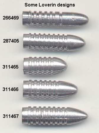

    Here are some Loverins in common vintage military diameters. All of them can group very will with the right alloy, load, and lube. Seems a shame to muck them up with tape - but maybe they aren't intending the common plumbers' white stuff.
    In the USAicon, used blocks can sometimes be found at reasonable prices since these were quite popular moulds not too long ago.
