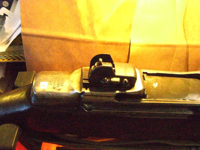

    Whats the Serial Number ?
    Is there no sign of PMC stamped on the rear of the receiver ?
    They (Plainfield) quit putting markings on the rear at serial # G990:
    Plainfield Machine Company
    In the Catalog/Flier section it states that their carbines were available with receivers tapped and drilled for 'Side Mounted' Over Bore scope mounts:
    http://www.m1carbinesinc.com/plainfieldflier1966.pdf
    Depending on height:
    Can you use the Rail that was on it and fix a Rear sight to it, like the one BAR linked for you ? Or maybe be able to use that Sight in the holes already there ?
    Might very well be the $cheapest route to getting a rear sight on it.
    Ruger 10/22 Adjustable Aperture Sights TSR200 - Tech Sights
    It's had to have been milled down. I'd keep the costs down, it will only be a shooter in its lifetime. Don't expect a Tack Driver.
    When you get a chance see if it has any GI parts in it.
    Good Luck,
    Charlie-Painter777
    Agree Charlie, and whoever did it did a really good job.

    I used a Weaver T9 rail for a 10/22 and the screw holes matched up for a Bubba M1icon Garand. The TSR200 sight was a perfect match.
    Dave

    This may be an odd reply , but prior to dumping money into a free carbine that is a "Plainfield", be sure it fires. I had one that fires single rounds, but do a string of 3 and it jams. Problem was a soft receiver with wear to the notch and the bolt out of headspace. This was many years ago prior to our CMPicon getting a hoard of real M1s. I sold it to a guy that wanted the USGI M2 stock it was in. Got rid of the junk. End of story.
    So as a suggestion be sure it fires like a normal GI carbine would. If so you are in good shape to dump some coin into it. I consider most commercial carbines problematic if they have wear.
