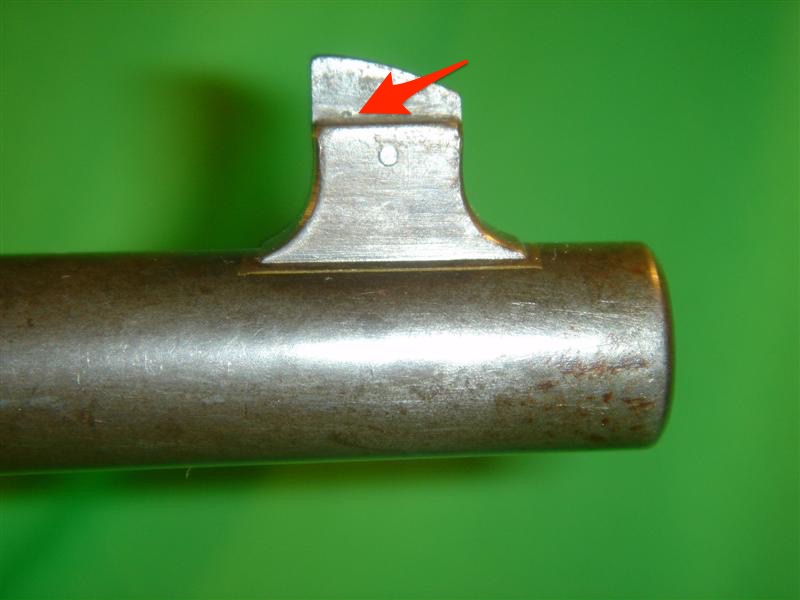

    Model 1899 Krag Carbine (Mfg by Springfield in 1901)
    33 picture photo montage
    Front (Type 1) Carbine Sight
    Visible small 'C' marking on blade part of sight.

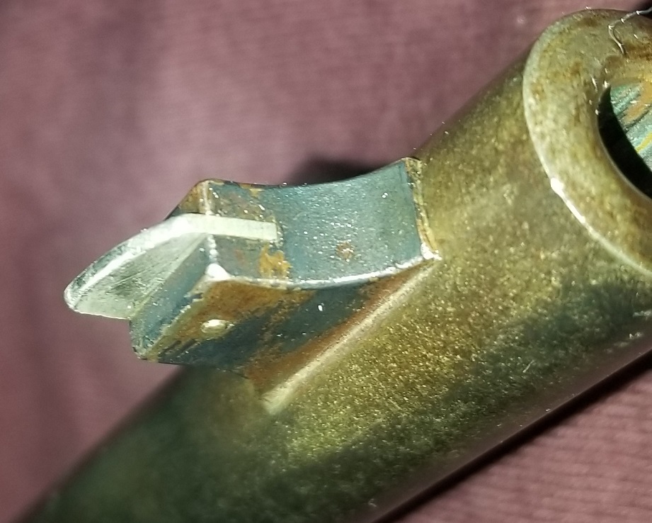

    I believe you posted another picture of your front-sight, after cleaning things up a bit.
    The front base 're-install' looks like a more skillful job than in the first photo. (Still, I believe this to be private restoration work and not original).
    BTW - I would be happy with this restored carbine as a 'shooter' and collection piece.

    The worst part of the brazing is what you saw in the first pic. The rest looks better, but still nothing like the exemplar. It's definitely it's a cut barrel and reinstalled sight, just as you said at first.

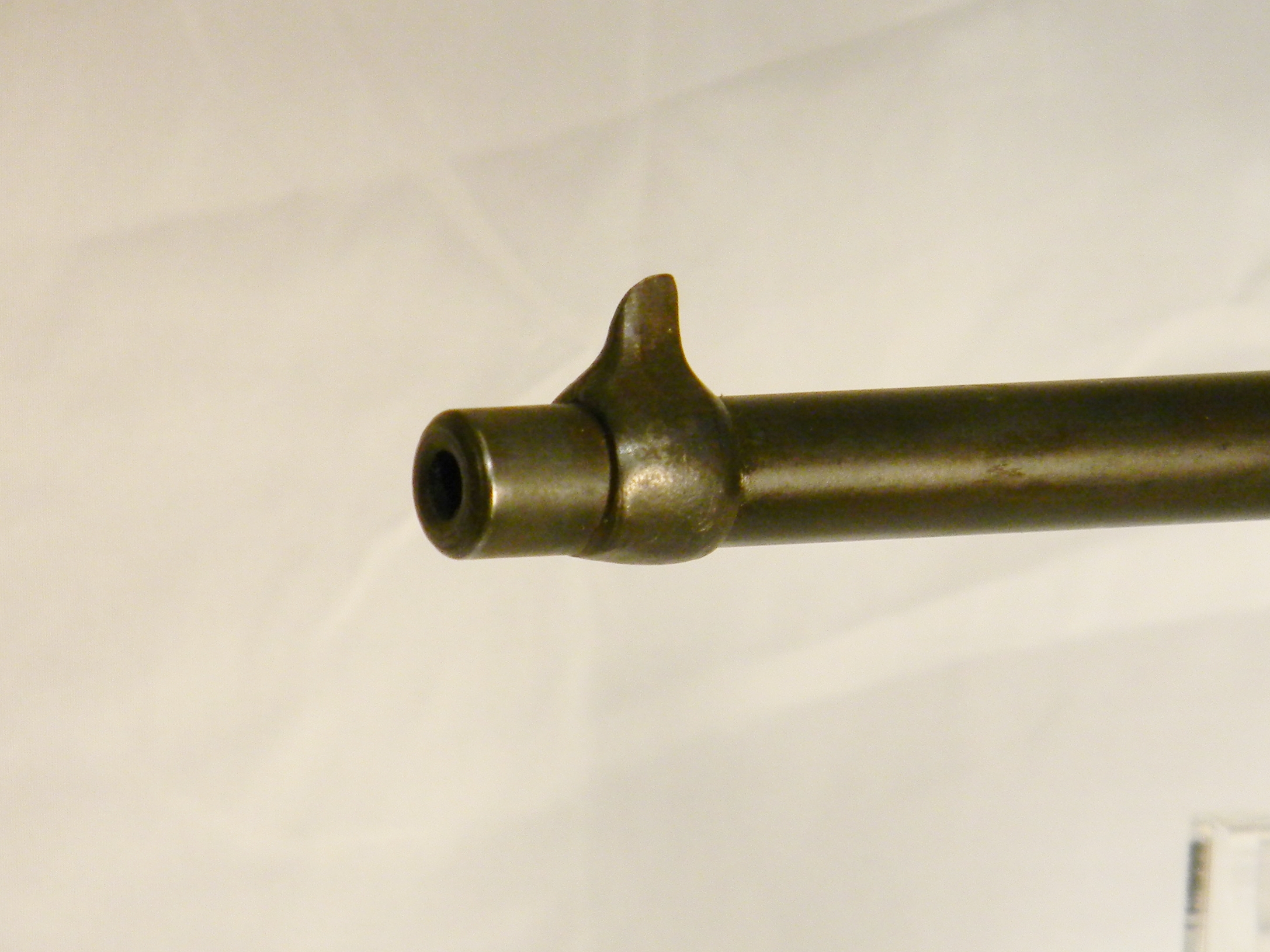

    Quote Originally Posted by butlersrangers View Post
    It is virtually impossible to replicate the original Armory front-sight base install.
    The CMPicon did a good job on mine replacing this abomination. I will try to post the after photo next week.
