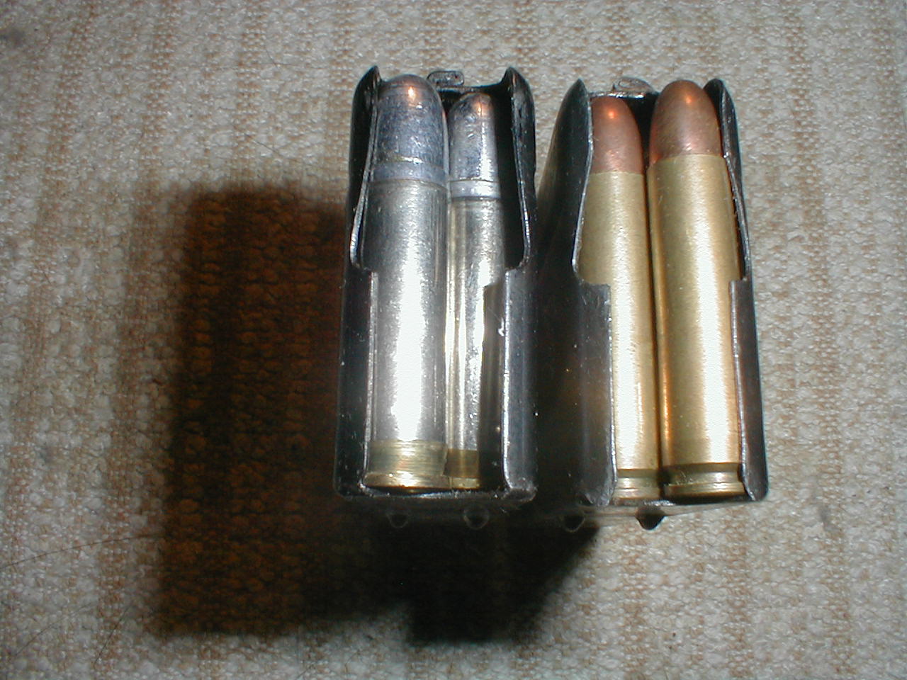

    I always wonder if US Ordnance gave any thought to the Winchester 35 Self loading Cartridge for the carbine, they did use the smaller brother, the 32 WSL cartridge. With a 150 gr bullet these fit right into a carbine magazine. this 35 WSL is nothing more than a rimless 38 special case (like the 38 AMU pistol cartridge) plus you can still get a good velocity with a heavy 35 cal bullet

    I always wonder if US Ordnance gave any thought to the Winchester 35 Self loading Cartridge for the carbine, they did use the smaller brother, the 32 WSL cartridge. With a 150 gr bullet these fit right into a carbine magazine. this 35 WSL is nothing more than a rimless 38 special case (like the 38 AMU pistol cartridge) plus you can still get a good velocity with a heavy 35 cal bulletAttachment 122613
    So we had 30.06 and .45ACP as standard infantry calibers. You really think it beneficial to adopt a third completely different caliber along with the related tooling required during a time of war?
