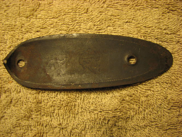

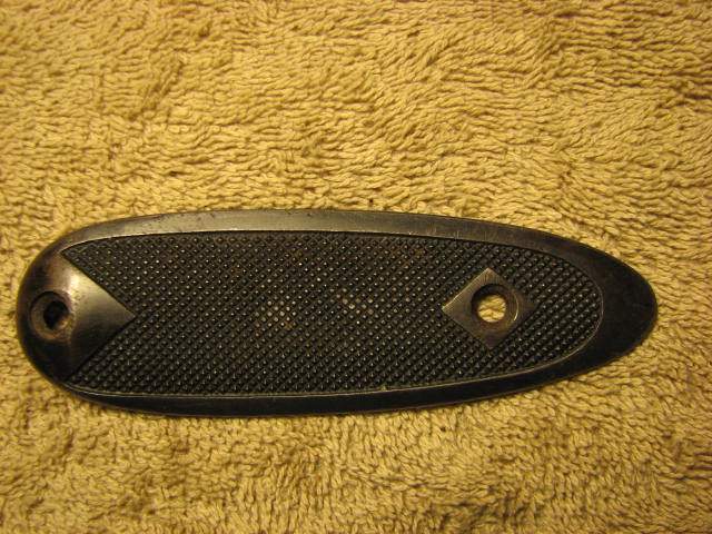

    The butt plate looks like the type used by the military to replace the original Winchester black plastic butt plates when they broke. These replacement butt plates have a widow's peak on top which requires some handywork on the top of the stock near the butt to make it fit properly. Does your butt plate have this widow's peak? The entire stock could have been replaced which may account for it not having a cartouche.
    The gun falls into the serial number range of the WW2 Model 97 trench guns. However, if the barrel does not have the 3 transverse grooves cut into the underside to accommodate the bayonet adaptor screws, then it is a riot gun barrel. That means it was originally a riot gun or somewhere along the way a riot barrel was installed on it. I would think twice before modifying the gun to trench gun configuration. You might actually be destroying its history. Besides, the W marked bayonet adaptor is not correct for this gun. Even if it was originally a trecnh gun it certainly would never have had the W marked parkerized adaptor.

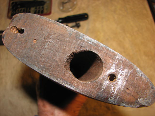

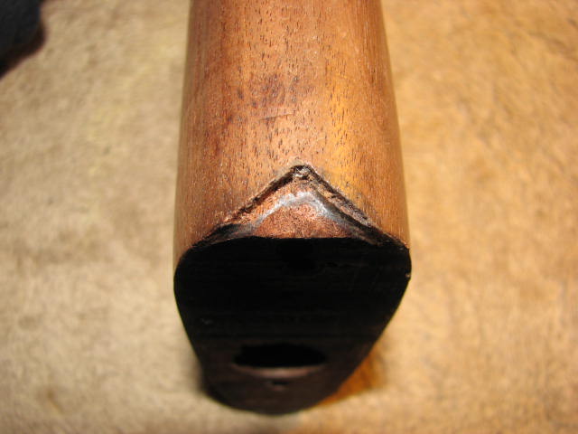

    Thanks very much for the info on the bead blasting and butt plate. The fact bead blasting would prepare the re-parkering with any damage to the surface is encouraging if i finally decide to re- finish it.
    The decision of modifying from an original Riot to Trench has had me question whether it would be proper also, and does give me pause for consideration. The reason I considered the mod was the sloppy finish and lack of confirmation of an original stock. The butt plate does have the widows peak you mention and the top end of the stock is cut out to fit it. However I removed the stock and found whoever drilled the stock missed the top hole and scabbed a small, really sloppy repair.
    If the "W" adapter indicated isn't correct for the later Trench guns do you know when it was used? Also to clarify the barrel underside doesn't have the three grooves cut for the adapter. The serial No. indicates post war manufacture of 1948 or '49 depending on the source.

    You can correct poorly drilled screw holes without too much problem and then redo them correctly.

    Yes sir, I've repaired poorly lined up drilled holes and will properly fix this one as well. I've also begun pulling some of the gun oil out of the stock and will refinish it with linseed oilicon unless it was originally varnished....not sure.
