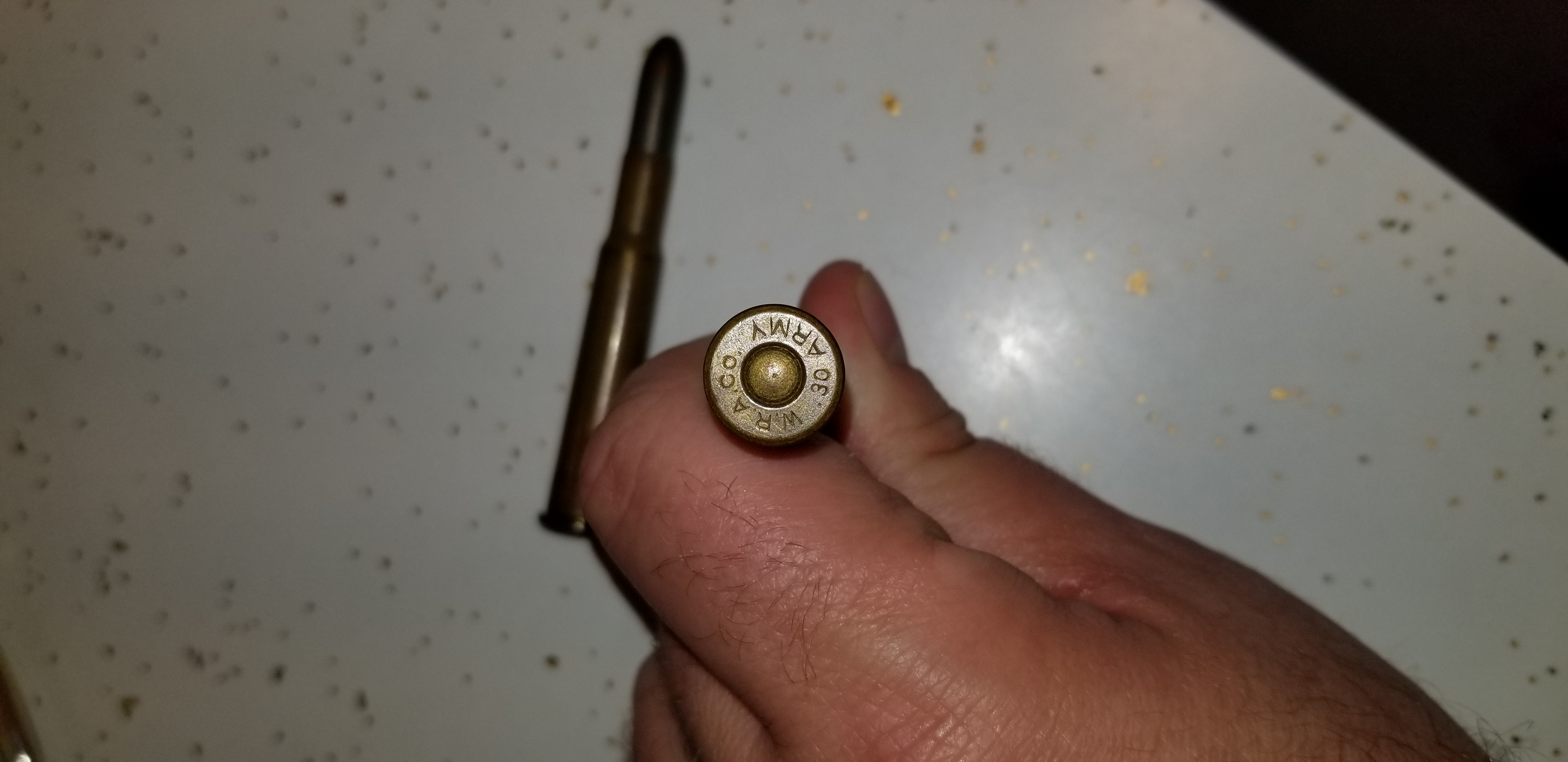

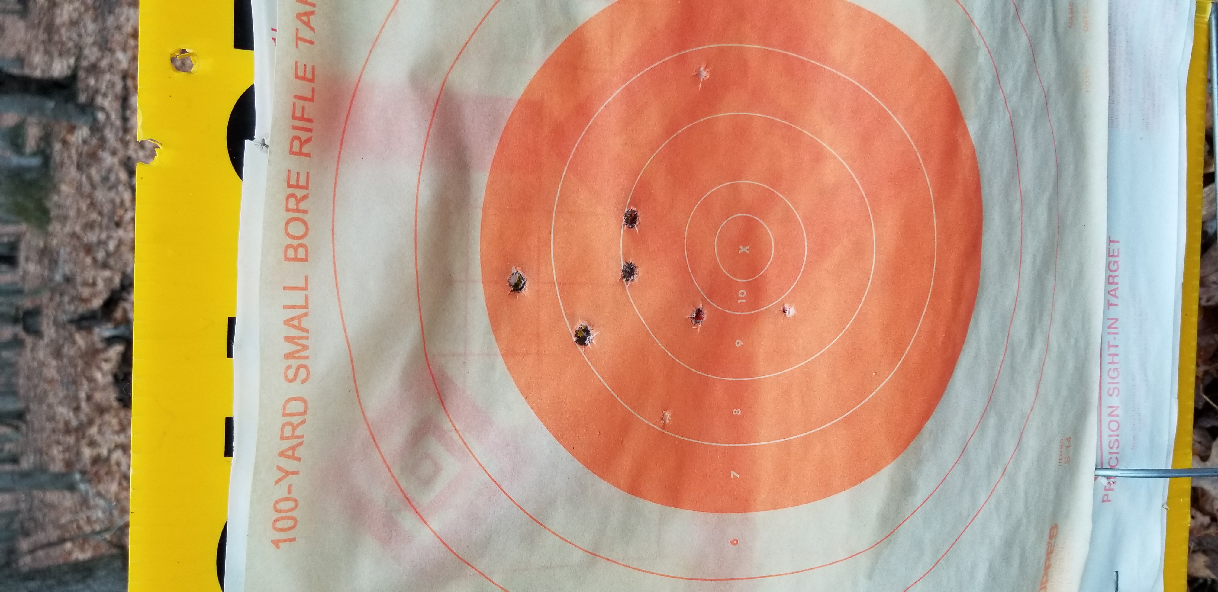

    Finally got to shoot. I knew I remembered some kind of round-nose in the multi-generational family ammo heap, but the rounds I was thinking of turned out to be 6.5x55. It's a big heap, tho, and in the back of a drawer I found exactly two rounds of .30 Army.
    Looked from google like that headstamp was between 90-110 years old so I kept looking. Fortunately a buddy came up with half a box of Corelokts. I fired five rounds, one at 15 to make sure I was on the paper, and four more at 50. i made a windage adjustment, guess I should've just shot to group, but I think it's likely going to end up being a pretty accurate little carbine. More accurate than my eyes and that skinny little bare metal front sight blade can do, anyway. Last two were side by side above the bull.
    This was my first time shooting any Kragicon, and the action really does feel great. Fed very smoothly from the magazine. Only issue was that ejection wasn't very convincing, brass just dribbled out of the side unless I really pulled the bolt back sharply and even then didn't go far. One of these days I'll look at the ejector and spring and see what's up. I'm happy with it tho.

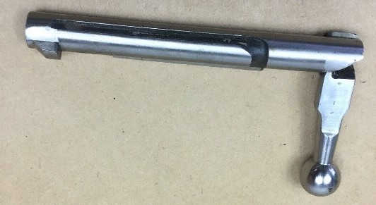

    Glad you got to put some rounds through your Kragicon. Keep the two old cartridges for your collection.
    Krag ejection is very dependent on the speed and momentum of the Bolt being pulled to the rear! There is no ejector spring on a Krag.
    The ejector just lies 'folded down' below the Bolt. There is a square-cornered groove machined into the Bolt-body that straddles a lobe on the tail of the ejector.
    Near the end of Bolt travel to the rear, the groove ends in an incline which contacts the lobe. This flips the 'hinged' ejector out of its recess, so that the tip of ejector catches the cartridge rim. The cartridge case pivots upward,
    causing the case rim to disengage from the extractor-claw and the bolt-face flange, as it flips out of the action.
    It's all in the speed and timing!

    Quote Originally Posted by butlersrangers View Post
    Attachment 123317
    OK, good to know, I figured there might be a spring in there somewhere but I see how it works. Neat. I'll hit it with my purse next time.
