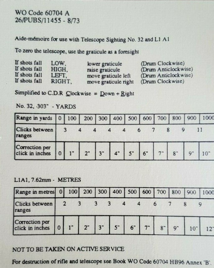

    Is this the chart you mean Warren?

    Quote Originally Posted by Warren View Post
    There is an issue chart showing the correction factors and I have one here...someplace.
    Going to get some charts made up ..someday :-)##
    Is this the chart to which you refer ?
Name:	Range Card (2).jpg‎

    Thanks guys, I do appreciate it.
    Yup, that is the chart.
    I have one someplace on my desk as I just had it out the other day and was trying to see if it would photocopy.
    I am thinking of send one along with the No. 32 scope "sight in target" I include when I return repaired No.32 scopes.
    Just a little added touch..

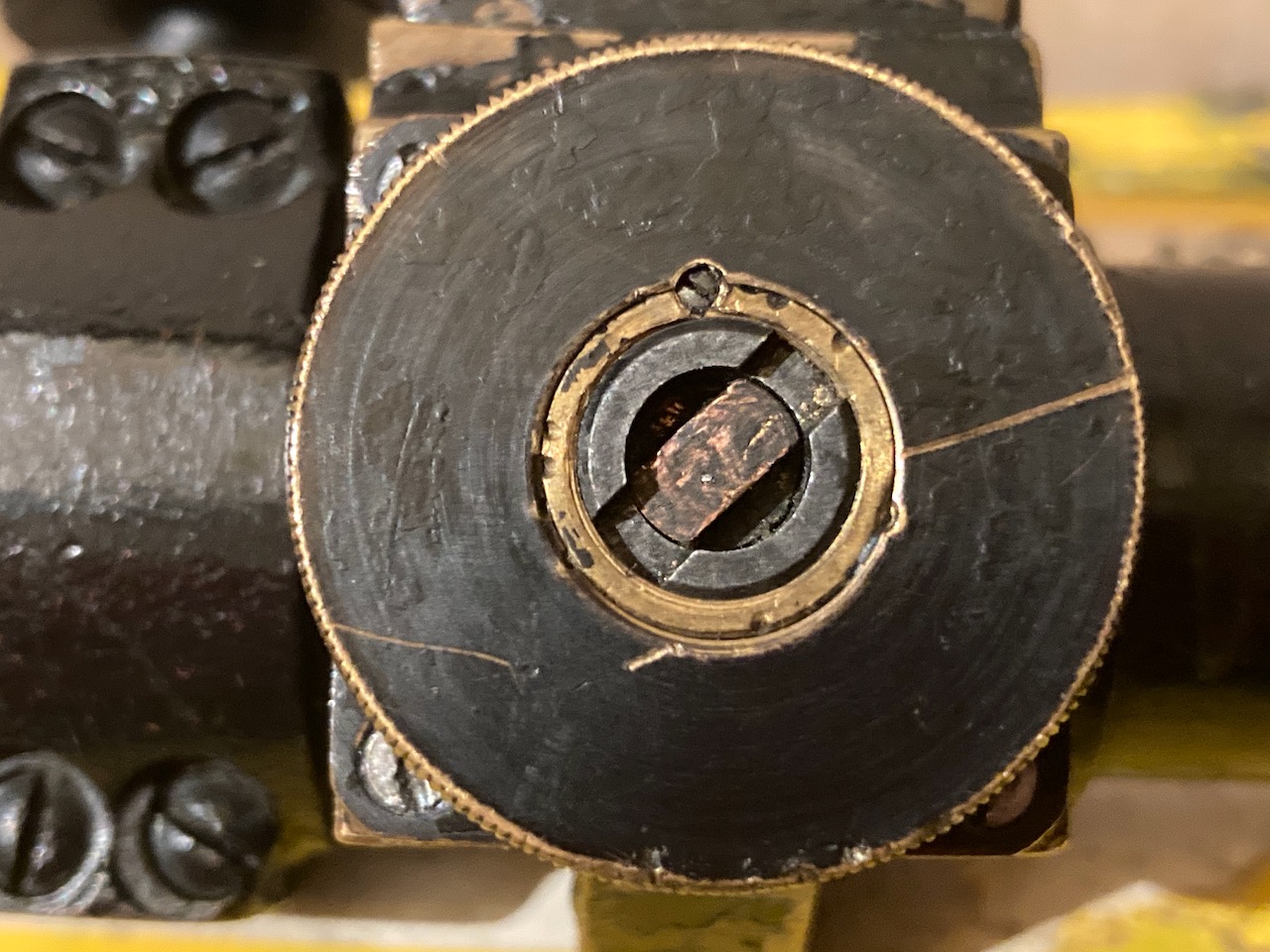

    Pictures of L1A1 scope elevation turret
    Good Day Warren and All,
    Here are a few pictures of elevation turret. Pictures have been emailed to Warren directly.
    Regards,
    Michael

    Hmm, interesting in that the BA10 locking screw is missing.
    I am finding so much hit and miss on the L1A1 scopes I am beginning to think they were overhauled in India by the lowest bidder.

    IIRC Warren, PL told me that some of the last replacement drums were not fitted with the tiny locking screw. When I fit replacements I do not fit the screw either, & they work fine. There seems to be enough 'friction' between the two parts for them not to slip.

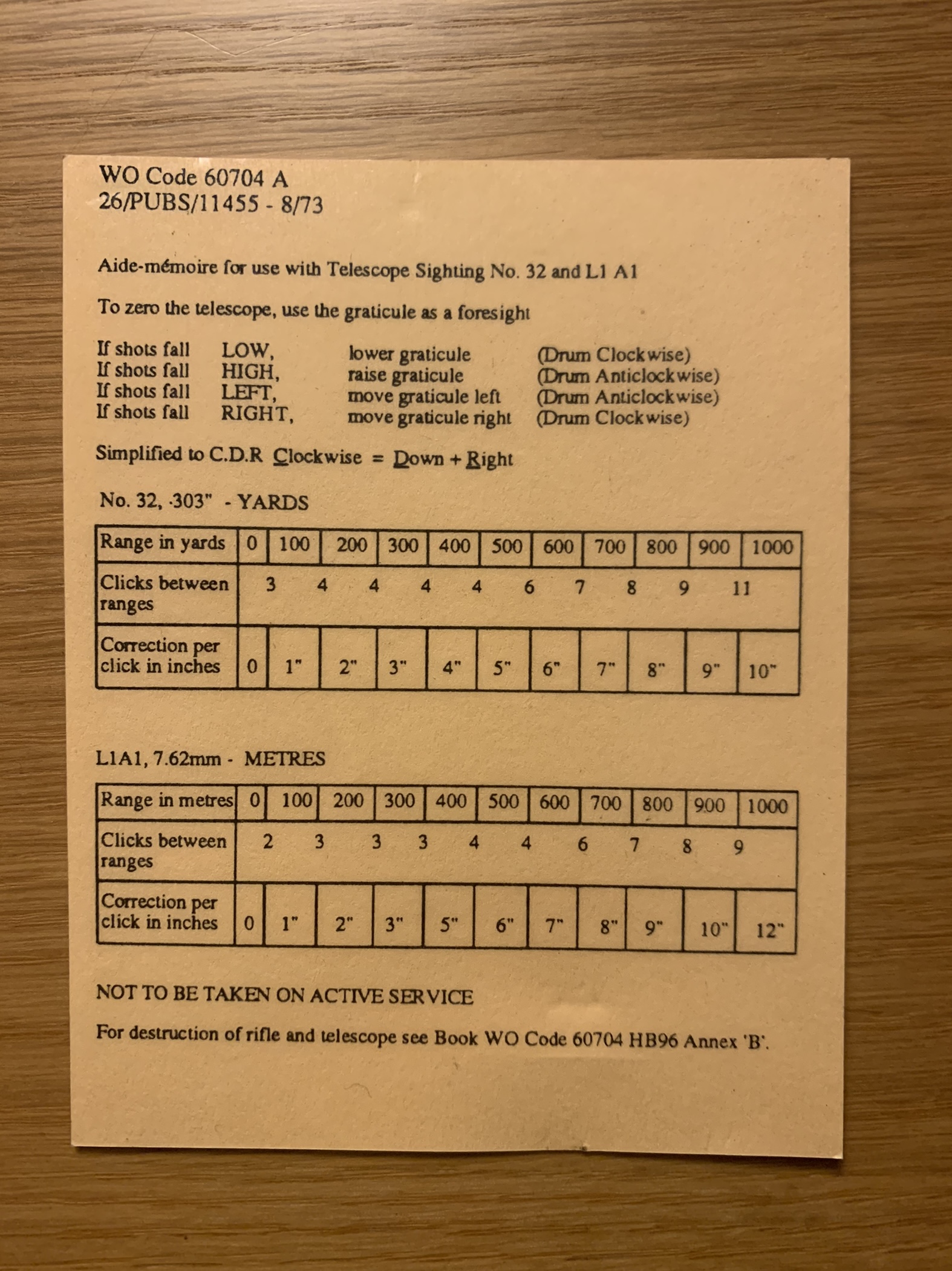

    Hi Warren
    Here's a pic of mine. For info it also has "DON/88" in white paint on it. An overhaul date?
    If you need it emailed please let me know.
    Kev
