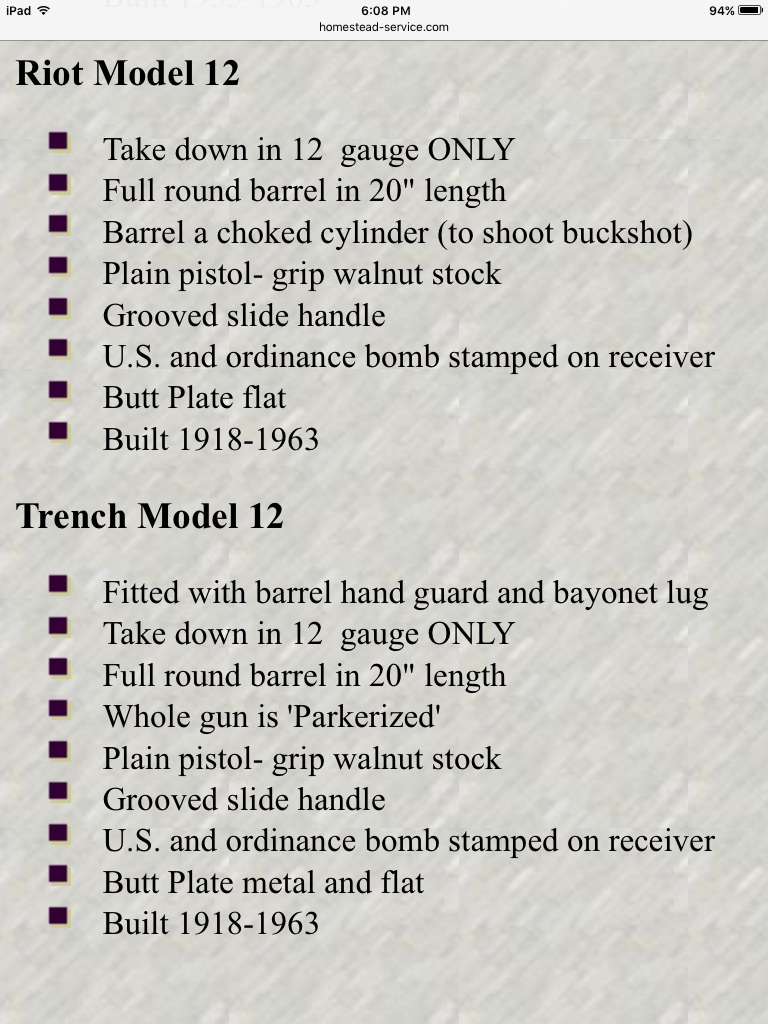

    If there is 20 inches of barrel I would cut it there and install a mount. Also I don’t think the pump handle is correct for a riot gun. Go on over to the machinegunboards forum and scroll down to the shotgun subforum. There are some sg experts over there too.

    It should be tapered (narrower towards the muzzle end). Only the Model 12 trench gun barrels have no taper.
    Had me cornfused there. OK, so original M12 Trench doesn't taper toward the end of the barrel. With this gun and Riot conversions the barrel does taper so it would requiring a sleeve if an original adapter is used.

    The barrel has enough to cut it. It would need to be cut at 20-1/2" according to East Taylor. Actually my Riot Gun barrel is 20-5/8" exactly. At any rate if I decide cut it'll have enough. Also you're correct - the slide would need replacing. The one that's on it has some nice grain but not at all the right one. This is such a sweet old gun - and probably cherished for many years. It shows excellent care and I actually have some hesitation to modify it, but if I do, hopefully I'd like to do it right.
