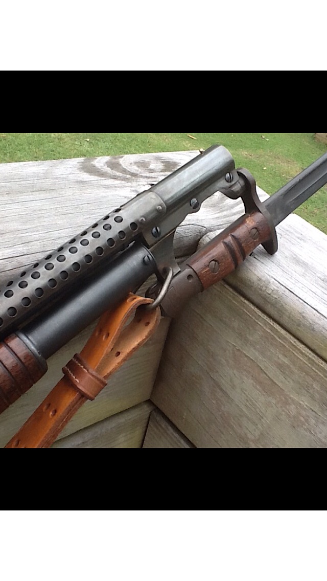

    I shortened my M12 trench magazine in order to get rid of the takedown pin holes. I honestly don’t know how the real trench guns were done. Guessing they would pull the mag tubes from the line before drilling any holes and fit the endcap with the bayonet mount pin. Any 12 ga magazine spring should work. I wouldn’t buy one thats already kinked up, get a new ss one and trim it.
