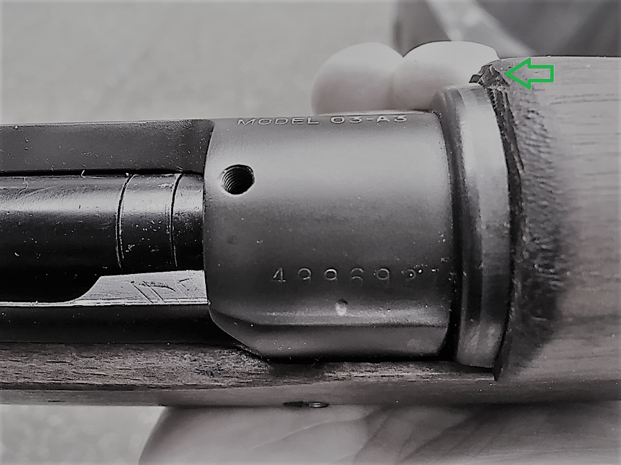

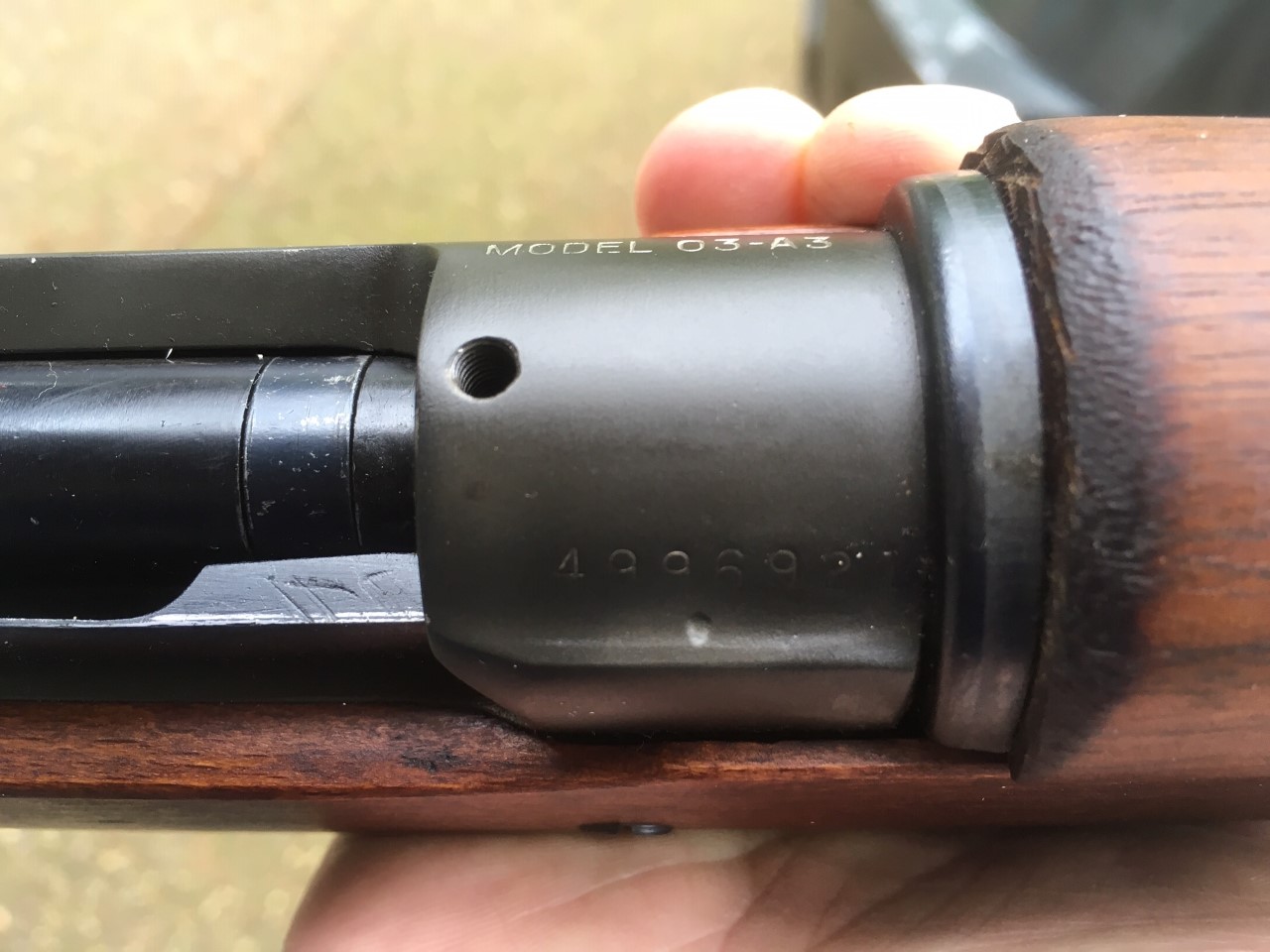

    I am amazed at the 'Bucky Beaver' trim job on this handguard.
    I cannot make out the obliterated receiver markings.
    The Natl. Ord. receivers are in the 5 million range.
    This is photo shows #4,996,921, so I guess it could be Remington?

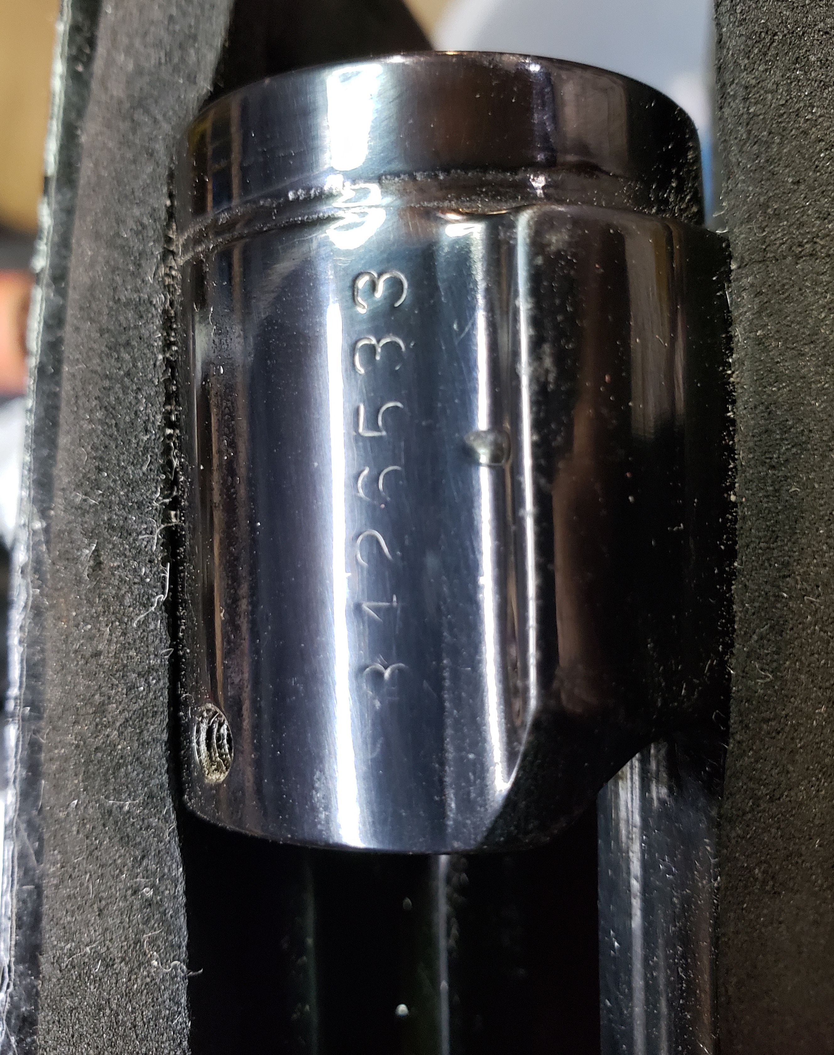

    OP's receiver appears to be a real 1903A3 and not aftermarket cast Fed. Ord.

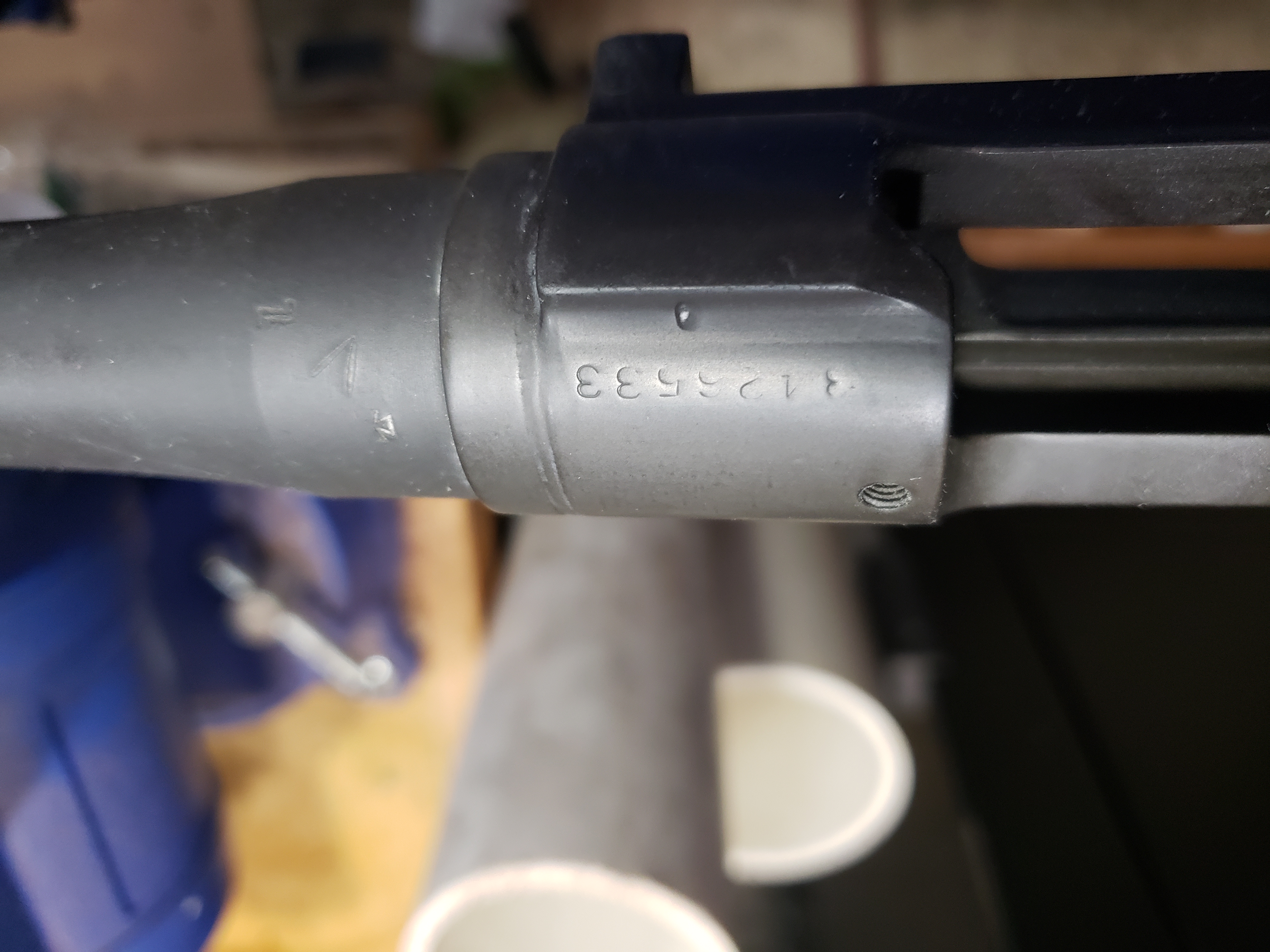

    I have an A4 that someone sporterized and I restored. The serial was likely not struck very deep, then bubba wheeled over it to blue. I had it parkerized to match the NOS barrel. light sand blasting made what was left of the serial pop. I got lucky - it still had it's original bolt, GI base and rings on it too. Also lucky I was able to buy it as little more than scrap. The cut back barrel was a real sewer pipe.
