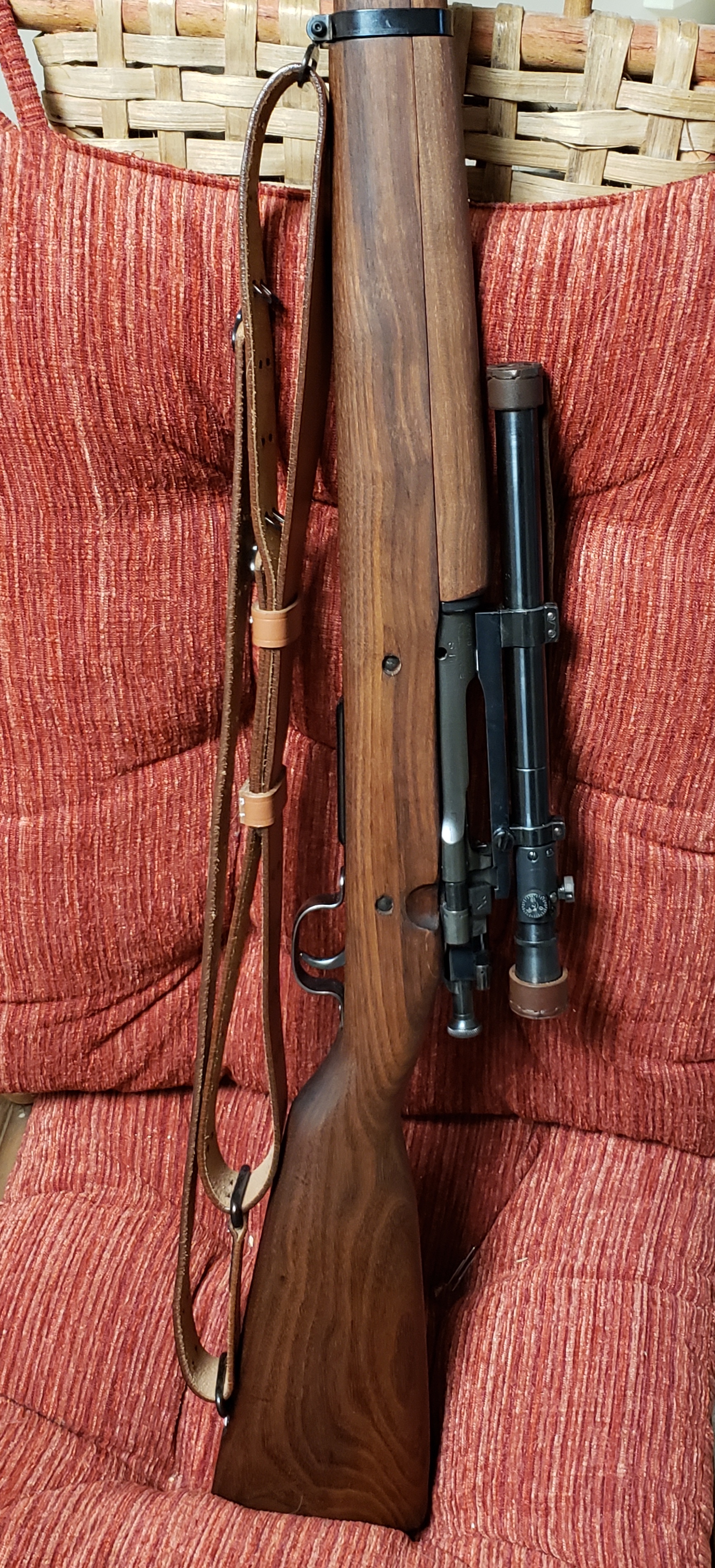

    For now, here she is all done up in her NOS scant.

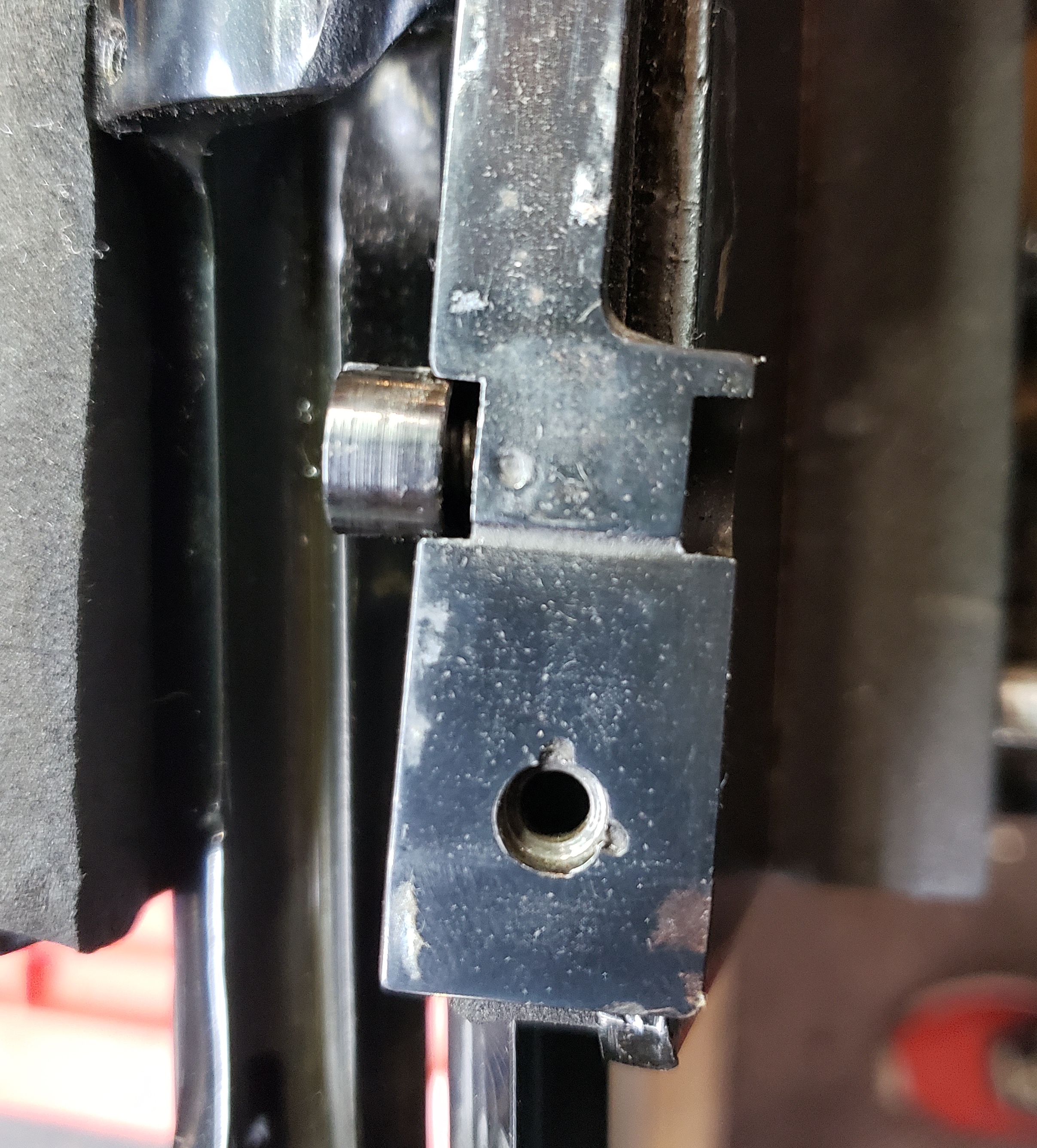

    EDIT2: found some of the before pics...rings were fancy. mount screws had been previously staked, but staking no longer intact when it got to me. Rear of the base is beveled, and marked REDFIELD in the correct spot. I found some original split top rings for it, but have not parkerized it yet - Brownells has been out of Manganese for some time now. I was going to use the scope base and rings as my first lesson. I conserved the bolt, but otherwise left it alone. Bolt looked correct against those I compared it too. The cocking piece had the knob cut off and had to be replaced. I found a NOS barrel, dated within a couple months on the later side of the expected range. If you expand my first pic, you can see some of the U.S. Remington....on the left side. I'll get some closer pics when I get it out again.

    ssgross, That is a very worthwhile project. It's getting hard to find projects like this. The bolt looks right on and I like the scant stock. I hadn't heard that Chuck had retired. Hopefully he will still share his expertise on this forum. Salt Flat

    I have all the luck! Funny I was in the middle of building a clone from an already drilled and tapped sporter when this one came along. They both shoot so darn well I can't get myself to let either of them go.
    Quote Originally Posted by Salt Flat View Post
    We are fortunate that there are still plenty of these NOS scants around. Unless one has a different purpose, these are the "correct" stock to use when overhauling an 1903 or A3 sporter back to service - the same as the arsenals would have done if a stock was too far gone to continue. I like to think of my work as just part of their service life, but with a little more love and attention to detail

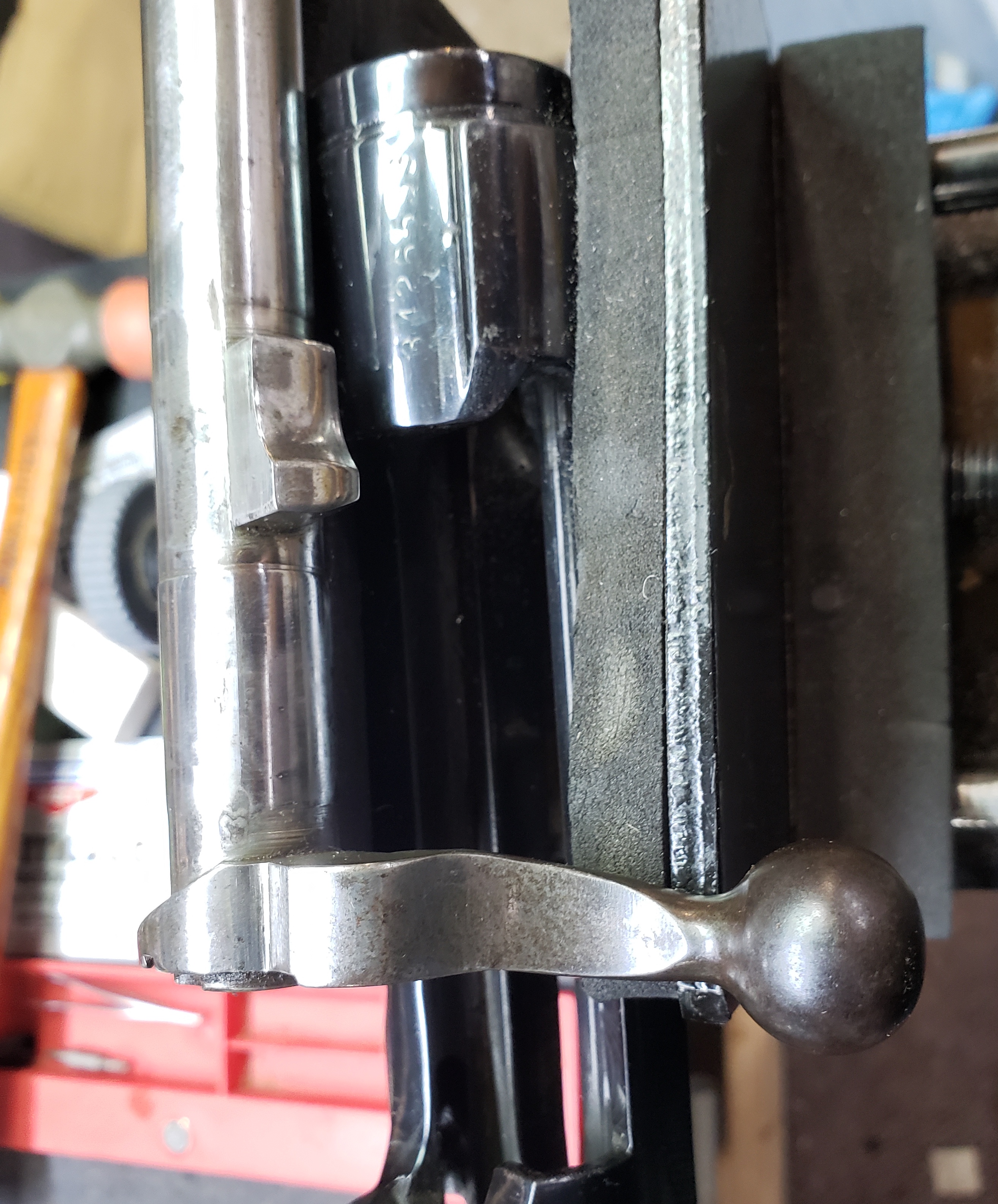

    im not retired, yet, 2 more years to go, i had originally planned on retiring 2023, but after looking at the numbers, id take too big of a hit doing it at 60, that and some unforsean Cancer with my GF, we had originally planned in moving to Gillet Wyoming this year, buying a shooting park, she has stuggled with Chemo since Aug, spent 29 days in the hospital over Christmas and Newyears.
    to add to the pictures,

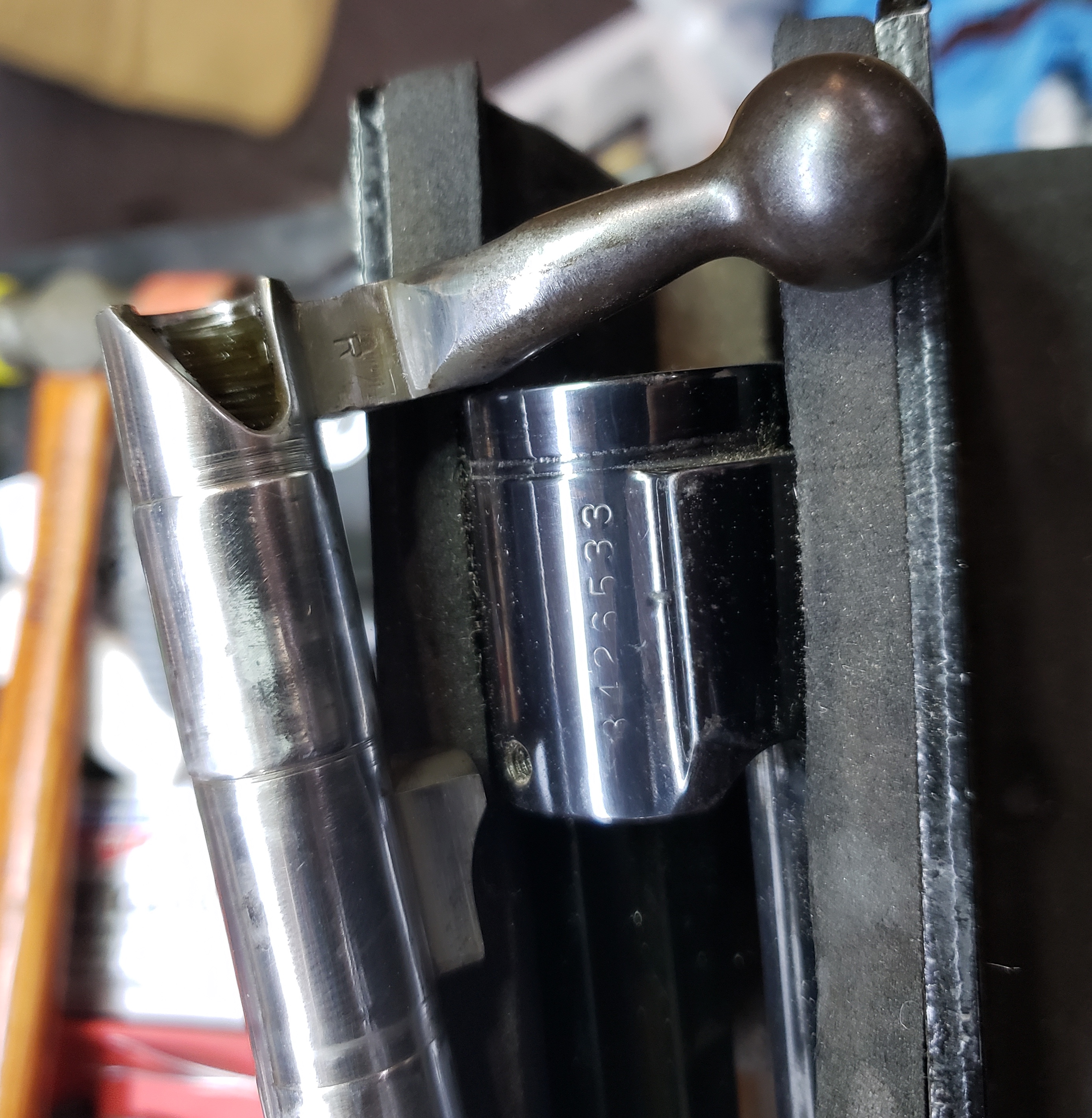

    its is a Remington A3 receiver, you can see the ghost of the old markings were the ground them off, the serial number isnt indexed, it runs under the handguard ring.. FYI: changing or altering a serial is a Felony.
    you cant tell in those pics, but the new markings were done with a pentagraph, you can see the chatter marks in them.
    no such thing as a fed ord receiver, National Ord, and Santa Fe were the 2 names of the cast built actions, yes, i have seen a few fakes built of those. to make this worse, someone is building repro 1903A3 receivers in Europe from scratch, havnt seen any in the USAicon yet,

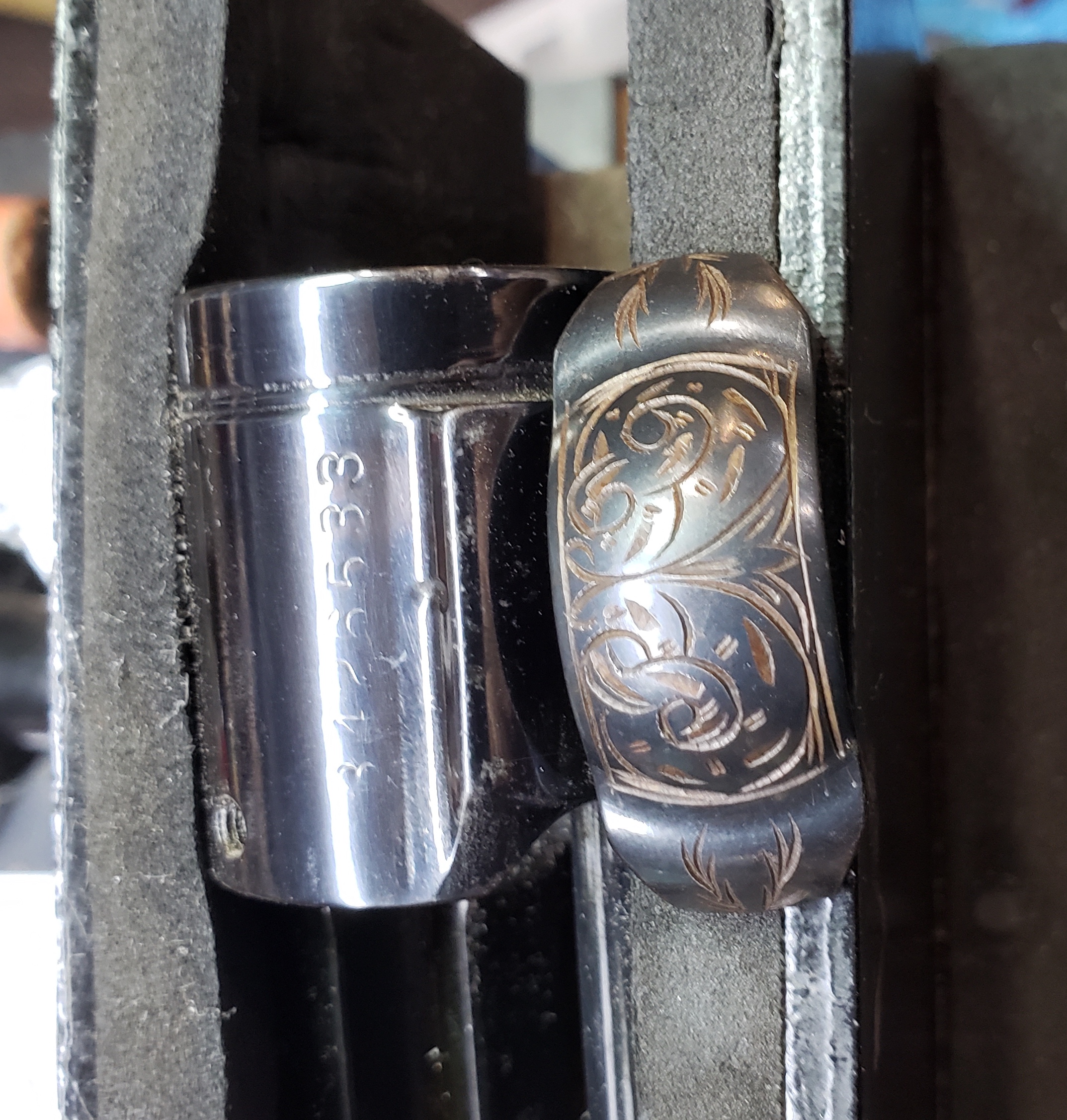

    I'm looking for a smoking gun to take back to the seller. What does "the serial number isnt indexed" mean? One or more smoking guns would be best. The hand etched model marking is one, I would presume. I'm not going to complain about the stock as I knew it was a replacement.

    indexed is not line up, straight or squared up correctly
