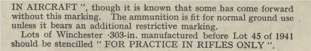

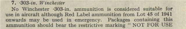

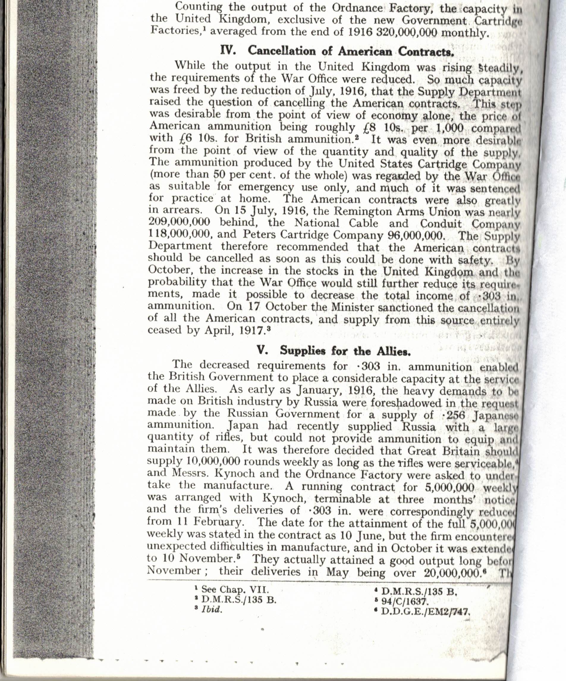

    The problem was (in WW1) that by mid 1916 the US was about 400,000,000 rounds in arrears to their contracted delivery quantities, and, about 50% of what was supplied by the US Cartridge company was 'reject' and only suitable for 'practice use'.The situation was discussed in parliament and the contracts cancelled soon after.
    In WW2, there were similar problems with Winchester supplied 303 which was banned from use in aircraft due to dimensional quality control being poor and the guns jamming - not a big problem with your LE on the ground, but not the most convenient thing to happen in the air. Some of the ammunition was so poor it was rejected even for 'ground use' and was again relegated to 'practice use'.

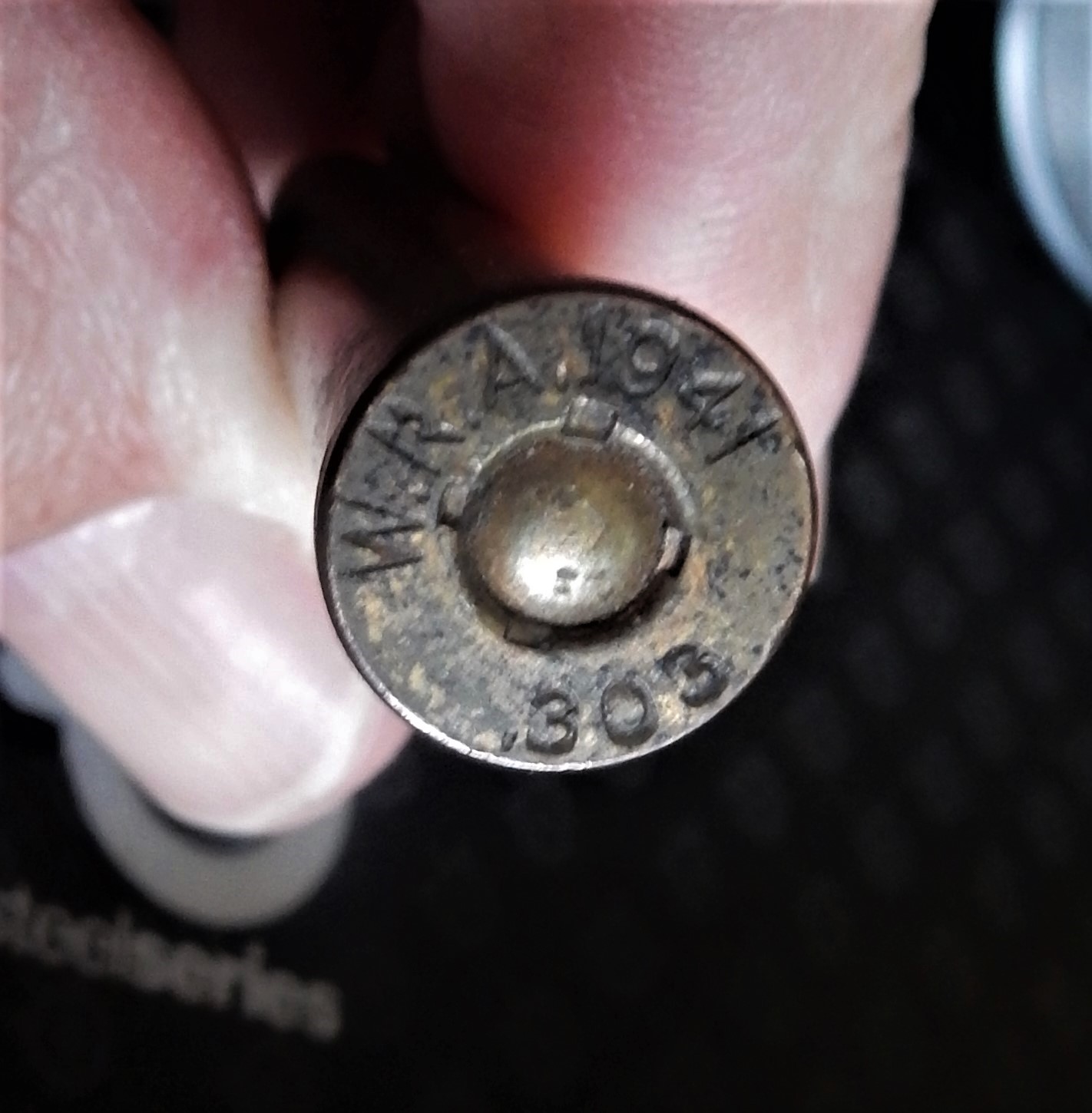

    Is this why some WRA rounds had staked primer pockets in WWII to negate the primers backing out so they could be used in aircraft.
    See pic.
    That is exactly it. There was some literature about them getting backed out and causing stoppages...proof as it were.
