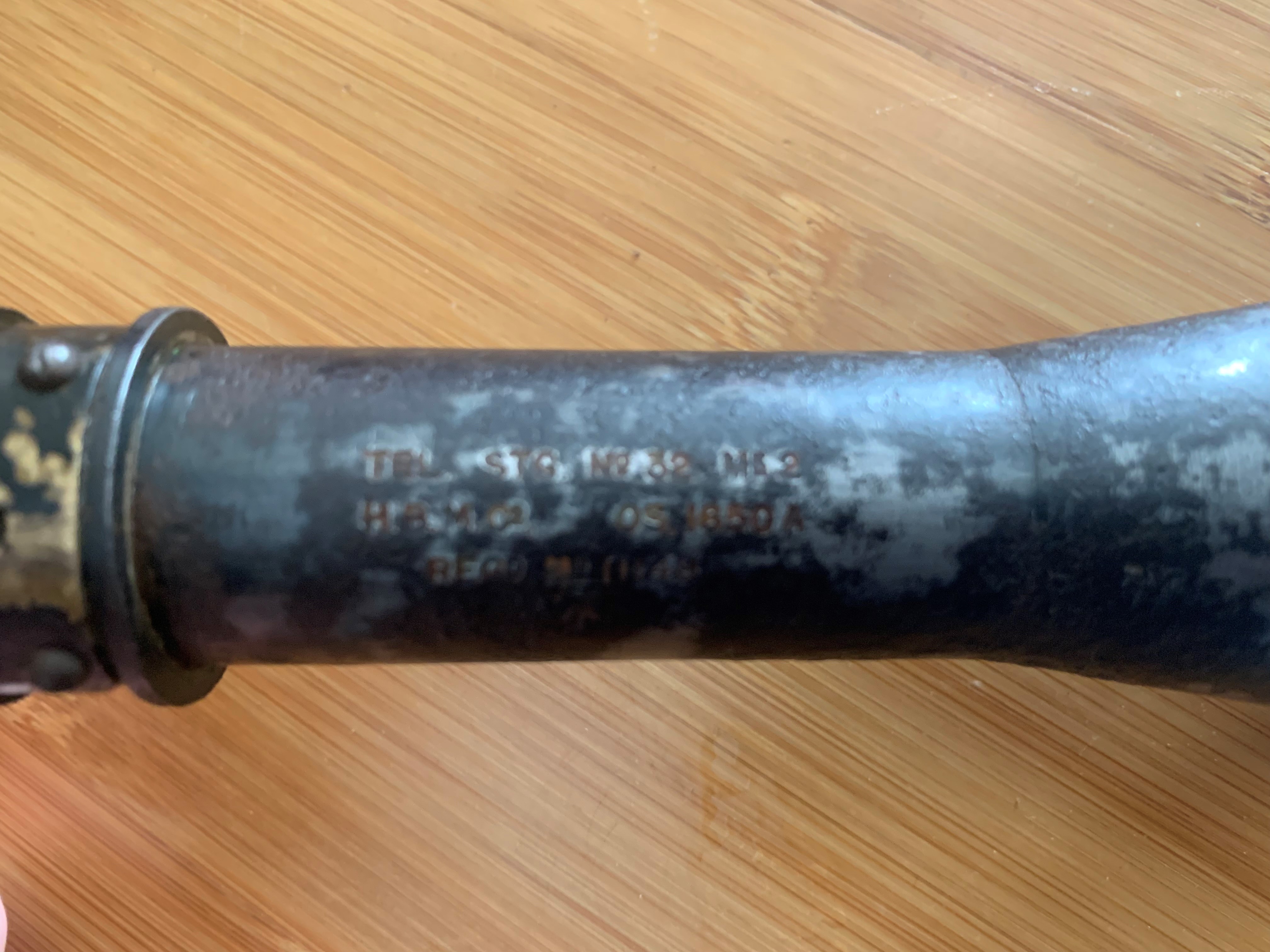

    That scope is not even HALF as bad as several of those that have come my way, believe me.
    A genuine in woorse condition than that is better than a repro, any day, I say. Just my opinion though
