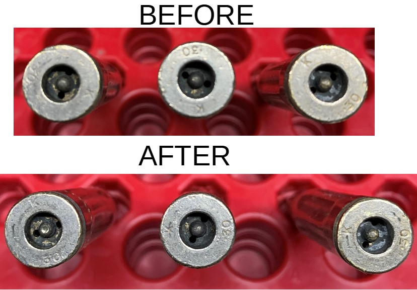

    When I got my Garandicon about 3 years ago, I already had (1) clip - so made dummies for it with mixed brass I had on hand. Here's a couple pictures taken then, before I learned that you're supposed to have the top round on the RH side of the clip. With yours, if you chambered a round and pulled the trigger could the firing pin be damaged? - Bob

    Quote Originally Posted by USGI View Post
    Absolutely not. Think how many hours Marines sat "snapping in", dry firing practice. Dry firing practice has never broken a firing pin that I've seen.

    On a dummy Berdan case with no primer? Thought the pin would contact that post which looks pretty solid. - Bob

    Someone gave me a spare Garandicon firing pin awhile back. The tip of it looks pretty "spindly" but I need to remember it's supported well by the opening in the bolt. Maybe we can get Bill to try one of those dummy rounds in his rifle, then show us a picture to see if it even leaves a mark on the post (anvil) in the case. - Bob
    Bob, everyone is right and wrong ... I chambered three of them. Looks to me like the firing pin did not hit two of them but did hit one severely. So I'm guessing the answer depends on how high the anvil protrudes. Here is a picture
