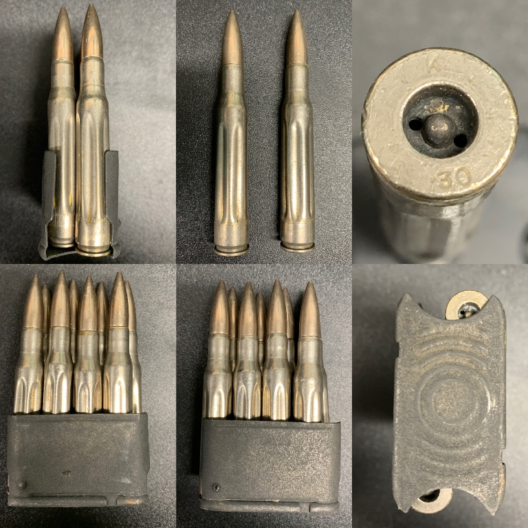

    I found two full En Bloc's with what I think are Danishicon military M 58 Berdan style cartridges. Pretty cool...

    I've got a couple like that those have regular primers that are low-load prison rounds.

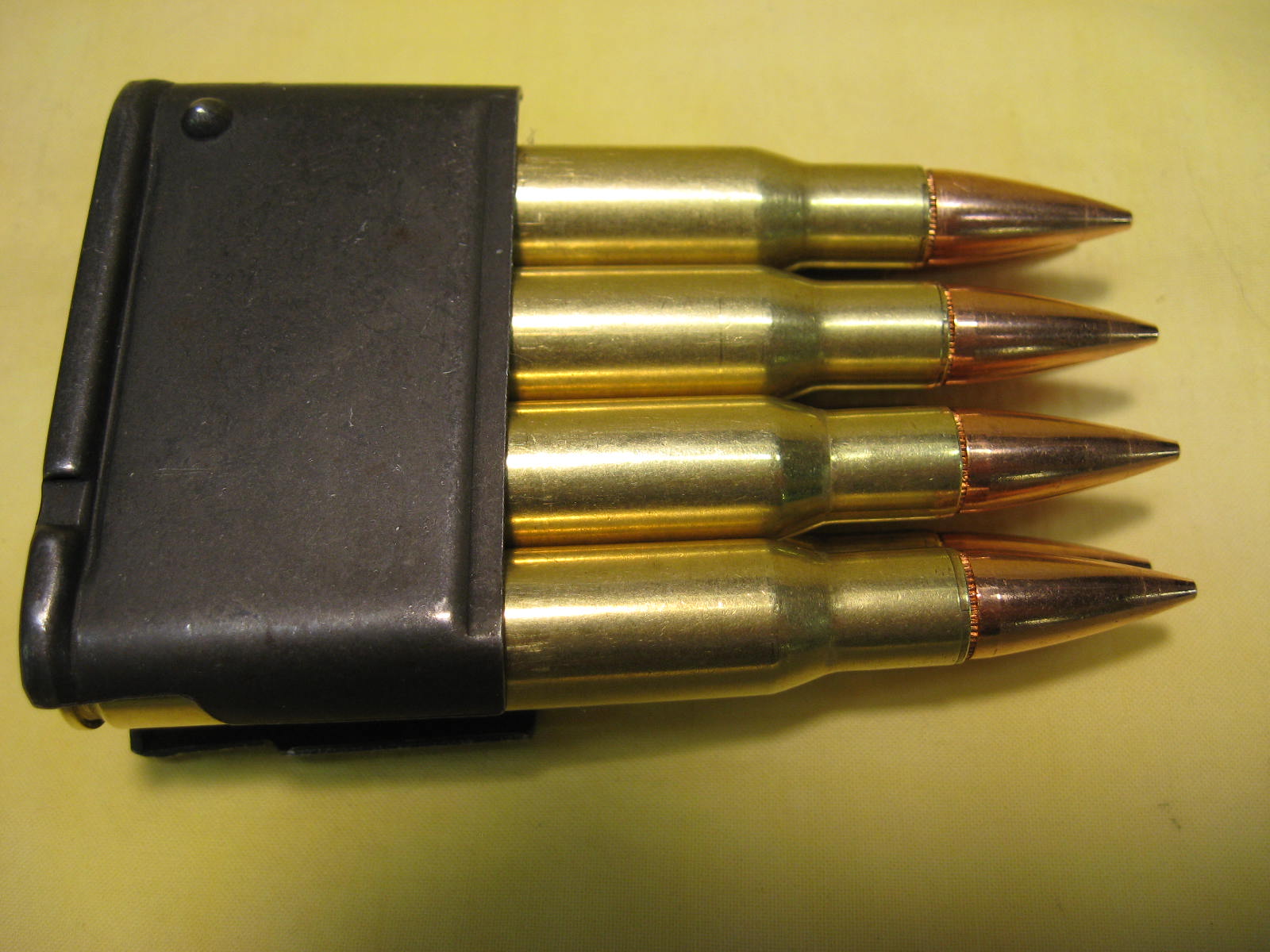

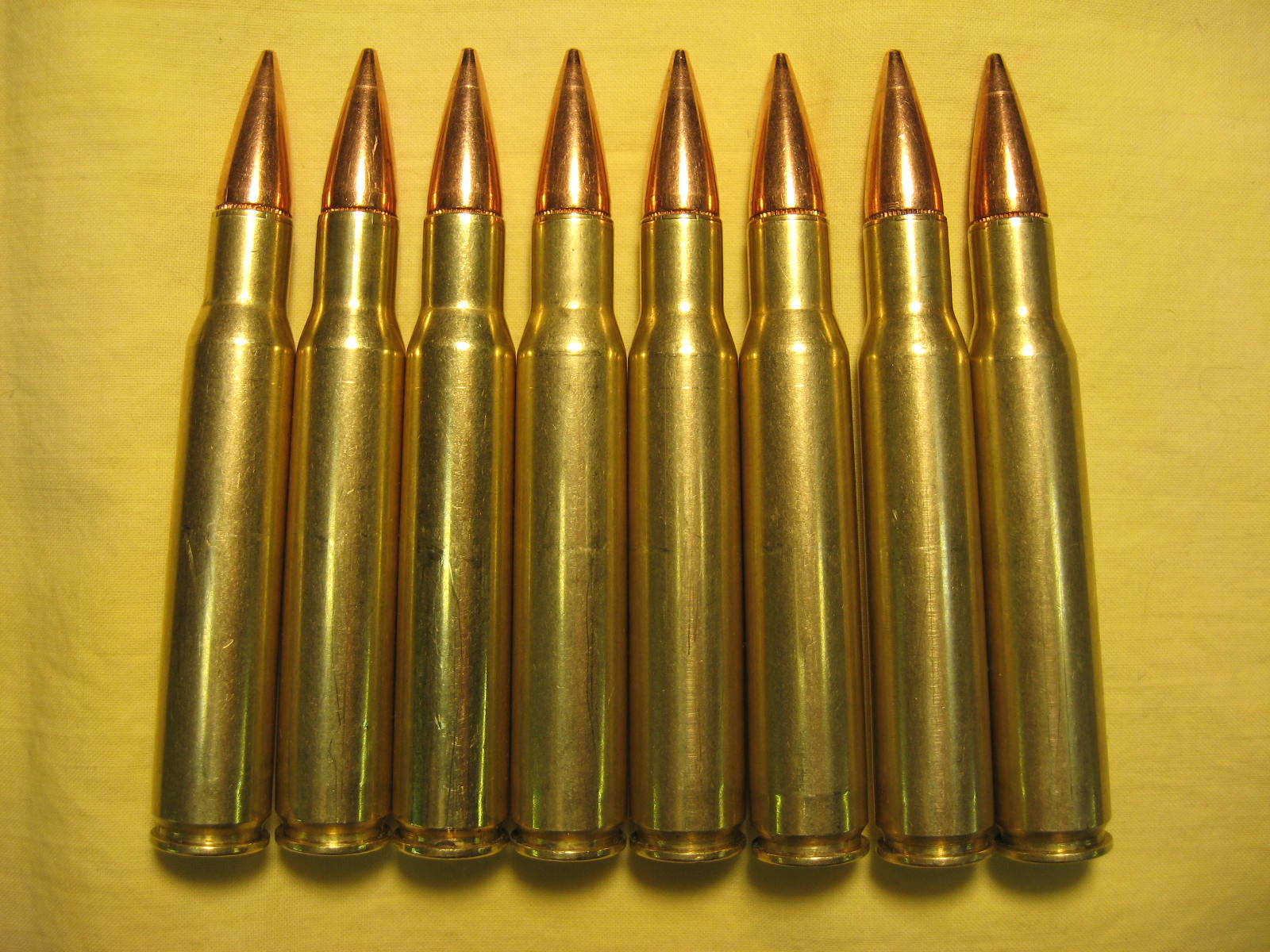

    When I got my Garandicon about 3 years ago, I already had (1) clip - so made dummies for it with mixed brass I had on hand. Here's a couple pictures taken then, before I learned that you're supposed to have the top round on the RH side of the clip. With yours, if you chambered a round and pulled the trigger could the firing pin be damaged? - Bob

    Quote Originally Posted by USGI View Post
    The En Bloc's with the cartridges is exactly how I bought them. I've not messed with them at all, I jut thought they were cool and have them sitting on display.

    You know, before I acquired my Garandicon I spent months, actually years, studying the Garand. Once I got it, I loaded up a bunch of clips and went to the range. Only then did I discover that a high-left loaded-clip wouldn't feed! When I asked on the Internet, the only source of info on it was word-of-mouth. I was utterly amazed.

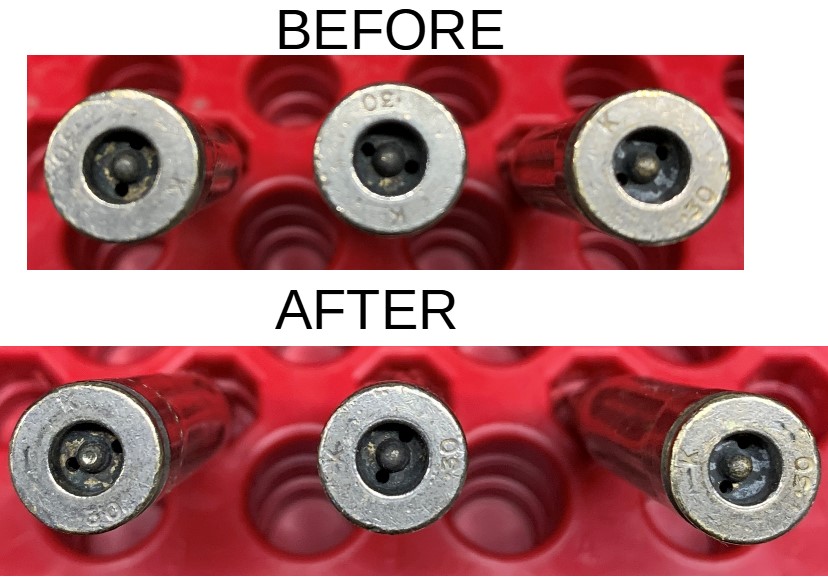

    On a dummy Berdan case with no primer? Thought the pin would contact that post which looks pretty solid. - Bob

    Someone gave me a spare Garandicon firing pin awhile back. The tip of it looks pretty "spindly" but I need to remember it's supported well by the opening in the bolt. Maybe we can get Bill to try one of those dummy rounds in his rifle, then show us a picture to see if it even leaves a mark on the post (anvil) in the case. - Bob
    Bob, everyone is right and wrong ... I chambered three of them. Looks to me like the firing pin did not hit two of them but did hit one severely. So I'm guessing the answer depends on how high the anvil protrudes. Here is a picture
