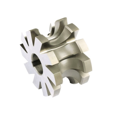

    It would be interesting to know how they machined that rad on the original brackets, whether a milling machine was used or perhaps a shaping machine.
    Probably on a mill with a form cutter--

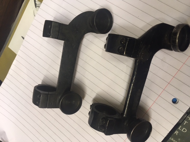

    Yes, both Rose Brothers & Dalgleish brackets have cradle clamps that are only cleaned up where needed, & are definitely of two distinct patterns. As it happens a Black & Decker belt sander just gets in nicely on both! I did it approximately 650 times over thirty years on my reproductions (in fact 650 x 4 I suppose, as each bracket has two cradle clamps each with a left & right side).....

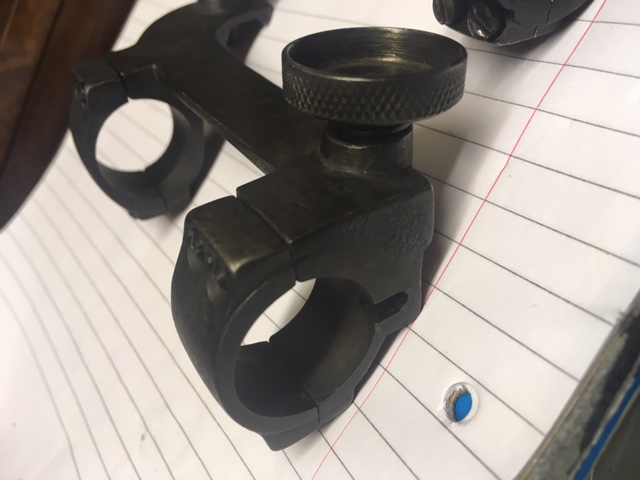

    The pictures were taken somewhat hurriedly with my phone, but hopefully you can see the minor but real differences in contour between the Rose Brothers & Dalgleish variants. They came out like that pretty much from the sand moulds.
    Photo 1 Dalgleish
    Photo 2 Rose Brothers. Note the minor flat on the top of the clamp.
