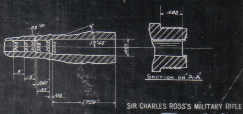

    Ross' version for the Mk.III Rifle, circa 1912/3
    "'E was warned agin' 'er, that's what made 'im look."
Name:	Ross Mk.III Chamber Drawing.jpg‎
