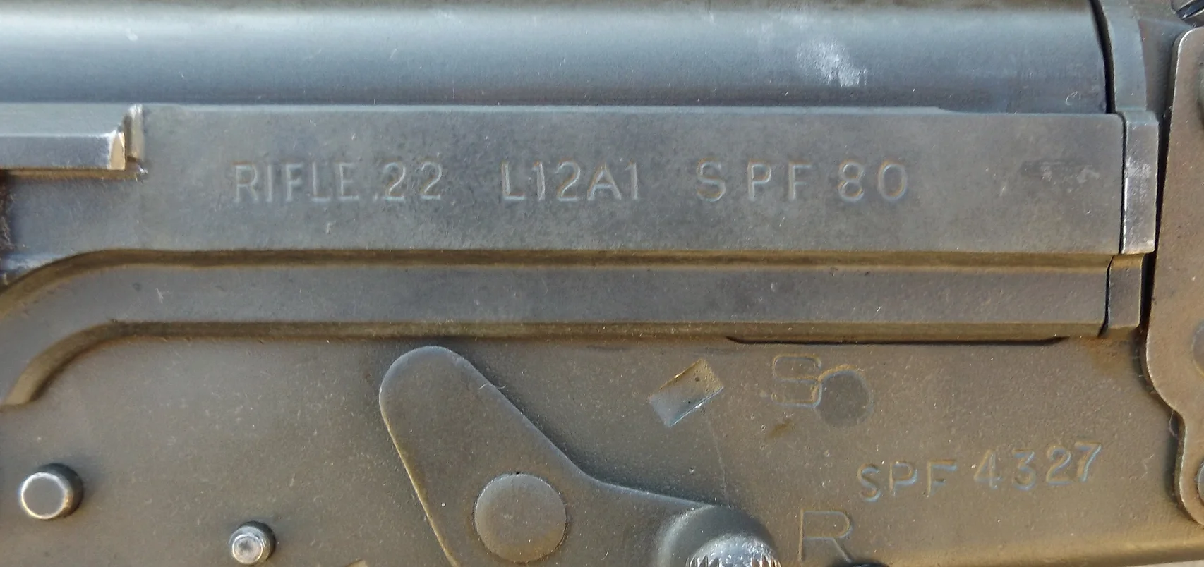

    Afternoon all,
    So, apparently a Singapore Police training rifle, Lithgowicon L1A1 marked on the left hand side L12A1 and apparently delivered as such....
    Obviously Britishicon plastic, with an 8 slot New Zealand pattern handguard (that I am still bloody searching for!!!)
    I like to pride myself as having a pretty well rounded knowledge of the L1A1 and this is news to me...
    https://www.enfieldguns.com/l12a1-22lr
    Opinions please Gents.....

    The seller has misunderstood something I fear.............
    The L12 designation was the designation of the sub calibre KIT and not the rifle. There was NEVER a designation of RIFLE, .22" L12. THAT L12 rifle designation WAS THE PRESERVE OF A SPECIALLY ADAPTED SHOTGUN. And what I see doesn't look much like a specially adapted shotgun..........! The L12 kit was KIT, conversion 0.22" calibre, L12A1 for 7.62mm rifle..
    That is only my view based on nothing more than my bit-part experience, the EMER, the parts list and the L12 user handbook.
    We did have rifles with the kit permanently fitted, caused by the .22" barrel bulging and jamming solid in the 7.62 bore. These were still on charge as a rifle but relegated to indoor training (or out door poaching on the training areas.....) but with a red band around the handguards and all unnecessary parts, such as gas parts and return springs stripped from them. When this occurred, the now .22" rifle was retained IF THE REQUIREMENT EXISTS and a new rifle issued as a replacement. Alas, when the L1A1's were called in for replacement by the L85, these .22" rifles seemed to languish in the backs of armouries or Armourers shops until someone decided what to do with them.

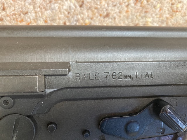

    When you look closely at the photo of the 'L12A1' I think you can make out some signs of apparent work to remove the original L1A1 designation. There are a couple of witness marks - a radius at the left end of the serial 'flat' and what looks like the sharp corner/edge of the end of the top of the charging handle slot has some rounding (although could be wear & tear?).
    I've got a mint ex-SPF Lithgowicon L1A1 and have had a quick look and it's not showing the same marks
    Photo of mine and the L12A1 to illustrate what I mean.

    ---------- Post added at 07:50 AM ---------- Previous post was at 07:48 AM ----------
    Quote Originally Posted by desperatedan View Post
    One would want to measure the thickness of the body side at that area for comparison.
