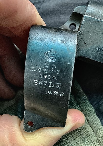

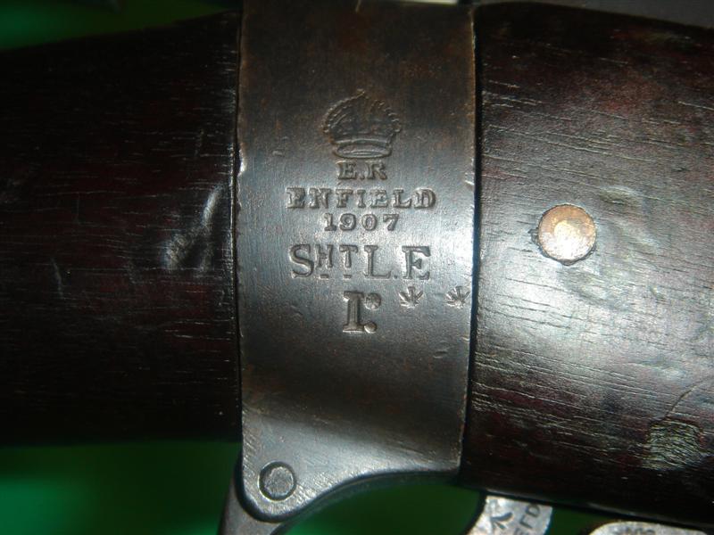

    Quote Originally Posted by BVZ24 View Post
    Lee Enfield No 1. Barrel
    Can we just clarify what barrel you are wanting as there is no such rifle as a No1 Mk1.
    Are you wanting a barrel for a No1 OR a (SHTLE) 1 barrel ?
    I'm thinking you are talking about a "SHTLE 1" barrel ?
Name:	SHTLE MK1 start star.jpg‎
ID:	134469   Click image for larger version
